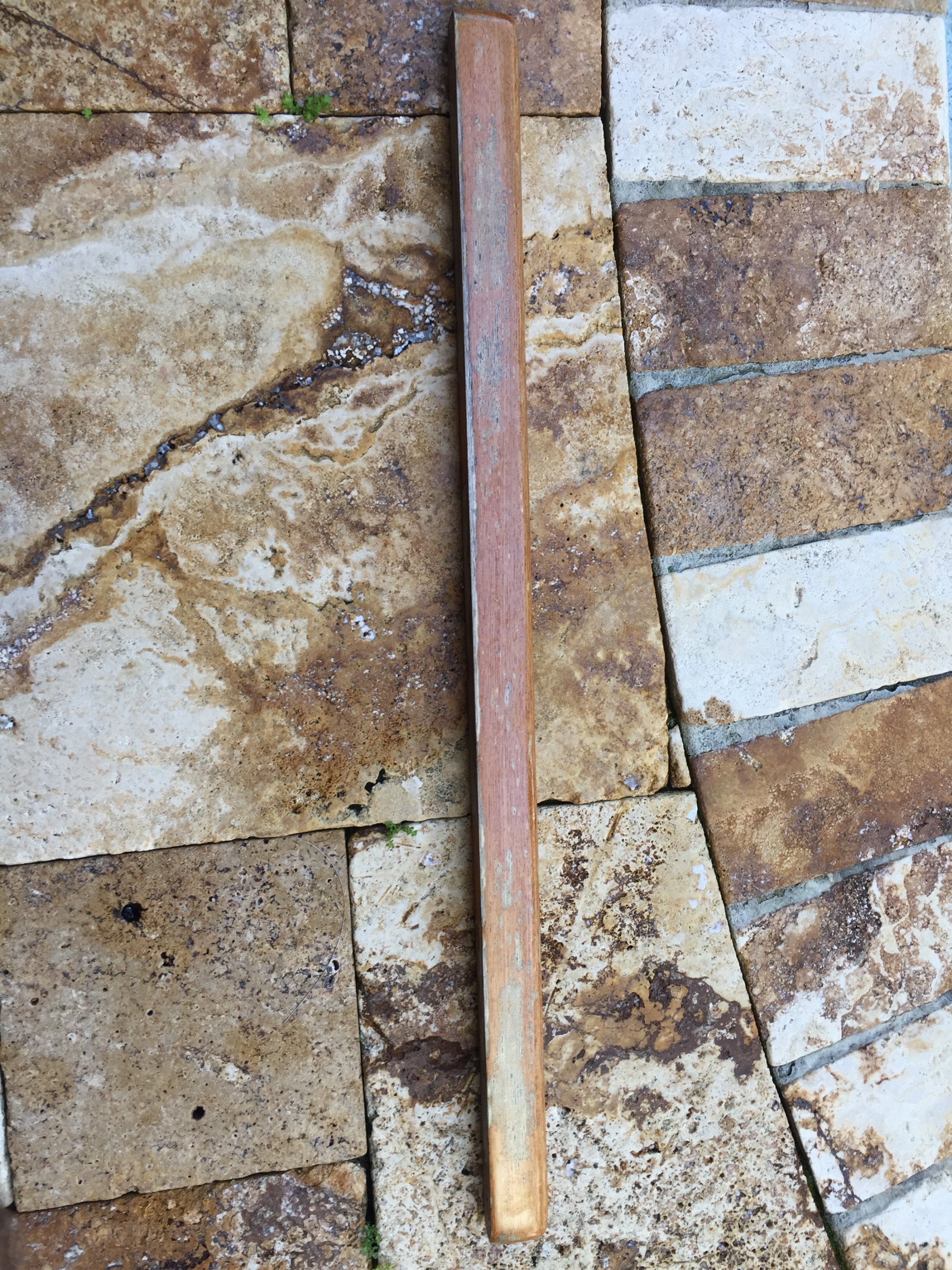

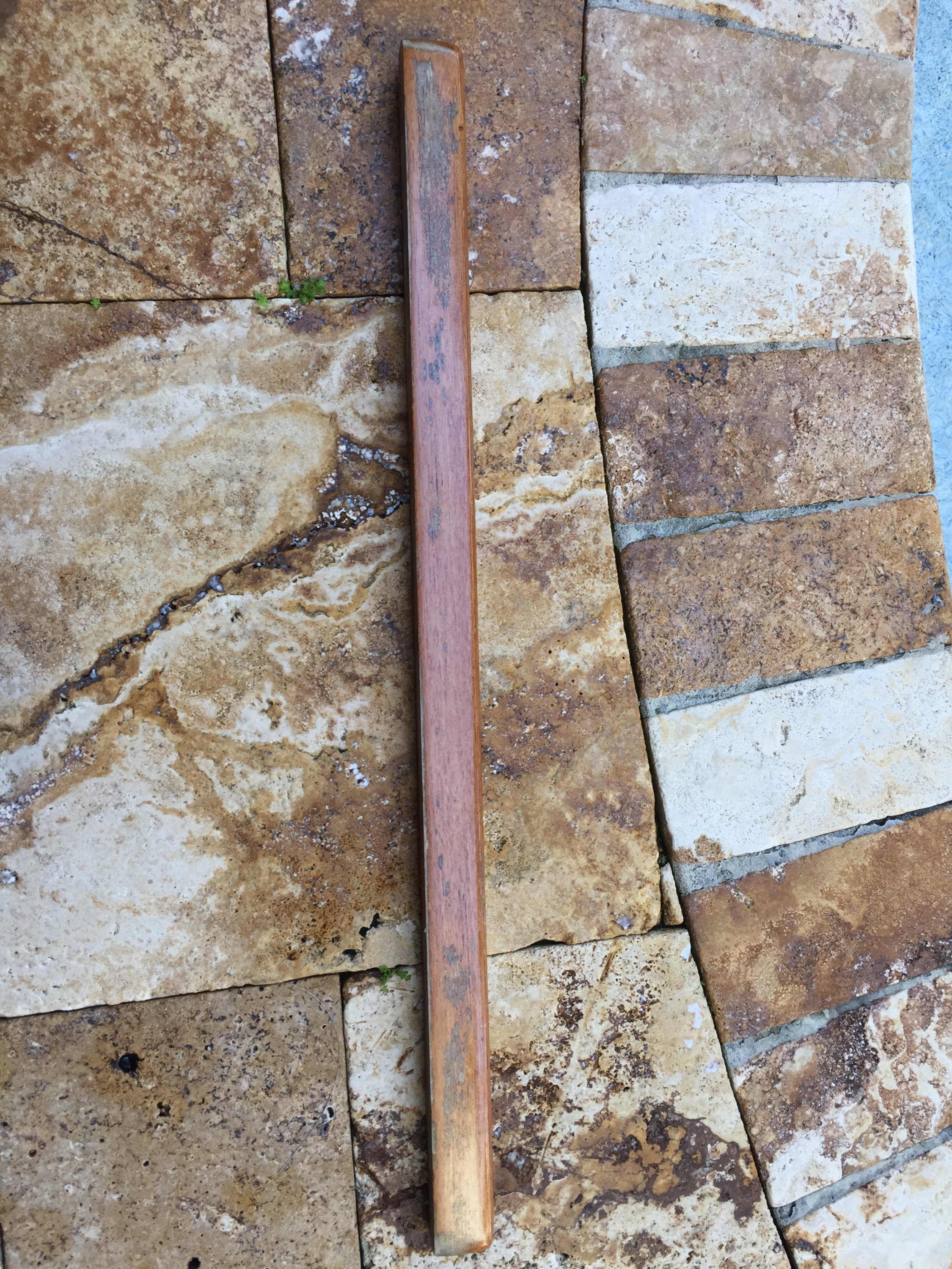

The attached is the teak pull from my companionway sliding horizontal component. When I noticed that it had a couple of discolored spots I sanded it down and sprayed it with about a dozen coats of Guardsman clear gloss indoor/outdoor spar urethane. After about six months in the Florida sun and heat it looks worse than before it was refinished.
I think one mistake I made was not refinishing the bottom of it. It gets screwed from beneath to the horizontal component. So I would assume that some rainwater and salt spray works its way between this component and the hatch board and then leaches upward between the wood and the finish?
I have sanded it down again and am thinking about varnish this time. I will include the underside this time. Opinions? Also recommendations for varnish brand and brush types, tips etc would be very welcome. Rich

Urethanes are not recommended for anything that will be in the direct sun. The urethane forms a plastic skin over the wood... which is great for waterproofing the wood but in the direct sun the wood underneath will sweat and the moister forms a bubble under the plastic skin. This will push the urethane off of the wood and cause it to flake. Urethane is okay for wood that will be mostly inside the boat or otherwise out of the sun. For things that will be exposed to direct sunlight, you want to use a varnish only.

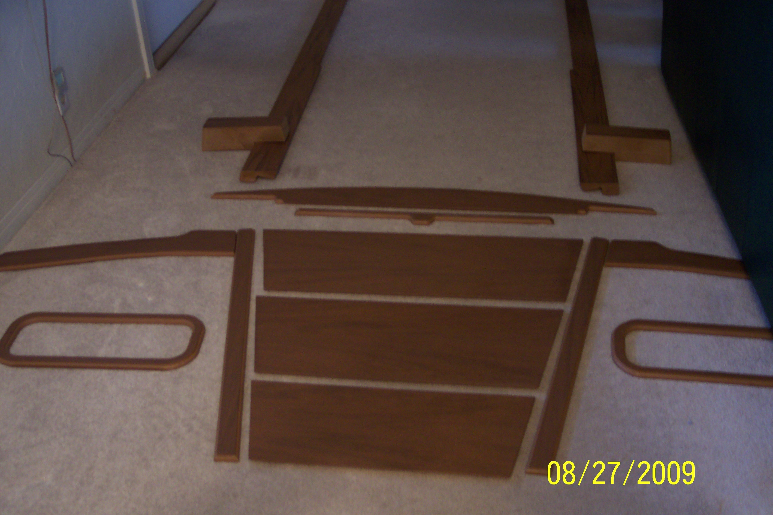

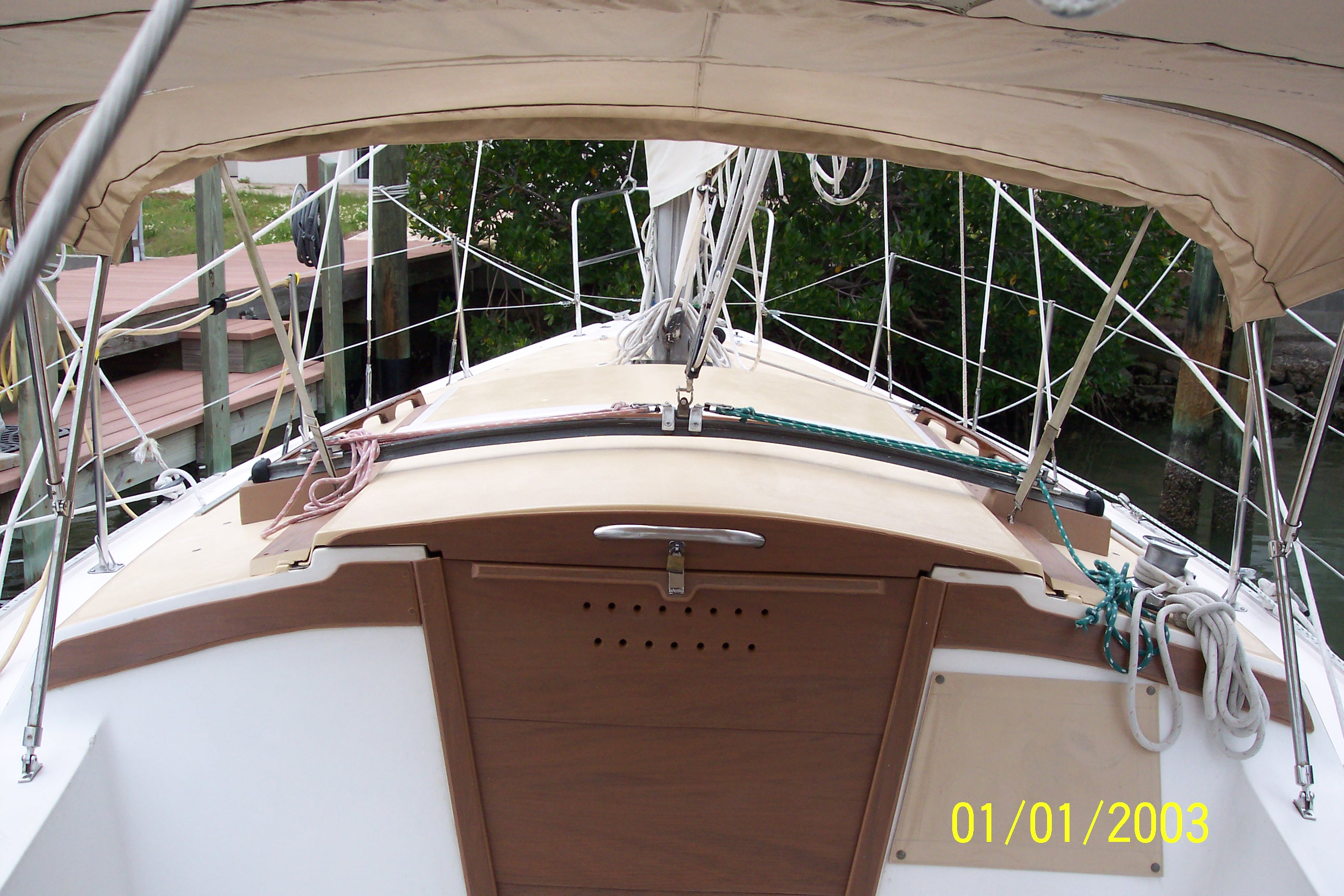

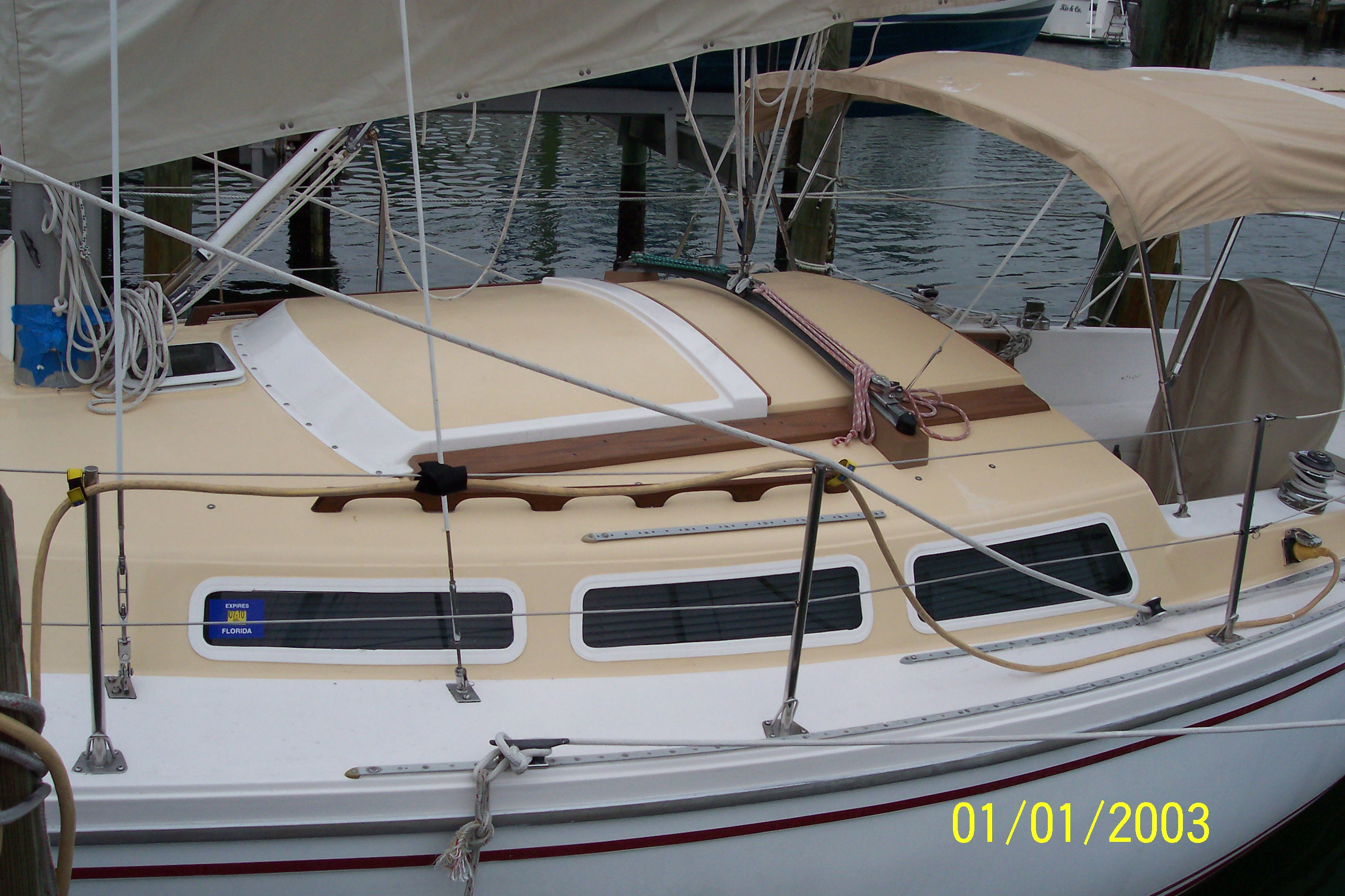

I went to synthetics a few years back. At that time I went with a decorative
deck & fascia board material. There is a good choice of manuf's. out there today
for color & wood-like textures. It was called Sensibuilt back then.
I changed out my deck wood except handrails. I matched-cut it all with a table saw & router.
Here's a few pics to give you an idea pal.
CR

What I am doing is West epoxy including attachment side followed by Epiphanes clear for UV protection. Sanding between coats, using boar bristle brush
