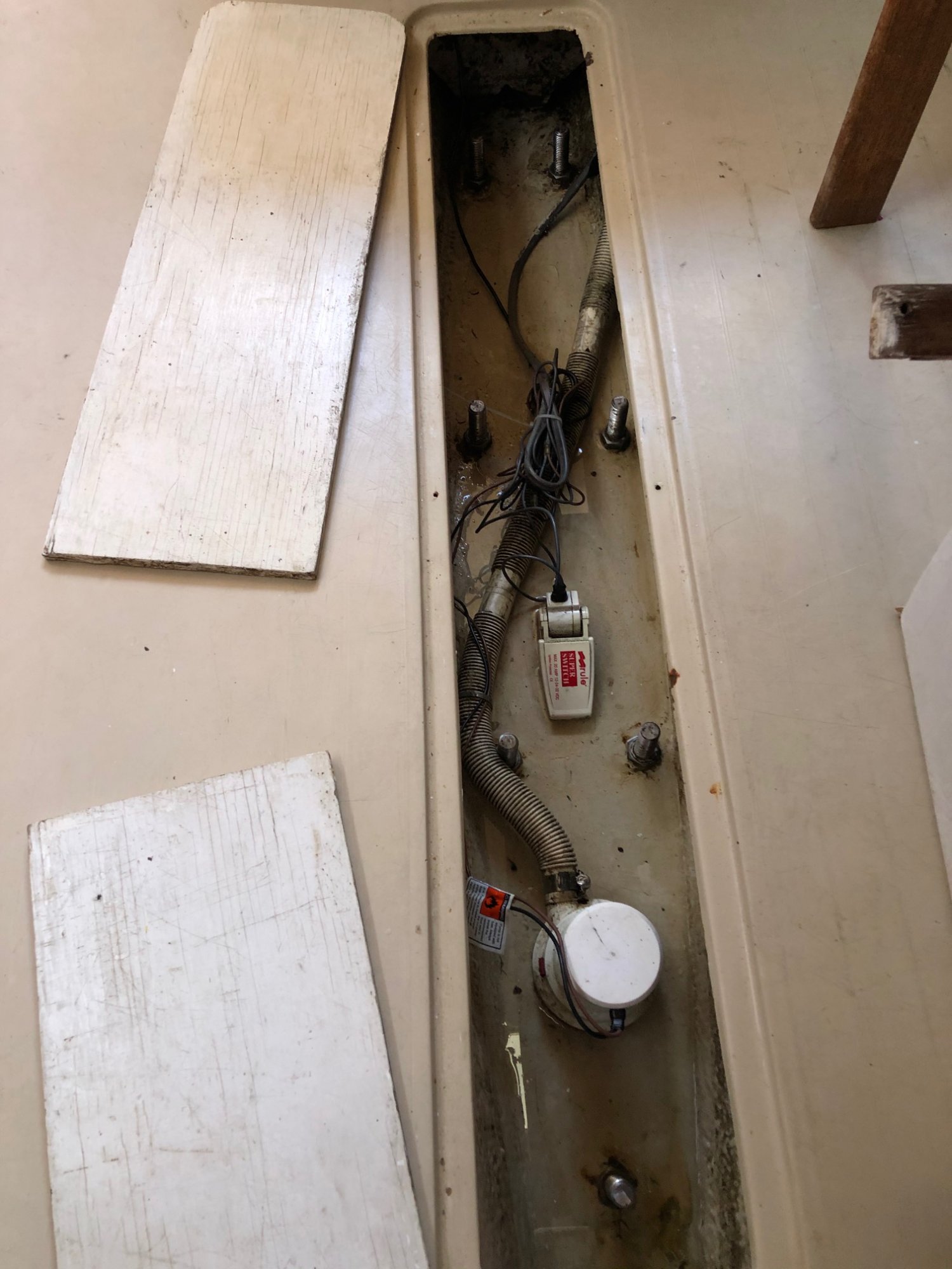

Thanks for the great feedback on this thread. I spoke with the seller again to get clarity on a few items. The leak in the bilge is coming from the dripless coupling and leaks about 1 drop every 5 seconds. He says whenever he does run the bilge pump to run it out, whatever water that is left in the hose drips back down into the bilge because it is below the waterline. I'm taking this to mean the bilge has been constantly wet for the last 5 years. See pic below which looks to be post purge.

The bilge looks clean and the keel bolts/nuts don't look excessively rusty so that's a plus.
I'm not familiar enough with dripless seals to know if the leak is something that can be easily corrected or if it a disaster waiting to happen. I'm sure someone else here will chime in in that.

Cool, that bilge won't bother me, the bolts look very long like replacement but I'm not a 30 owner. My 310 are maybe 2-3 threads above the nut.
I also doubt very much water accumulated from the dripless either, that rate sounds right but I'd want to see a manual for the manufacturer of it. There is probably some leaks in the deck penetrations, which is common on older boats. Again not a deal killer and if the cabin is dry and no water leaks on ports and bulkheads that is far more important to me.
