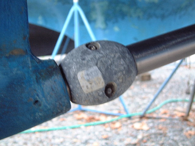

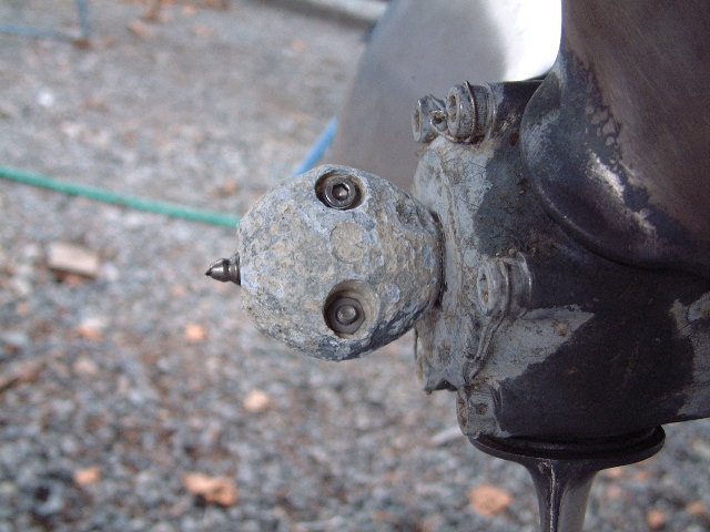

Everybody has an opinion, and I want yours. Pictured below are two zincs that I have on my shaft and AutoStream prop. I have always replaced both of them each year, but this year I note that the erosion on both of these is very light. Normally the zincs have much more metal gone.
So, I'm thinking that if the "guideline" for replacement is 40% gone, and these look like maybe 10% gone, maybe I don't need to replace this year. On each of these zincs, you can still read the manufacturer (Canadian Metals) and the part number. One even still has the small paper label attached.
I'm not cheap, well maybe just a little, but does it really make sense to replace a zinc that still appears to have a good deal of metal? BTW, for those of you who have an AutoStream prop and are thinking that the zinc on the prop looks really strange, I machined an adapter for the end of the prop so that I could install a standard $7 3/4" zinc instead of the $40 custom zinc. It works the same but looks strange. $33 stays in my pocket!
If you subscribe to the philosophy to change the zincs yearly no matter what, just qualify your answer accordingly. If you find that your zincs sometimes last more than a year, please let me know your experience.
BTW, I have two new zincs that I can install. I just don't think it is necessary at this point. If I am wrong, please tell me why.

Unless you suspect that you're in a "high stray current" area.....they look fine to me! Here in NY, these would easily last until my usual mid-summer prop de-fouling. This is when I usually change them out anyway.

For what zincs cost vs. shafts, props etc. I'd change them. I think I just paid about $6.00 for two Camp zincs at Hamilton Marine. As usual I could not get my preferred Godfrey zincs in time. Better planning next year, hopefully...:neutral: Keep in mind that they may not be worn because you may not have had good electrical contact.
The lack of erosion also looks indicative of an "isolated" shaft? With an isolated shaft, which goes against ABYC standards, and a SS prop and Aquamet shaft the zinc wear would be pretty minimal anyway as your electrical galvanic separation would be very low mV wise between the prop and shaft.
I clean the shaft side of all zincs before installation with wet sand paper. This removes any surface oxidation and preps them for good electrical contact to the shaft. I find this prep work causes them to wear more evenly. I also clean the shaft with wet sand paper to also get good electrical contact. Most people clean the shaft but never think to clean a new zinc. I then install them and give them a light tap with a brass or phenolic hammer to "set" them.
The zincs will also get a layer of oxide between the shaft & zinc after a haul re-launch making the electrical contact even more suspect. For the cost it would be a no brainer for me....

Just out of curiosity, is the zinc in the OP picture too close to the strut? Could it possibly restrict water flow through the bearing? And now that my 56k is churning is there a standard for the distance between the zinc and the strut?

Did you change anything electrically last year that could have minimized the erosion of the zinc?
I ask this because I installed a galvonic isolator last winter and have found that my shaft zinc showed little erosion as well. I'm going to leave the old one on and install an additional new one for security. I normally only install one shaft zinc but they used to be gone or close to gone by the end of the season before the isolater install.
Looking at yours, of you have good contact, I think I'd change the prop one, leave the other. I'd also check on it during the season. But then again, they are cheap insurance.

I clean the shaft areas each year with a plumbers sandpaper tape (dry) and they are clean. I have never cleaned the inside of the zincs but they are always bright and shiney. The zincs that I have used for the last several years (NOT JUST LAST YEAR) are the type without a copper ball inside. The manufacturer's claim is that they are precision machined for a tight fit and that the copper ball is not required nor is it necessary to hit the zinc with a hammer to create a "better" contact. I have never noticed any difference between the copper ball type and the ball-less type in terms of erosion over a six month season.
Nothing has changed this past year of which I am aware. My boat lives on a mooring well out in the harbor away from shore power sources- but this is nothing new either. The shaft and the prop are both a flavor of stainless steel, so I don't expect a lot of erosion on the zincs, but this past year the erosion has been less than "normal".
In past years I have had more erosion than during the last year. I cannot explain why this happened.
If I measure the electrical resistance between the zinc and the shaft and find that it is as close to zero as just the meter leads, does anyone think that is sufficient to indicate good connection to the shaft? If I remove the zinc I wonder if I could re-install it with a quality connection?
I have not observed any derogation of the shaft or prop due to a poor zinc connection, so I tend to believe that the zincs are connected well right now.

Put an ohmmeter on it, one lead to the shafts and one lead to the zinc and ring it out to check continuity.

Zincs are supposed to be sacrificial from the picture your Zincs havent been sacrificed

These can be much further along the electrolosis trail than they appear and I have personally seen them removed where they look very good on the shaft, but are virtually hollow on the inside...if you are going to use them, take them off and inspect them thoroughly.

I have no galvanic isolator and the shaft is connected to ship's ground through the transmission coupler only. I have never had really badly eroded zincs, but these are light by any measure.
I am thinking that I will verify the lowest possible conductivity between the shaft zinc and the shaft itself and I will replace the one zinc on the prop. I'll try to take a look part-way through the season and see what I have at that point.

If the old shaft zinc looks to still have some life left in it I just put a new one alongside it - though I never have more than two. Normally by the following season's lift out the original one has disappeared.
In your case the erosion is so slight that I question whether it is actually bonded to the shaft so I would remove it and clean up both shaft and inside of the zinc with wet & dry and put it back on - together with the new one you just bought anyway.
