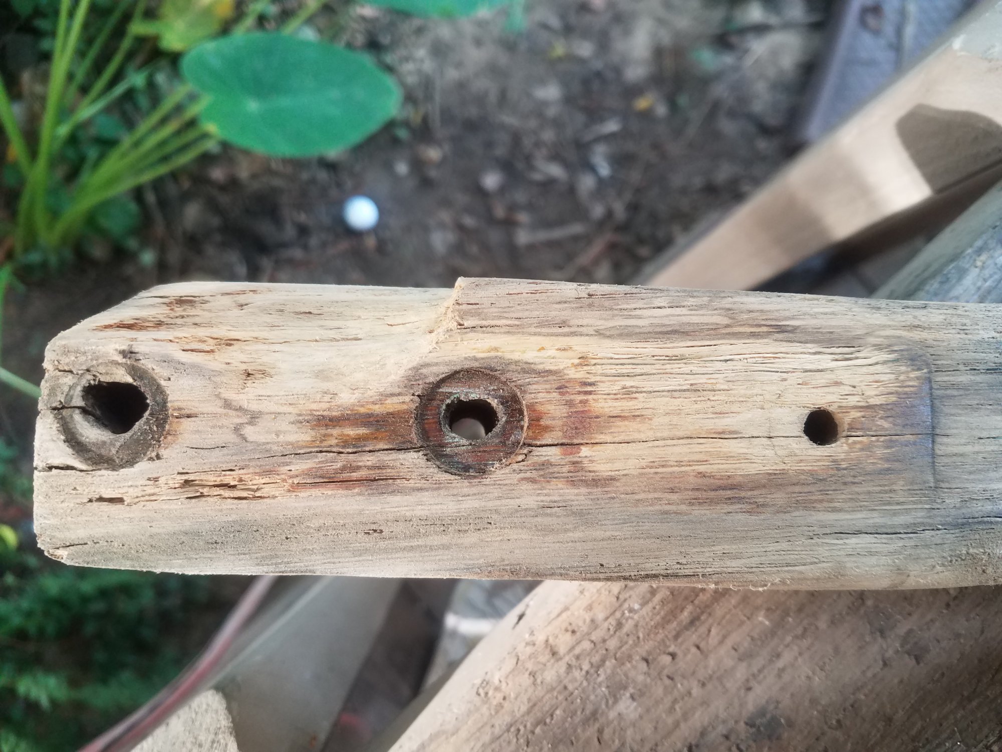

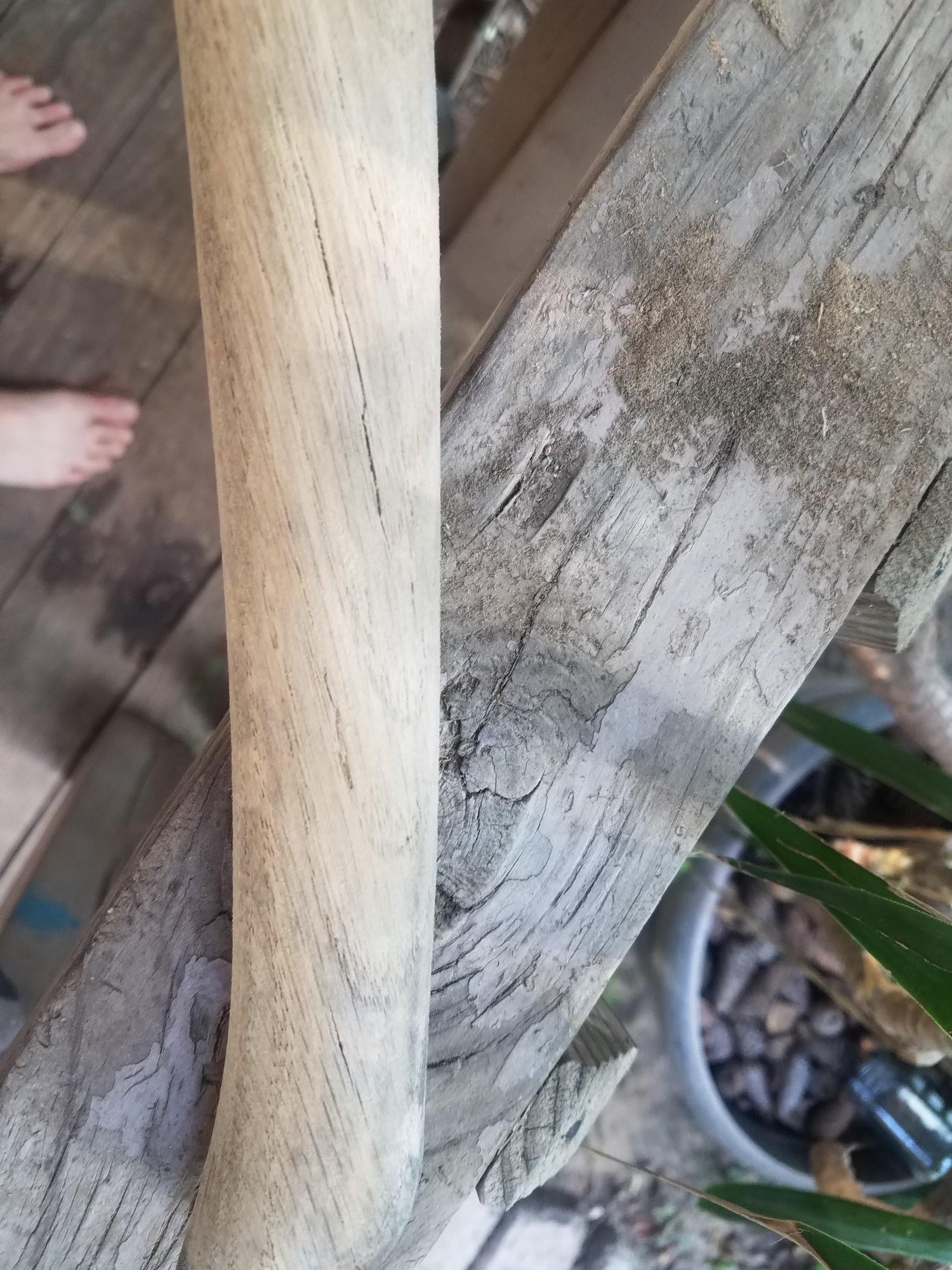

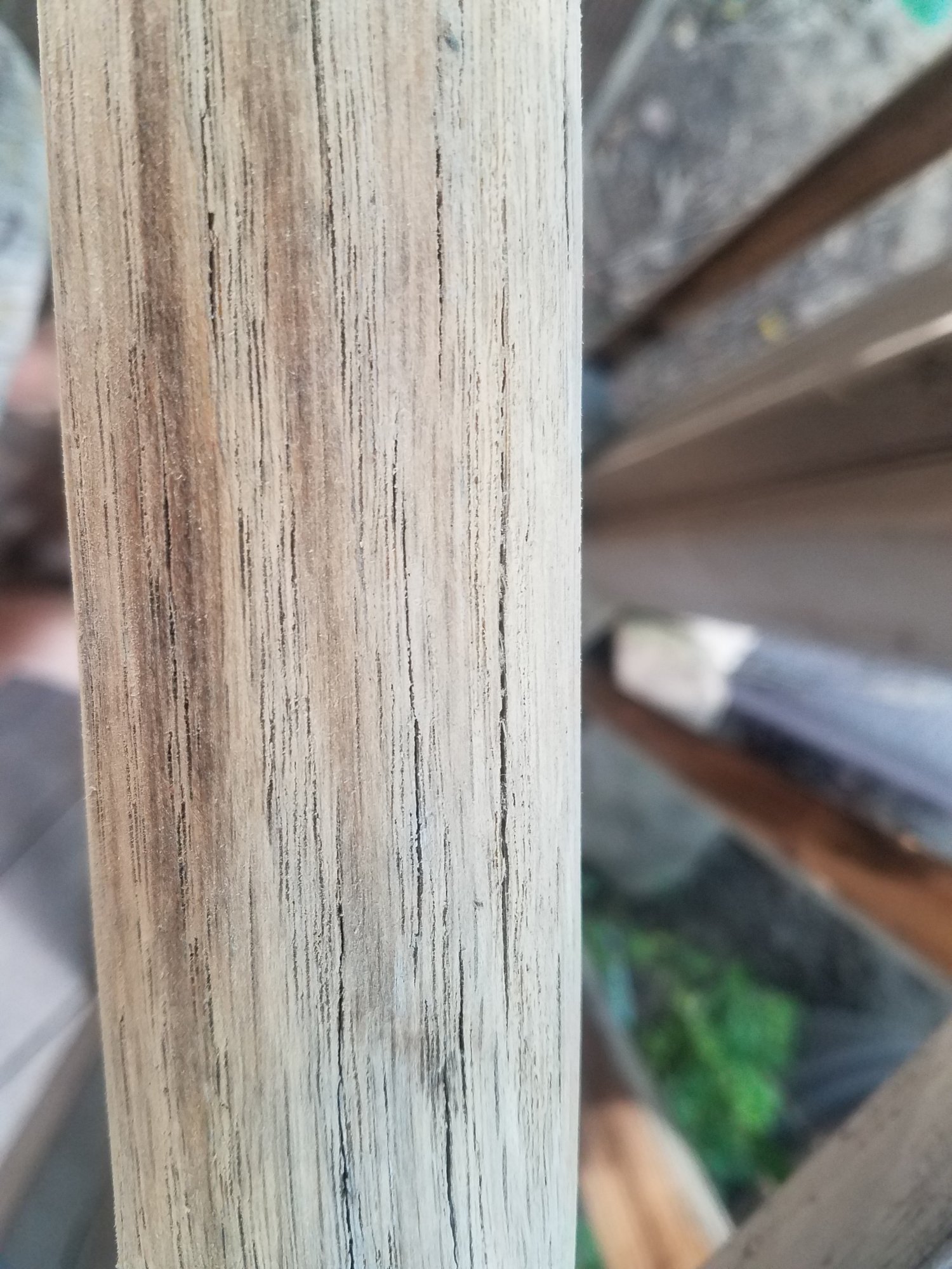

I was hoping to restore my old tiller. Watched numerous videos but after sanding I have cracks and a part that feels like drift wood. I do tend to underestimate wood's strength but I rather not have a tiller snap in half.
They do have a product on the market called penetrating epoxy that could possibly help me pull this off. Curious what the salty sailors know.

Don't take any chances and replace it now. You never know when you are going to get caught in bad weather and the extra pressure on that tiller will be what it may cause to crack it right at the worst moment leaving you without steering. Once we had to baby a creaking tiller home under small craft warnings conditions for a tense 3 hours crossing. Three days later in calm waters the tiller broke. I'm certain the 22' boat would have capsized under the gusting 25 knots wind and 5 to 6 feet waves. That tiller had cracked 2 years earlier and had been repaired.

Looks a lot like mine when I replaced with a laminated one from IdaSailor.
I don't think the epoxy products restore the structural strength that you need in a rudder
edit: tiller, not rudder :(

Agree with replacing it immediately. If you want to restore it, put it on a wall after you get it looking pretty again. I had a tiller delaminate while sailing on a Catalina 27, at which point we immediately ended the sail and motored home. Its too important of an item to have any hint of an issue. Also, I recommend a spare tiller - we always had a shortie with us that we used when cruising with the tillerpilot on for long periods, which gave us more cockpit space. It was always a handy backup if needed, but with substantially less leverage than the longer standard tiller.
8,081
That looks like White Oak which is prone to cracking like that - I think from drying. You’ll never sand them out. Since the force of steering is favorable with the grain of the wood it might be OK. It can still have structural strength. But you’d probably be happier with a nicely laminated and finished new one.

Go sail without your tiller and see if your comfortable without one, because fixing that ole tiller is what you'll be doing in your future sailing.

Here's a close up. the phrase that comes to mind when i look at this is "rotten to the core."

yeah, that's junk. wall hanger, nothing more.
Its a fire poker now. The good peeps here led me to greener, newer, tiller pastures. She's pretty but at 5 months old Im already seeing a haze and I have had a cover on her. Too old of a cover or did I varnish wrong?
