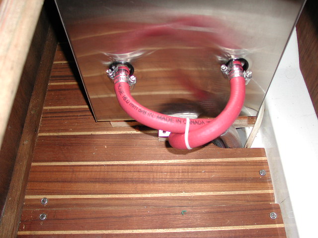

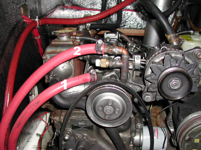

I totally agree with Jackdaw. As for bypassing the heater you have two options and neither needs a valve (see pics)
Either you disconnect in and out hoses at the heater and connect them together thus creating a loop, or you disconnect the 2 hoses at the engines (configuration on yours may vary) and install a short bypass from the inlet to the outlet. That is the preferred way !
No valves needed but make sure you empty the coolant from the now unused hoses, and make sure that you empty the heater tank of all water.
You will also need to disconnect the cold water line from the tank and connect it to the hot water. No other changes needed. Again no valve needed. The only result will be cold water coming out of the hot water spigot. And once that done and tank empty, no need to winterize the tank.
Good luck
