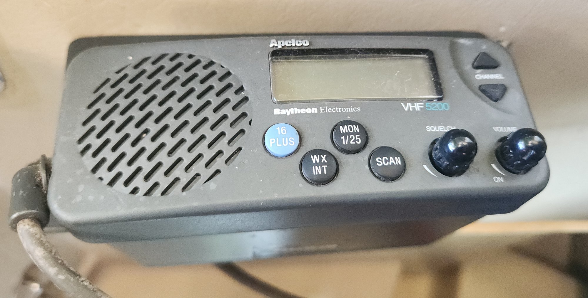

I'll be sailing on the Hudson River, maybe someday in a bay, harbor, or sound. I'm currently rewiring. Should I take the time to get this Apelco VHF 5200 wired up or in 2026 should I have a different radio?

Current VHF radios have DSC and many have GPS included. The big advantage to these radios is the "Panic Button." In an emergency, one press of the button sends out an emergency broadcast that all DSC enabled VHF radios will receive and more importantly, the USCG will receive it. If GPS enabled, the broadcast will include the Boat's name and position, allowing for a faster response by the CG and any other boat nearby. Likewise, it enables you to hear and respond to someone else's call for help. This feature alone makes a new VHF worth its price.
The emergency broadcast is sent as a data packet, not an analog voice message. Data transmissions are less subject to interference and can have a greater range than an analog or voice transmission.

Regarding the radio, it is capable, simple, and rugged mid-1990s fixed VHF that if functioning can still work for basic communications and weather monitoring if it is in good condition.
Your boat is new to you. You will be discovering a million different things about the boat. If the radio powers up, “with the antenna connected” (required before you try to key the mike and call someone- if not connected you can burn up the internal parts), and can make/receive calls it will be a good piece of gear to have during this time of discovery. It is proper seamanship to be able to call for help if something goes wrong while you’re on the water.
Your plan to rewire the boat should include a connection for a radio. This one can work till you get that Christmas bonus. There will be plenty of opportunities to empty your wallet on fancy stuff.

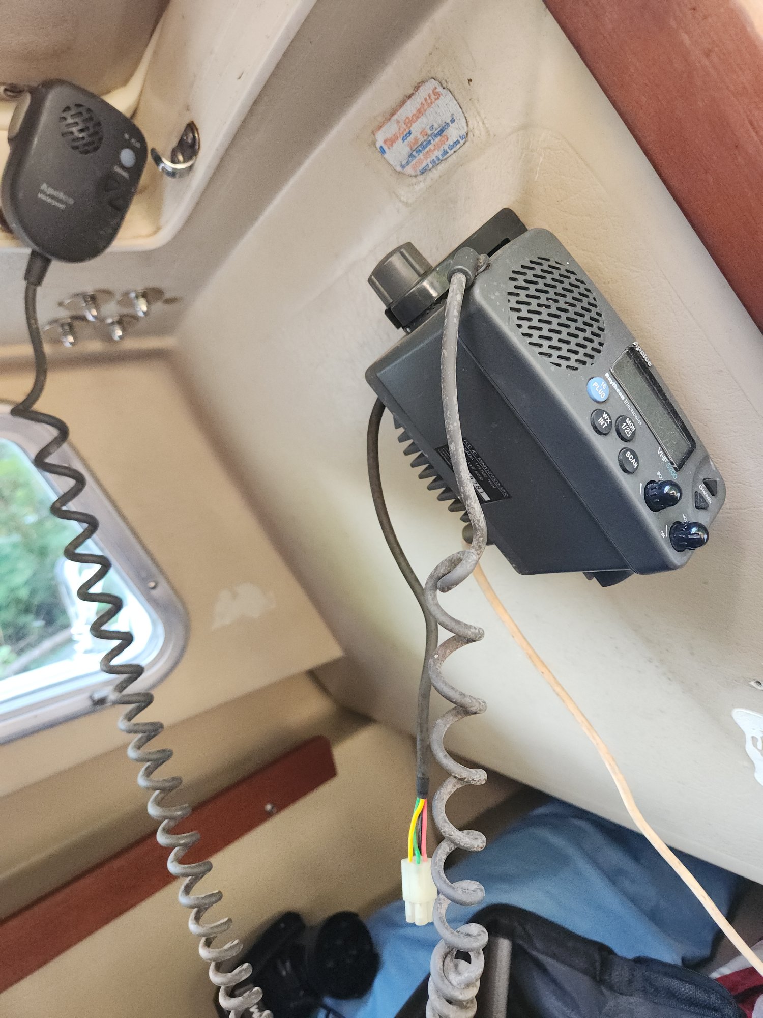

Thank you JSSAILEM! This current radio has a 4 -prong power connection. I take your advice to heart, but also don't want to take the time to wire this radio if I plan on replacing it. I'm going to get onto ebay and see if I can find a gps/dsc enable radio with a more rational power connection.
14,128
Most modern VHF radios have a simple 2 wire power connection. Nothing particularly difficult about installing them.
The most challenging part of a VHF radio installation is the installing the coax connector on the antenna wire.
24,696
The 4 prong plug has 2 wires ( red and black) that are power to the radio. The other two wires go to the external speaker.
If you want to have a speaker in the cockpit you’ll have 4 wires for all radios. If you prefer to use the speaker attached in the radio then just wire the red to positive and the black to negative. On your wiring system.
