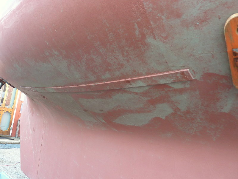

Below is a plan I came up with after reading Calder's book and several lightning/bonding threads and I'd like some input/feedback.
Page 233 of Calders book has a diagram where all the negatives/grounds/bonds (incl. lightning) go to a grounding bus, which is then connected to an "immersed ground plate or strip".
However, another paragraph describes a separate lightning grounding system with external plate and no connection to common ground bus
A. separate grounding system for lightning ground; cables straight/short as possible
B. AC ground, DC negative, & bonding terminate at common ground, which has its own immersed plate
External lightning ground strip (1/4" x 1.5" x ~120", I'm in brackish water)
Through bolted about every 2 or 3 feet, wherever I can reach and get to if hole forms
I have an isolation transformer
1. mast (2/0 wire), shrouds, stays connected (biggest I can manage up to 2/0) as straight as possible to external grounding strip through bolts.
2. Aluminum fuel tank (and deck fill) & all underwater metal fitting (including prop strut) daisy chained to each other, then connected to common ground with 8 awg
3. Large on-deck metal fittings, pulpits, stanchions, anchor roller daisy chained, then connected to lightning ground strip with 4 awg
4. No other connections to the lightning grounding strip, which begins fwd of mast, ends about 10' aft under galley.
5. DC negative terminates at negative bus
6. AC ground (not neutral) terminates at AC ground bus
7. Common ground point, engine or its own immersed copper plate?
-- Questions --
What do I use for common ground for AC ground and DC negative: engine or separate, external copper bar, like with the lightning ground, but smaller?
Engine has transmission, v drive, then out to prop
The engine is freshwater cooled with raw water heat exhanger. Is there enough electrical contact in the cooling water system and the gears of the transmission and V drive use it for the common ground?
Is the engine raw water intake metal thruhull electrically connected to the engine because the hoses are filled with seawater?
What if water gets brackish? There would be no connection, if it was marginal to begin with. the water here can be salt, brackish, and sometimes sweet, if we've had a long run of rainfall.
It seems that the more I reread Calder's book, the more I think using the engine/propshaft is not as good as a grounding plate outside the hull, esp. if I install a flexible coupling/drive saver.
Is there any reason to connect the common ground to the lightning ground strip instead of its own ground plate (or engine/prop shaft)?
Do I install a zinc to the external lightning ground strip?
Thanks for the input.
