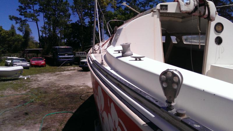

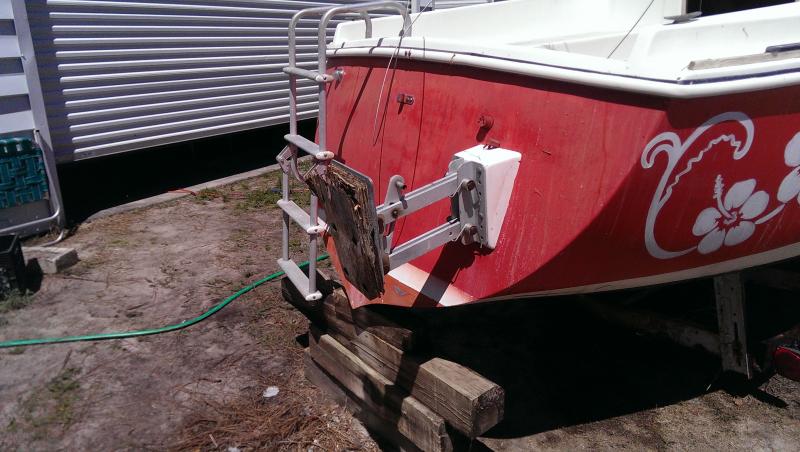

I Have the opportunity to get this boat at what i would consider a great deal at $700.00. These are the pictures i took yesterday after a walk around. Has sails has what seems to be all its parts. The boat has been sitting for a couple of years.
Any help would be appreciated my dad has said that ODay is the best boat for starting out. I have very limited sailing experience but my dream is to have a weekender i can enjoy with my wife. I just dont want to have to throw thousands into this boat after the purchase.

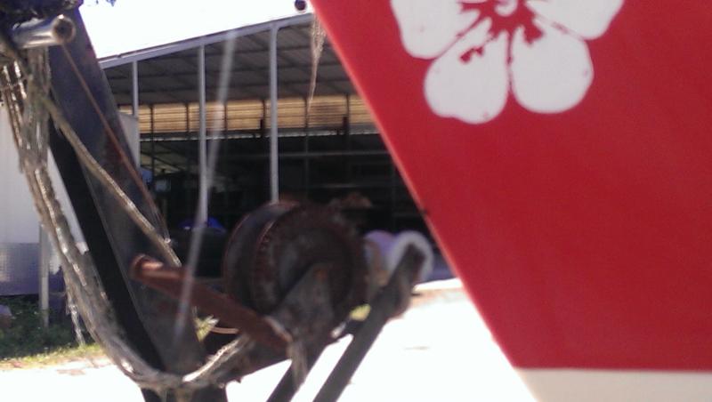

Has title and trailer is janky but useable. I did not notice any blistering/pox or softspots. I did not get up on the mast step at all but plan to do that before i purchase.

I just attached the pictures to the post just in case the link didnt work you may be able to refresh and see them.
My budget is around 3k so if i can get the boat for $700 and fix up for less than that it would be great.

Trailer just needs a few items its just got some surface rust and looks bad. But functional other than that and road worthy.

That boat looks like a lot of work ... do you want to sail or spend most of your time preparing to sail? The mast looks like it either has a bad paint job that is failing or the aluminum looks very pitted. It's hard to tell from a photo. It looks like the motor mount is rotted, but is the stern solid where it is attached? Can't tell anything about the sails, does it come with sails?
If I had a budget of $3,000 for a boat similar to that one, I would look for something that is in very good condition and you could own it and sail it immediately without needing to spend much or anything except for personal items.
You can probably find something much better for $3,000. It looks like you would need to spend far more than $2,300 just in equipment and hardware to bring this boat to the condition that would equal what you could find for $3,000. Then estimate the hours in labor that you would have to invest (and then triple that because your estimate won't be reality). How much is your time worth? Don't forget to add that in the equation.
Don't buy this boat without doing some comparison shopping. It's not a good time to be impatient.

Does this come with a motor? You will need to factor that in since a reliable motor can cost you $500 - $1500 depending on what you settle on.
Check the motor mount and make sure that it is in good shape. I would take a good look at the screws that connect the motor mount to the wedge. The wood will obviously have to be replaced on the mount but that's easy to do.

What condition is the mast and boom in? It looks a little rough. Make sure that you don't see stress cracks anywhere on that. The last thing you want is to lose the rig in a blow.
Same point on the standing rigging. What does the standing rigging look like? Any evidence of cracks at the swage fittings? Any loose wires? Any rust? What about the lifelines? These can all be replaced but it can be costly.
Have the bearings been repacked on the trailer? Surface rust is not a problem, but having the bearings seize up is a bigger problem.

Thank you for the info. It does not have a motor and the mount was solid when I tried to move it. I have to look over the boat more thoroughly this afternoon before I buy. The hull appears to be in good shape as well as the cockpit I did not completely walk around the boatdeck yesterday but plan on checking for soft spots blistering etc. today.

If you're going to dig further, three spots to check with all Odays:
Chainplates and bulkheads. If you have dampness on the bulkhead where the shrouds pass through the deck, you absolutely must make sure the bulkheads are not soft. Otherwise, you risk demasting. If they are soft, you will need to replace the bulkheads. Not hugely difficult, but it is very important.
Cockpit drain. Less of an issue than the previous, but notorious. Pour water into the cockpit and look underneath the cockpit to see if it's leaking. Not a hard fix, unless you're a big guy. Getting down in there under the cockpit floor is tough.
Mast step. Walk around it. Is it mushy, depressed? Kind of a pain in the butt to fix- not difficult, but time consuming.
As for the mast- ODay had gold anodized masts. It's not a defect.
As for the boat- the old 22s don't point as high as the 222s, but it's still fine for a learner boat. But don't fall in love with it if you see a money pit and a time killer.
