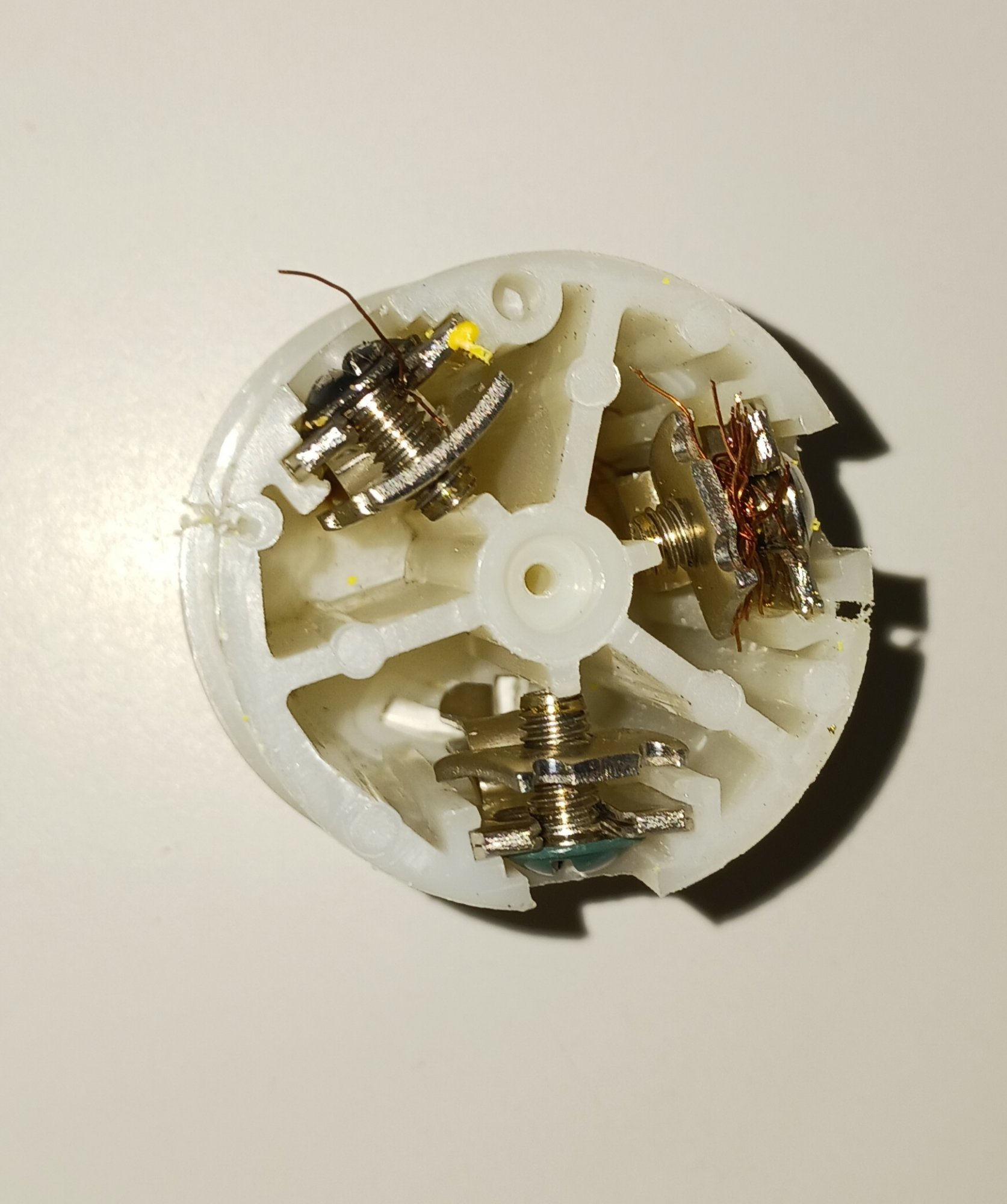

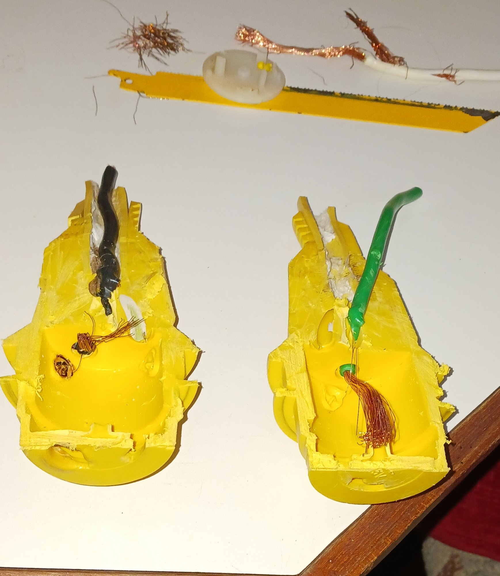

The screw terminals were loose inside the molded female end!
For what these things cost and how cheaply the terminals are made make your own decisions....
Pictures show you what is underneath the molded plastic, three simple screw clamps that you would see on something like a lamp fixture!
Not lugs that are made for cable!

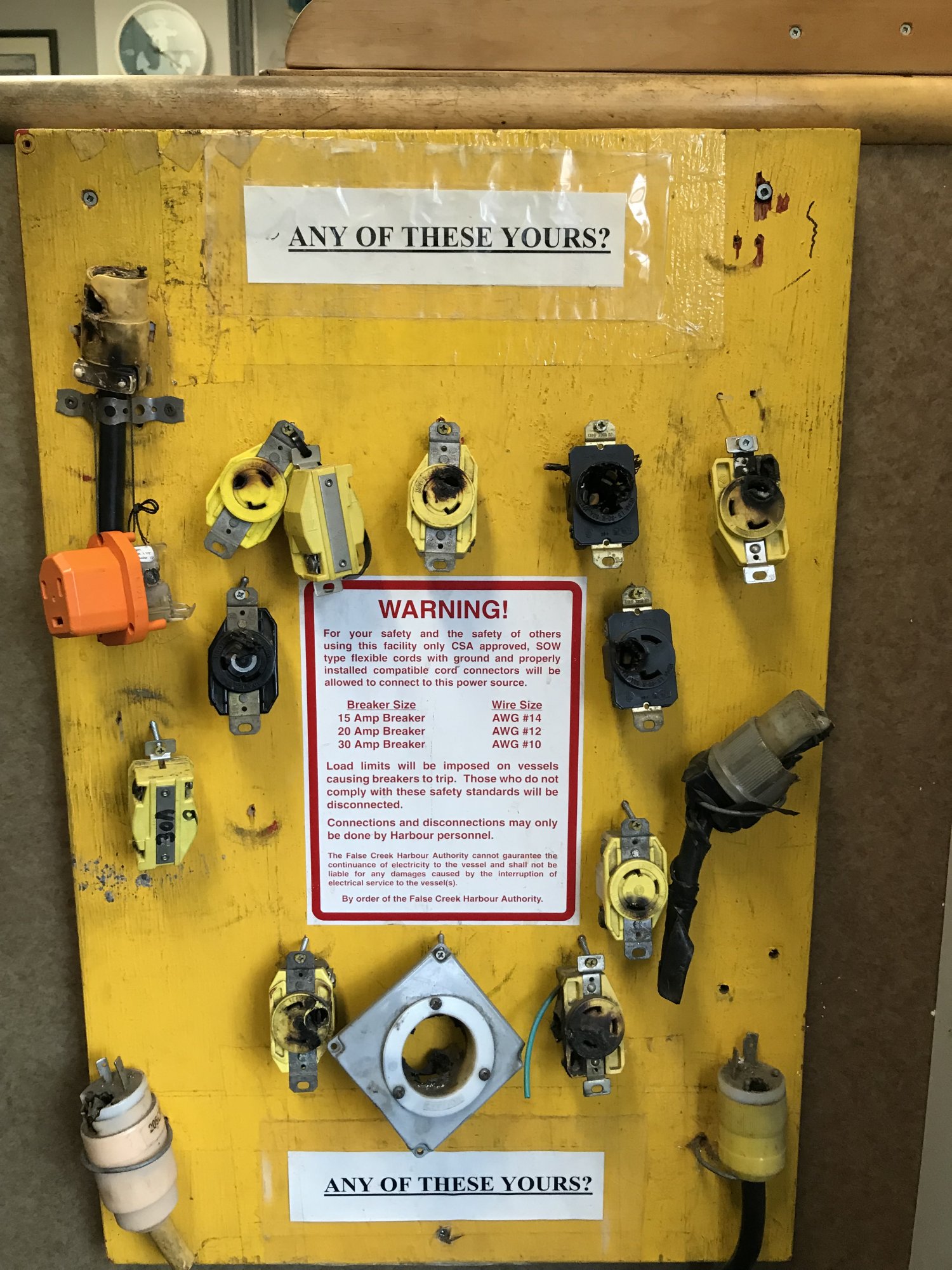

We visited the marina in Vancouver BC February 10 2019. .
They have a board of Shame. What happens to bad cords.

My marina has a table of shame just like that.
I am curious what happened to the Smart Plug on that board. No scorch marks on the outside where they often form on traditional plugs from bad connections. It looks like it’s a retrofit plug and there was a bad connection on one of the terminals.
someone made an adapter and the adapter end is what melted..

Both Hubbell and Marinco have individual ends available. It would be good to know why it blew as you want to fix that before attaching the cord again.
Feb 26, 2009
716
Oday 30 Anchor Yacht Club, Bristol PA
The knock off female end is actually more rugged than the original marinco, why it failed, my only guess is one of the prongs was bent internally I'll blame the previous owner fortunately, I'm in a habit of putting my hands on the outlets to check for warmth or heat which is a clear signal something is amiss
I wonder if the actual trend is the lack of locking rings, and by extension, strain relief? The few cords that are burnt are 100% lacking. I bet lunch >85% of the others were lacking locking rings. They either break or are simply not used. Or people just let the cord hang.
With the Smart plug the locking is more inherent (moron proof).
