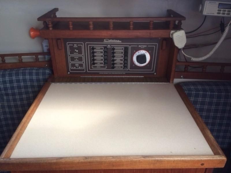

Thanks for the great replies. I will definitely start flipping the breakers on the dock before unplugging. Several of you mentioned flipping the breaker on the boat too.....where is that at?

24,775
Joe. You should have two breaker boards. One for AC. And one for DC. There should be a "master breaker". It turns the AC systems in the boat off. Should look something like this. Switch on upper left. AC Breaker.
