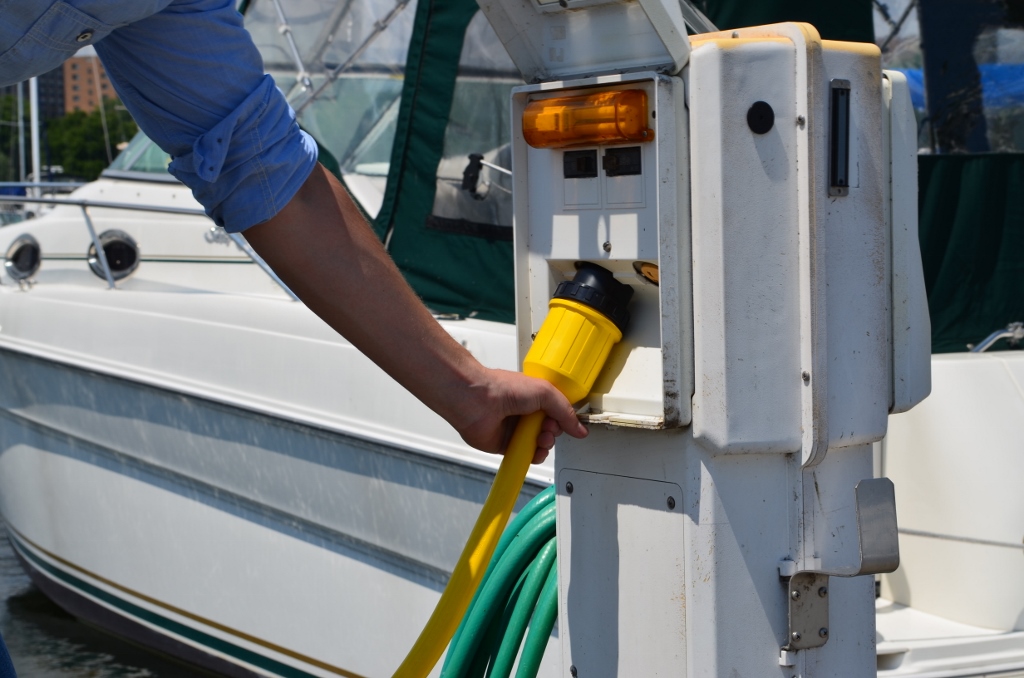

Do you have something like this on your dock?
I am assuming that one end of your power cord was plugged in to the pedestal, and the other end went in the water?
First, it is always proper to turn off the breaker at the pedestal before disconnecting the female plug from the boat, for exactly this reason….I dropped mine the other day, but I had already turned it off at the pedestal, so no real harm.
Second, did you check the pedestal to see if it is blinking red or if the breaker inside has tripped (that is what I would suspect if you hadn’t turned it off first).
Third, unlikely probably, but you could have tripped something inside the boat (a breaker) either at your electrical panel, or a breaker close to the shore power inlet (if your boat is equipped with one). If your Hunter 33 is a newer one (2005 for example), it probably has one. My 1998 Hunter 280 had one.
If this isn’t the scenario, then you will need to send some photos.
