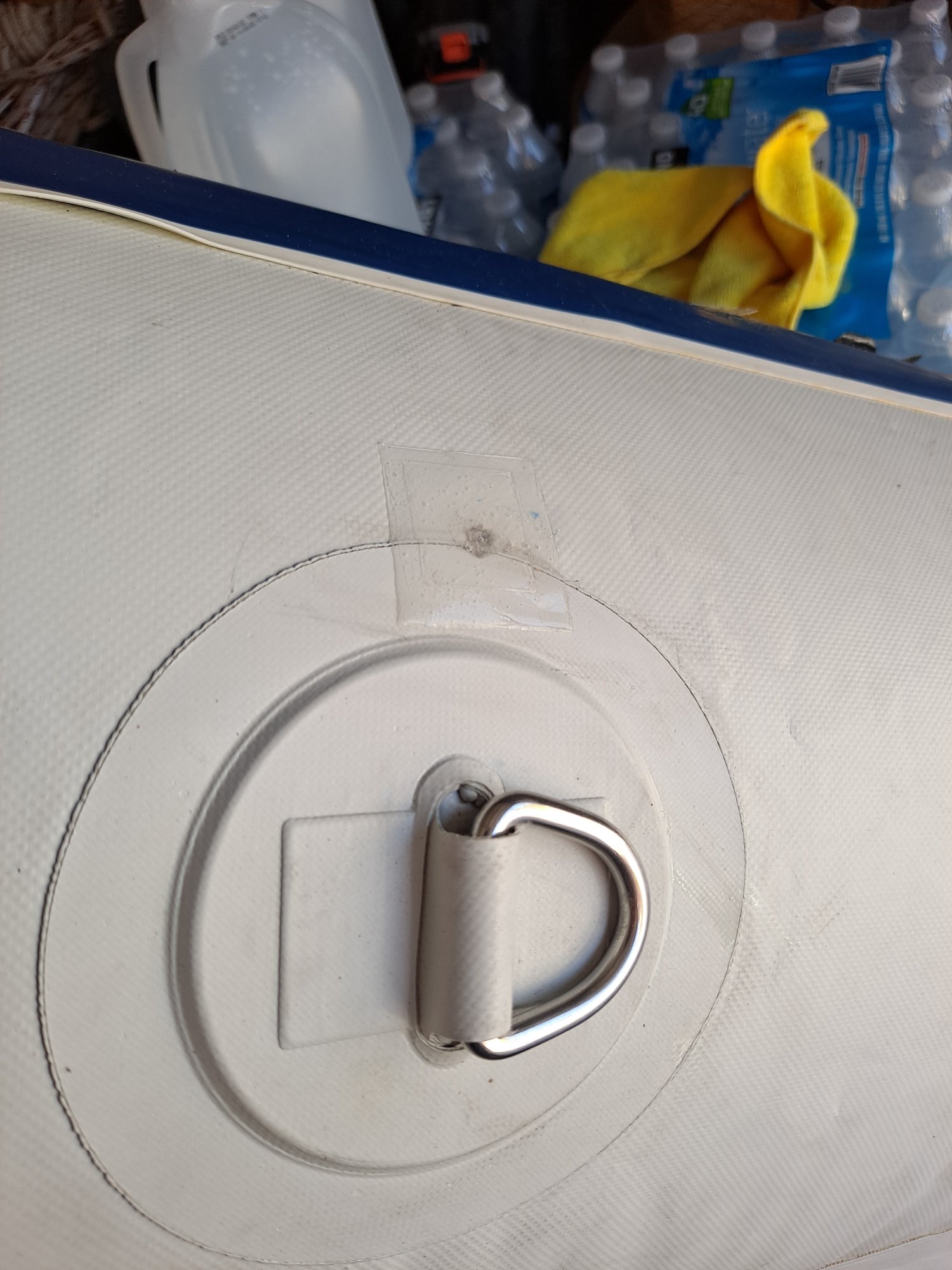

Now, some how I found a hole in the starboard pontoon near a tie-down ring. My repair kit had a tube of glue, but it had turned to a very think gel and was unusable. So I ordered a tube of Weaver 1-Part PVC Glue and will make the repair finale when I get it.
But... has anyone ever tried Shoe Goo to do repairs on anything that needs to hold air? I did the repair this morning around 7:30 and I put air in the pontoon around 10:30. Still holding but I do not know if my pontoon is to the recommended pressure. My pump pressure gauge is faulty (just ordered a new one).

Your hole will be a difficult patching issue. IIRC patches should be 2" from the hole. And in your case the hole is right at an edge of the ring mount, so I think getting a seal at a stepped edge will be quite difficult. I would consult with a repair shop that services your brand of dinghy and see what they recommend.

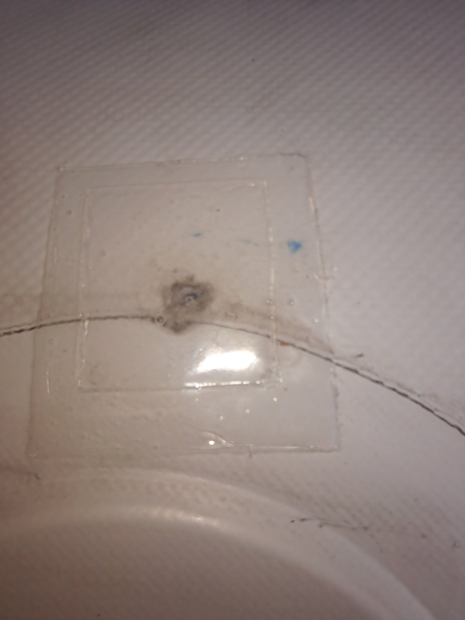

What is the clear material of the patch? Vinyl window material?
That is two layers of Shoe Goo. First layer is the larger patch. Second is a smaller patch on top to build up protection over the hole.
Before applying the Shoe Goo, I used Acetone to clean the area, used sand paper then a little more Acetone. Wanted to make sure it adhere until I get a patch on. Even then with the patch on I still wanted a good seal. I've pumped it up to 3psi and seems to be holding well.
