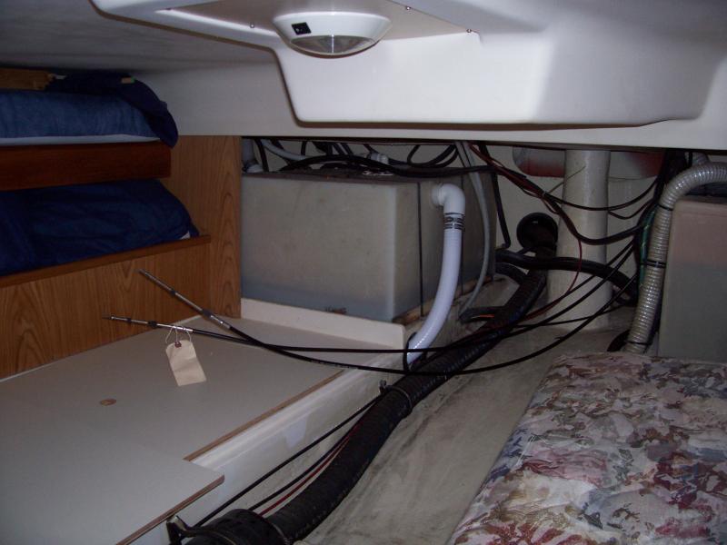

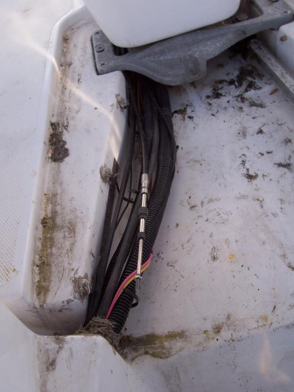

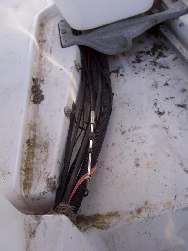

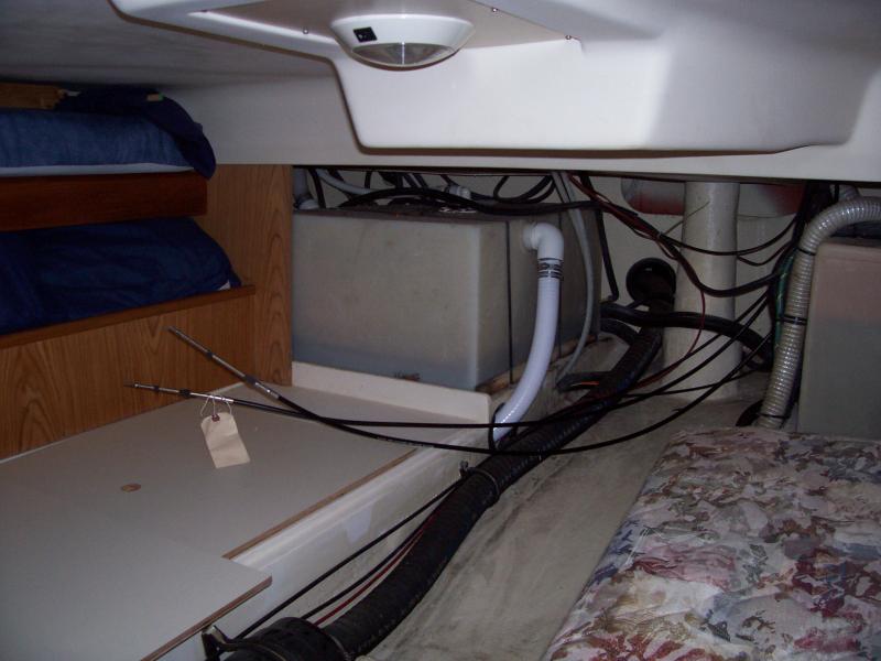

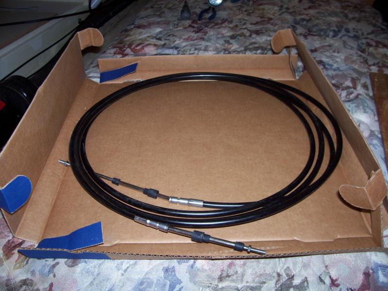

On my 2000 340, I replaced my Throttle and Transmission Cables.

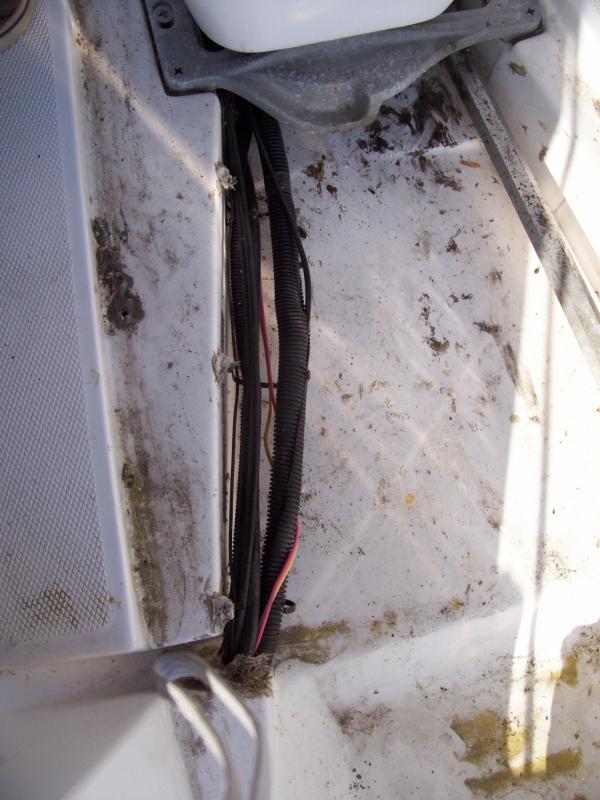

Like yours the cable was visible in some areas and hidden in others and there were no markings on my old cables to identify them either.

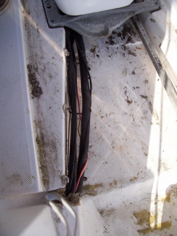

I cut open open the zip ties holding the black wire harness, where I could, to follow the cables from the Pedestal to the Engine and Transmission. They just love zip ties in the boat industry!
You do have to remove the old first to be accurate. Or at least expose them to measure them.
To much cable will cause throttle slipping due to the cable flexing and moving each time you move the throttle handle. And a cable break will not adjust for it.
Removed, mine measured out to be 17' 7" (throttle) and 17' 9" (transmission).

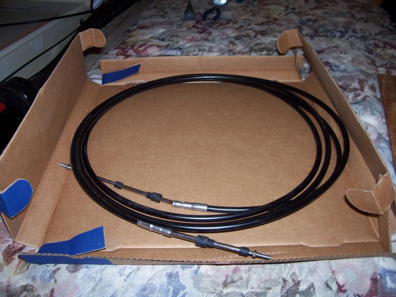

I used Teleflex Xtreme CCX 633 cable to replace both - 18 feet for both.
Like mentioned above, contact Dave Groshong, for the replacement. You won't go wrong.
