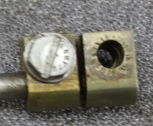

Here you can see the groove that it mates with. not the greatest design

I found the groove was slightly mis-shapen on one side so I rotated the rod connector 180 degrees. The screw is now touching a virgin portion of the groove. It still stripped a bit but it's finally in. After a quick adjustment of the shift cable it's working properly now. Hopefully it's enough to make it through all 29 bridges on the Chicago River. That would really suck to get stuck between them
