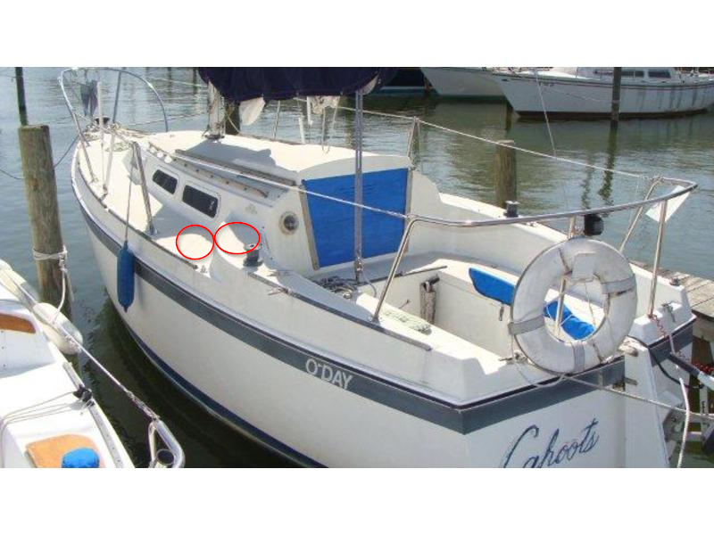

I'm starting to get a bit of delamination in a couple of high traffic areas. Would adding a teak step pad help to delay the inevitable fiberglass repair? Would adding some fiberglass to the underside help? I will do a proper repair when I have some more time

Here's a pic of someone else's boat but I've circled the areas. Everyone, including myself, steps on these areas when going forward or boarding from the dock

Access it from underneath don't touch the top . Use an oscillating saw to cut underneath and remove core. Epoxy in new core and 1708 stitched matt .It will be stronger then when new

I use a Dremel for cutting layers of fiberglass from the inside. Don't have to worry about going too deep, and the wet/delaminated balsa or foam core is easy to remove with a chisel or putty knife.

This is a good approach if the boat does not have a moulded headliner, which I suspect the O'Day has.

The O'Day has a liner. I would make an access hole or two below the area that needs to be repaired. Getting a drill in there would be a challenge. Those Multi-tools are amazing when you've got the right attachment for the job. Dremel sounds like it'd take a long time but could be useful for hard to reach areas. @dlochner is probably right that the core is wet. If it's only mildly wet I'm guessing it's a very time consuming process to remove the wood?

If you can get in there and cut out the underside in the fall, scrape out as much core as you can then let it dry over the winter. Re-core and glass it back together in the spring.

If the core isn’t wet, you could do a repair by drilling a series of 1/16“ holes through the deck surface in a grid pattern, then injecting thinned epoxy into the core. I have seen examples of the being done with the result being a deck that was stiffer than new...
If the core is wet, all bets are off.

Before you go cutting up the deck, think about what the problem is and how to fix it (easily and cheaply)
In the spot indicated in the photo there seem to be no through deck fittings. ( no stauntion or genoa sheet track.)
That raises the question If it is core rot, where did the water enter?

I doubt adding FG to the underside would help if the issue is wet core, and most likely it is.
Depending on the size of the area flexing, foot pads to spread the weight will probably help to delay gel coat cracking until to you do the proper repair.
