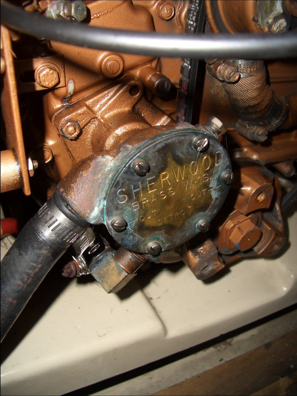

Trying to figure out which Sherwood raw water engine pump I have on my 1986 28' Oday. Has the Universal M12 diesel. Will it be a Universal or Sherwood number? Might have to replace or purchase a rebuild kit. Anyone know if the rebuild kit will contain a bearing that will need it being pressed into the old pump? Considering the Oberdorfer replacement, but that might be a different question not sure. There is no number on the impeller cover...any help appreciated.

I have a 1988 M 12 diesel. I replaced the Sherwood pump with an Oberdorfer N202M-15 pump from Cardinal Pump in St Louis Missouri (314-628-0100) last year and I could not be happier that I made the switch. It really pumps a lot of water and my diesel never goes above 175 degrees. I paid about $215.00 for the pump at Cardinal vs $300 - $400 at Marine stores. The pump does not come with the pump to engine gasket (I puchased the gasket from Catalina Direct for less than $3.00). It was an easy switch. The pump port size is 3/8". If you want to rebuild the old pump, then Compass Marine (Mainsail) has an excellent tutorial.

My old Sherwood looked just like the one pictured above (4 bolt holes with two bolts attaching it to the engine). The Oberdoerfer 15 model was a direct replacement with no fit problems and just used two bolts. My freshwater engine coolant pump seized up today so now I have to replace that pump too. If you do not feel comfortable replacing your Sherwood pump, then you can see it being done on Universal diesel engines on You Tube. I only have moderate mechanical skills and this is not a difficult job.
