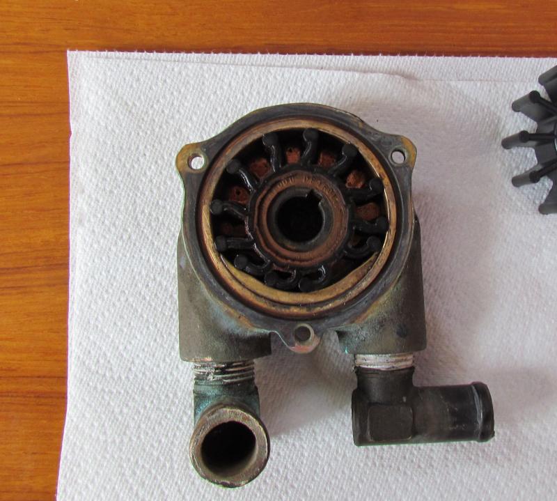

After removing the cover, I kept looking at this view of the pump.........
something did not look OK to me.

Going to have to check pump rotation direction.

It simply doesn't matter. The vanes will get the right set once the pump starts turning. I wrote mine down (before I removed the old impeller) and keep the note on the boat.

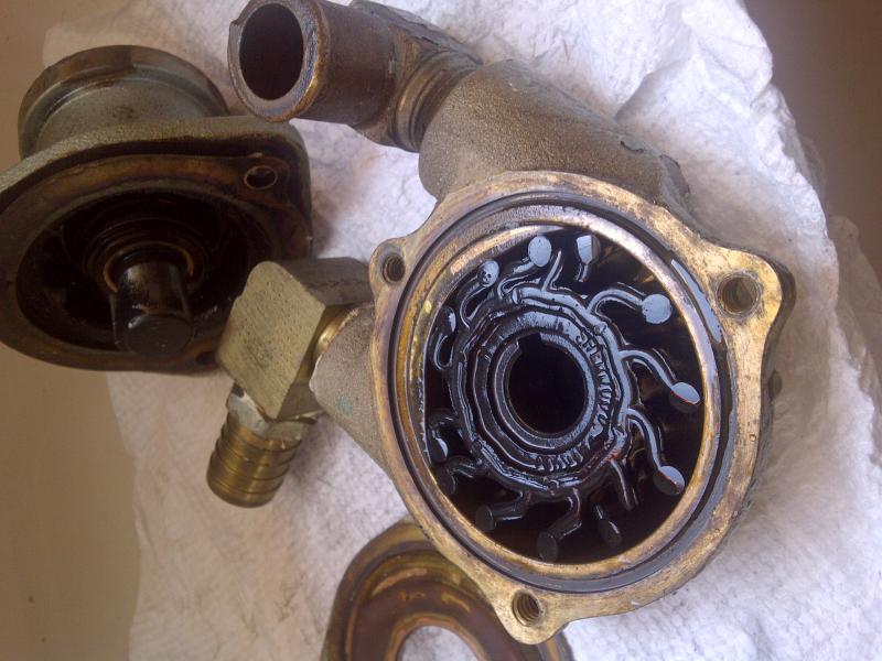

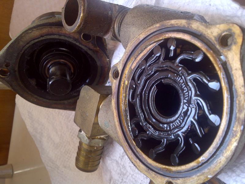

Mine looked the same. It must have something to do with the water loading, to put the veins point in different directions.

When the engine comes to a stop there can be a little kick back. This causes the vanes to back up slightly.
