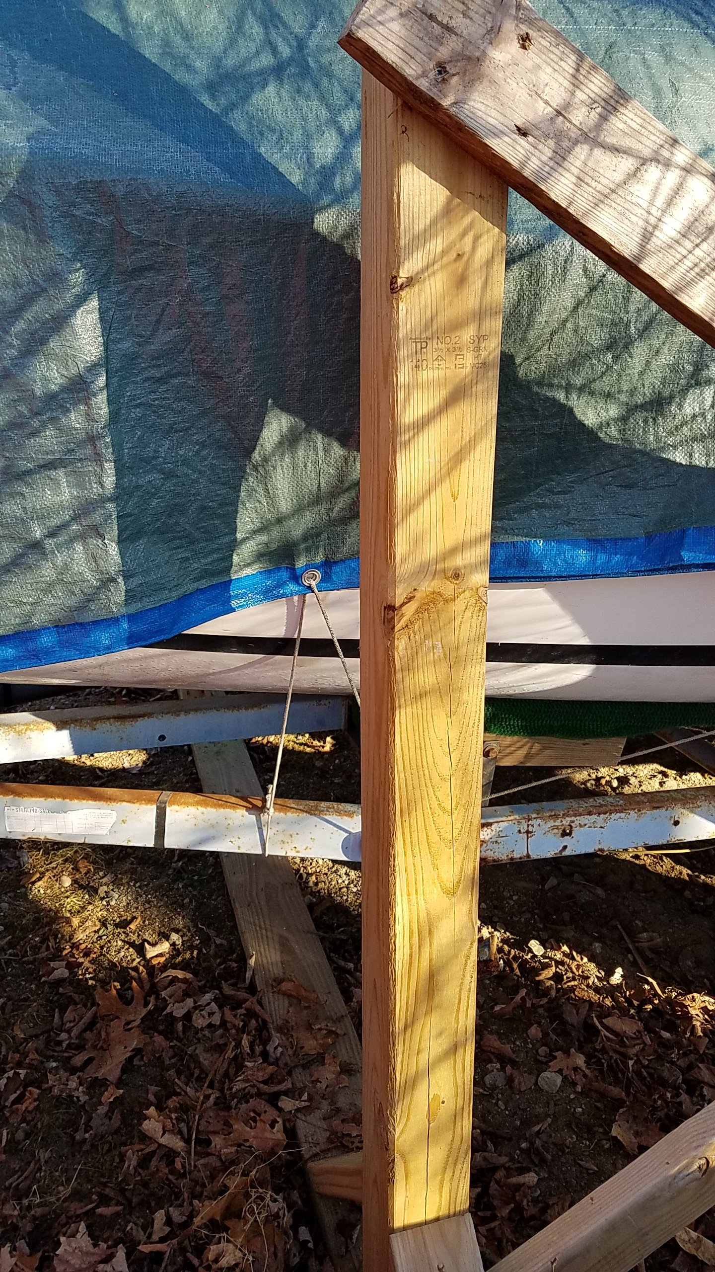

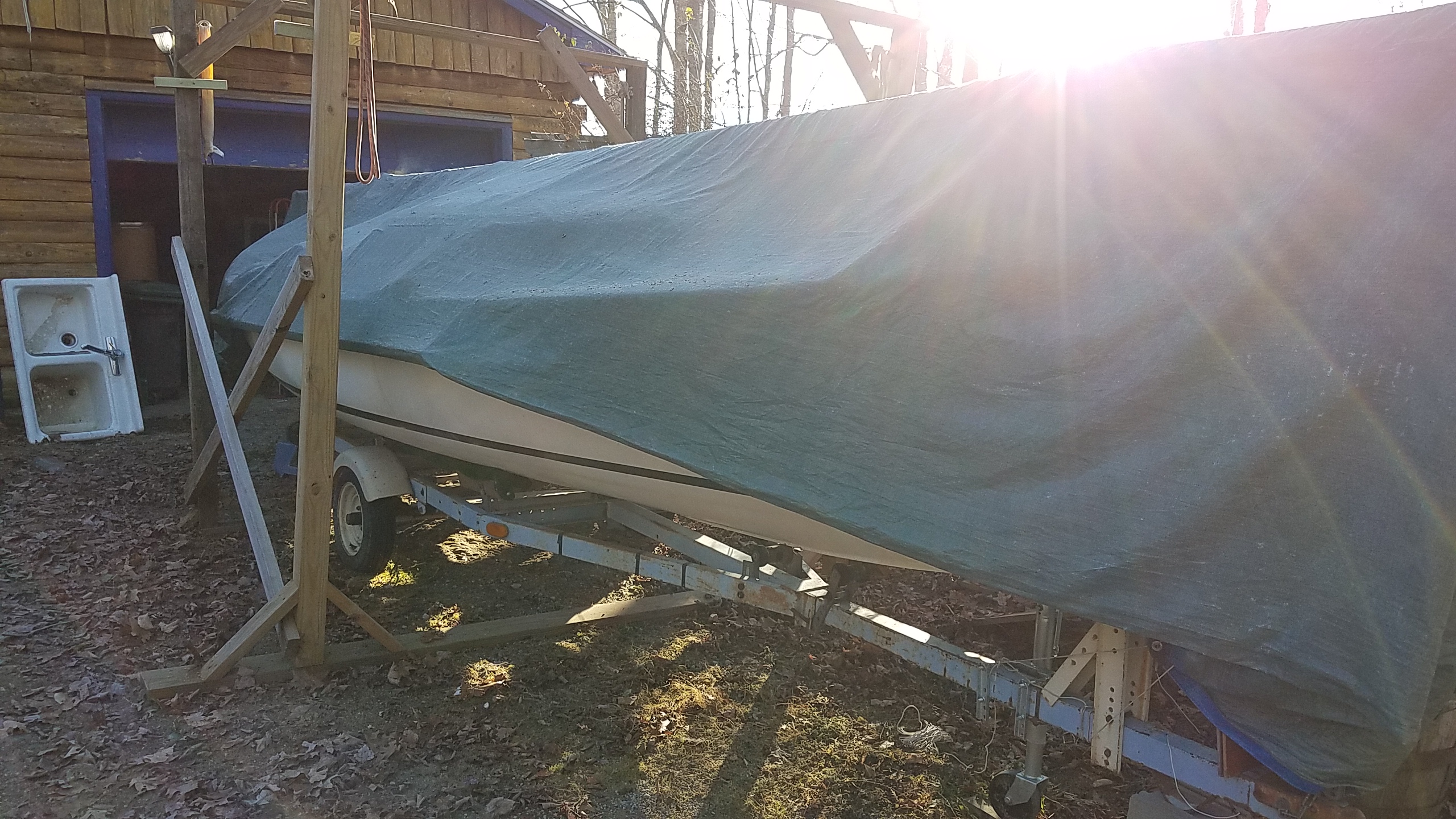

I've used jssailem's method going on my second year, 19' mariner. My tarp is an old one that is big enough to fold in half and slide a 2x4 into the fold. I tie it down to the trailer with that free twine you get at Lowes for hauling your wood home. In northern New Hampshire, we get our share of rain and snow all winter. Since I walk past it every day I can inspect it and brush it off of need be. Didn't have to. I also have a small outboard that I used pvc hoops on. That also worked well.
The secret is keep it tight, don't let it get blown around. Tie to all grommets.

The 8' 2x4 provided enough weight to keep her covered with a 1' snow load.

I don't like the idea of using the mast as a ridge pole. It can sag and deform. Sorta like Pre Prebend.
you do have to provide support in the middle too. I have a block the sits against the step, one on the transom and one that stands up from the trailer at the bow.

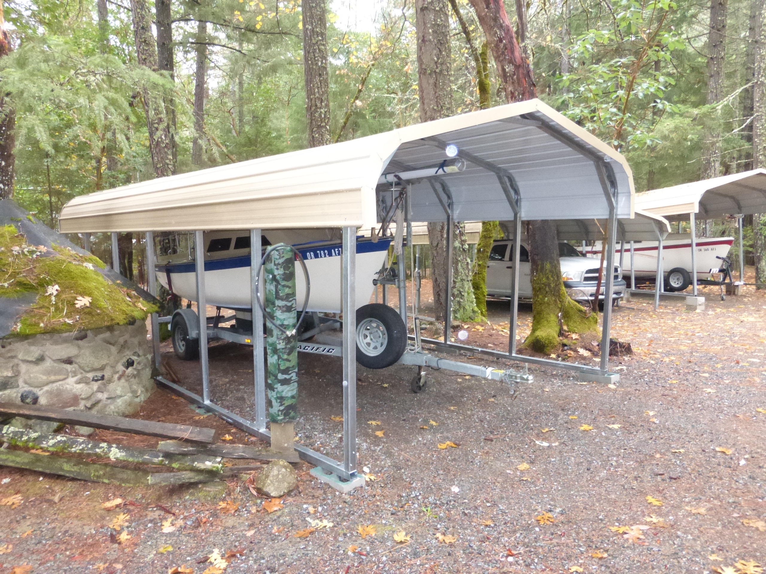

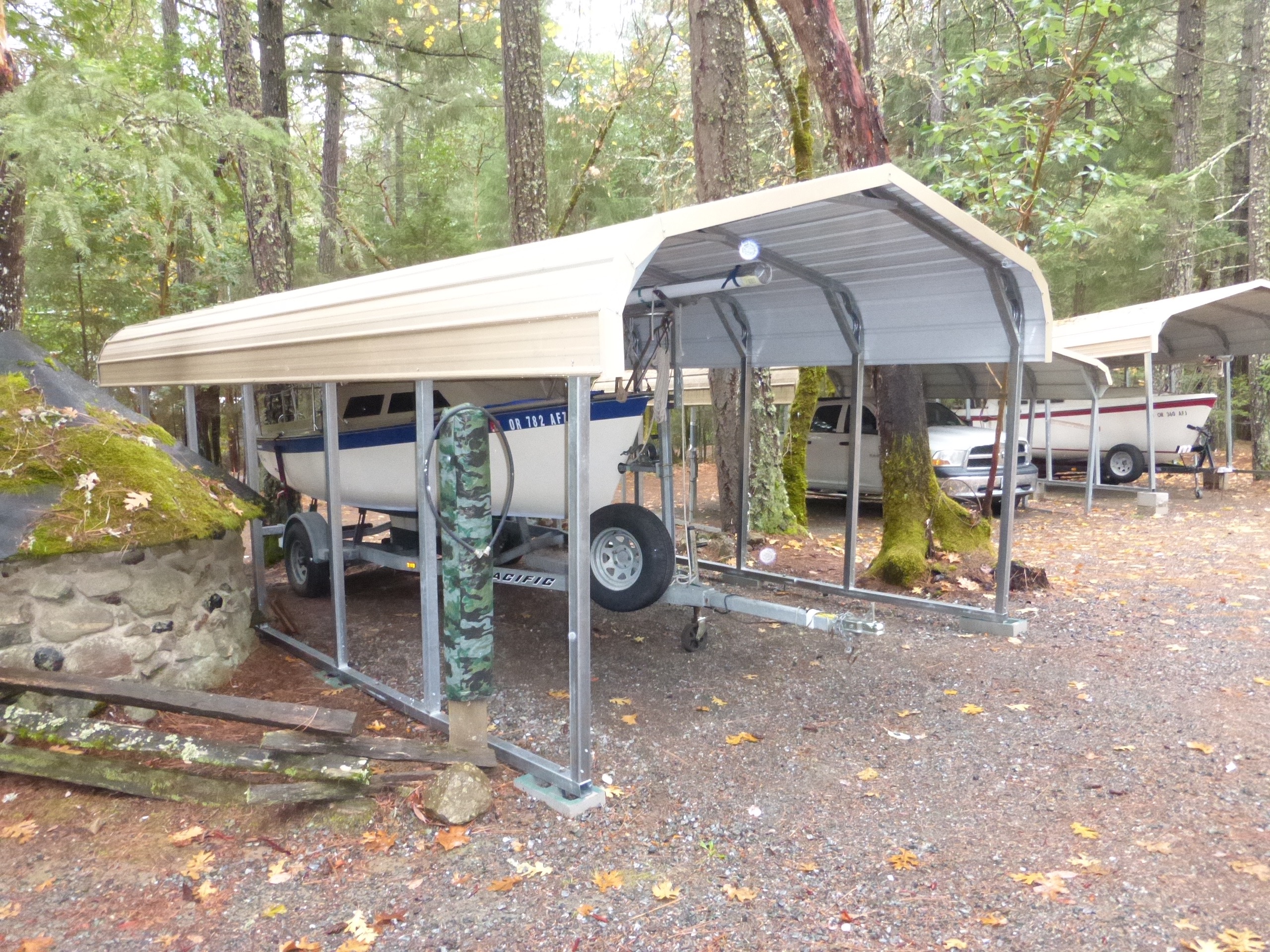

I'd guess there's a dealer in BC that sells similar to what I use in Oregon (California All-Steel Carports Inc.) . about $1200.oo all in for 12x24. price includes set-up on your level spot.

Those shelters, which appear to be spring up like mushrooms, sure look strong enough to shed the winter snow that is coming....
What happens, you find a new/stray boat. Lure it home and the Cal Carport folks send a truck with another carport...
They may be watching your driveway with a trail cam. Or perhaps chumming the routes you take with random oh so cute boats...
Well.... I do have 5 of the Cal Carports so far, so they may watch me for signs they need to up their inventory ;) .
