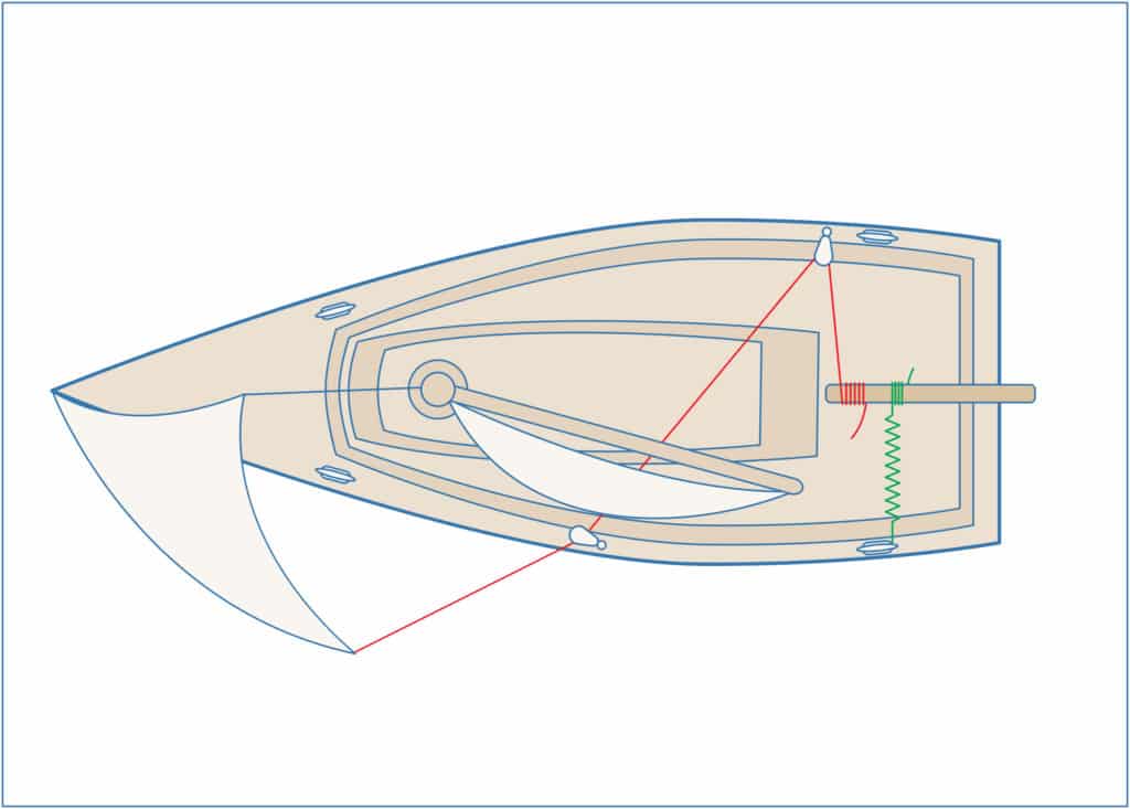

Looking for a book by John Lexa on self syeering, if anyine knows that system or a simple system to do this pls let me know.

This isn’t John Lexa’s ideas but it is similar material. It may resolve your quest.
When I had a tiller on my boat, I trimmed the sails to balance the helm, then engaged a “tiller clutch” to hold the tiller in place.
Something like that should work on your Bristol. The long keel and a balanced sail set can maintain a straight course for long periods.

This vid explains how it works.
I did a search asking for DIY sailboat self steering systems and got quite a few hits.
The best resource I can recall was part of a series on single handed sailing for racers and cruisers. I wish I could remember the author by browsing the first dozen hits or so, then I remembered this was a book that read at least 30 years ago, before YouTube. Anyway, in the book... a number of methods were discussed... from the very basic mainsheet and bungee cord to tiller which worked well but was easy to set up, but much more difficult when it came to making adjustments when responding to changing points of sail and sea conditions. From that initial basic set up, the author progressed through a number of designs to improve its efficiency and ease of operation. His design finally evolved into a JIB sheet driven self steering system that used an ingenious, wooden plaque device that straddled the sheet. It allowed tension levels to be quickly adjusted instead of fiddling with the bungee cord array and the cumbersome boom in the cockpit. If I can find the book's author I'll be quick to pass it on. I am also thinking this could have been a sailing magazine article...but it was much longer than the pieces you see in print these days. Sorry this response ended up being somewhat anti climatic. Good look anyway.

To the Tiller Tamer. I was out on the lake and after coming in another sailor who was out that day asked if I had an autopilot. I frankly cannot imagine single-handing without one. As the video that Joe linked to states, a well balanced boat close hauled will practically steer itself by only locking the tiller down. I have found this to be true in consistent gentle to moderate breezes and have enjoyed standing at the bow for minutes at a time in such conditions.
Sheet to tiller steering is and intriguing concept, and one I might look into one day. Thanks all for the resources!

This is how I actually got my boat's sheet to tiller steering to work WELL!
