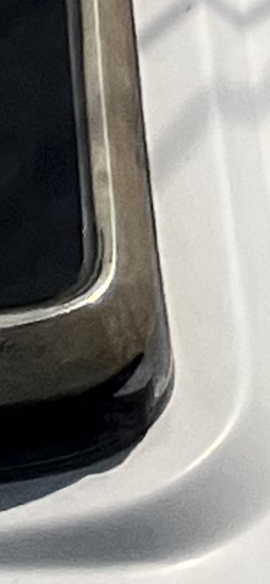

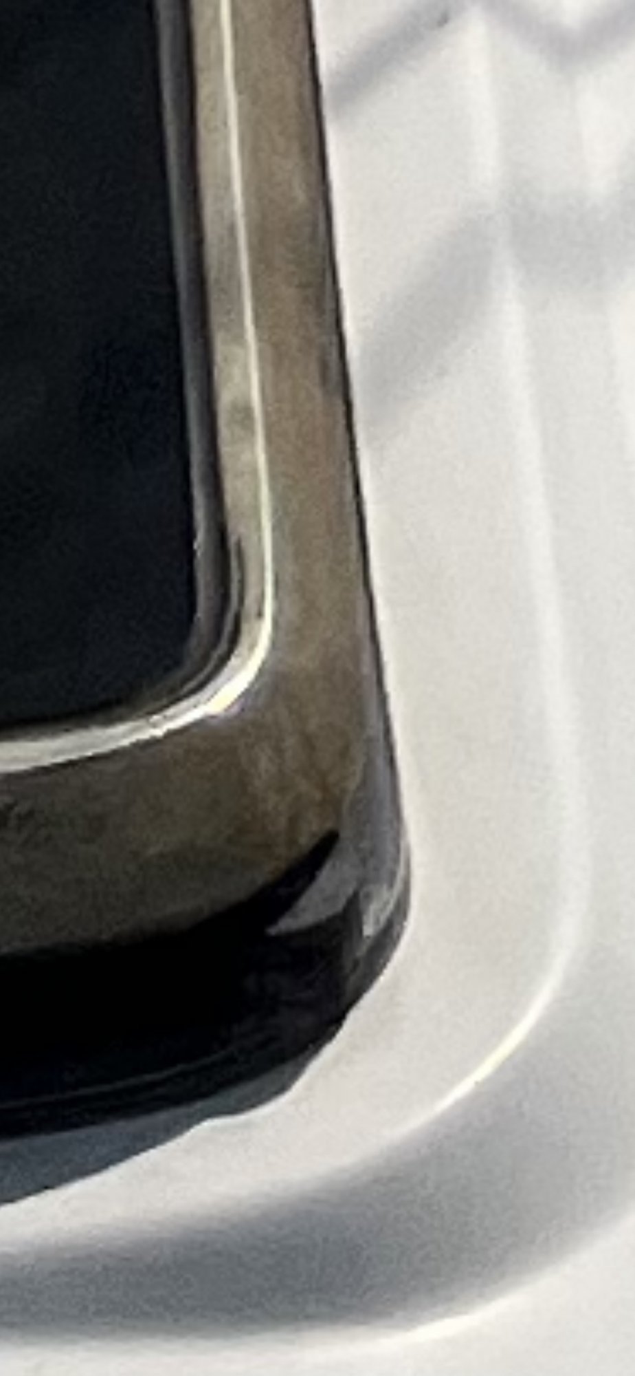

I have another solution. I had the same issue with genoa sheets occasionally snagging under the forward corners of the v-berth hatch, so I installed small blocks on top of the flange to fill the gap between the flange and the hatch at the forward corners.
I backed out the two lag bolts at the forward corners of the flange and bought two new bolts about 3/4” longer. Then I used a hole saw, I think it was about 1.25” outside diameter, to cut out round discs from a 1/4” thick sheet of black Starboard I had on hand and screwed down stacks of three layers of black discs with butyl sealant. You could use wood also and paint or seal it. 3/4” material would be best. I just used what I had on hand and built up to the desired height.
I did this five or six years ago and it really works. It keeps the genoa sheets, and any other line, from getting under the front edge of the hatch. It’s very discreet and doesn’t create a new trip hazard like I think rails could be. It solves your issue with the hatch. Maybe you could do something similar with the solar vent(?). If not, I can imagine some kind of rails or protective “cage” over the vent too. I have no solar vents, so that one’s not a problem I’ve had to solve.
Sorry, I don’t have any good close up photos of that specific detail, but I did find one I could zoom in on and took a screen shot. Pretty grainy, but you get the idea. The round blocks line up with the edge of the flange. The photo also reminds me that getting a new coat of black paint on my hatches remains on my “to do” list.
