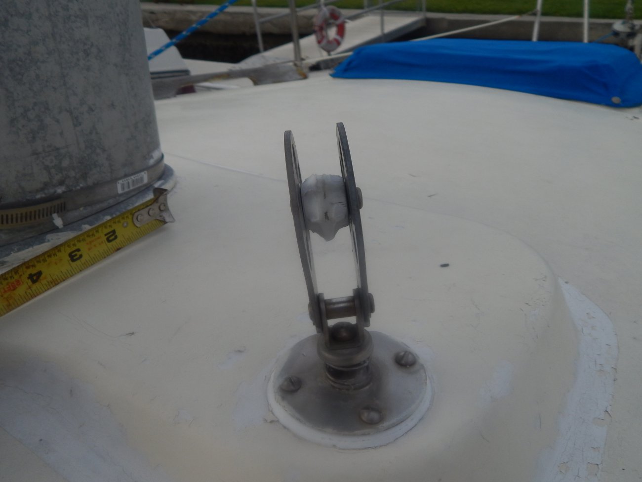

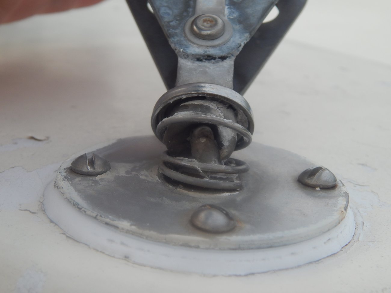

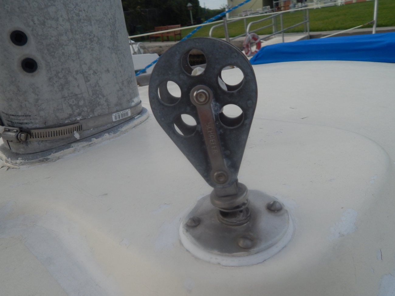

Lots of leads here. Thanks. Here are three pics of what I'm dealing with. Trying not to have to replace the base if possible. It's secure and doesn't leak. I'm going to explore all options. This shouldn't be too be a deal, I hope. Base is 2 1/2 in. Height is 4 in.

Time to replace the whole unit. Trying to drill out the riveted sheave is going to be a long and frustrating process. If you remove the block and use a drill press it will be much easier, but then you'll have to rebed the block.
If this was my boat, I take it off and put in it the recycling pile. To replace it, I would consider 2 options. using a similar block from Garhauer or some other manufacturer or installing a pad eye and then installing a separate block and stand up spring.

Based on your pictures and measurements, the block is probably a Schaefer Series 5 or 7 Series block
Schaefer Series 5 stand up block, has a 2" sheave (51mm OD). part number is 504-62 . Safe working load of 1750 pounds.
Or it is a Series 7 block with a 2-3/8" sheave (60mm). It has a safe working load rating of 2250. Part number is 704-62
Both have a plain bearing sheave, made of Delrin. It's well suited for high, static loads like halyards.
The street price of replacement stand up blocks on bases in this load range is between $100-150 each. Or more.
If the aluminum cheeks and SS base aren't pitted you can safely replace just the sheave. Replacing the sheaves is much less expensive.
Replacement delrin sheaves run about $15-20 each and can be ordered from Schaefer. The sheaves are available with 3 or 4 different size pins (in mm), and I don't know one fits your existing stand up block. Schaefer could answer that question if you figure out whether its a Series 5 or 7 block.
Get the OD, ID (pin size) and width to order replacements. Measure the pin hole diameter in thousandths of an inch with calipers for accuracy (or hundreths of a mm).
You'll need pins/bolts with an unthreaded bearing surface to replace the riveted sheave posts. I'm not sure where you can get them or what they might cost. We make them in the shop when we need them.
And as Dave Lochner pointed out, you're going to have to remove the blocks to work on them, I think. You'll bugger up the cheeks if you try to drill out the pin without a drill press.

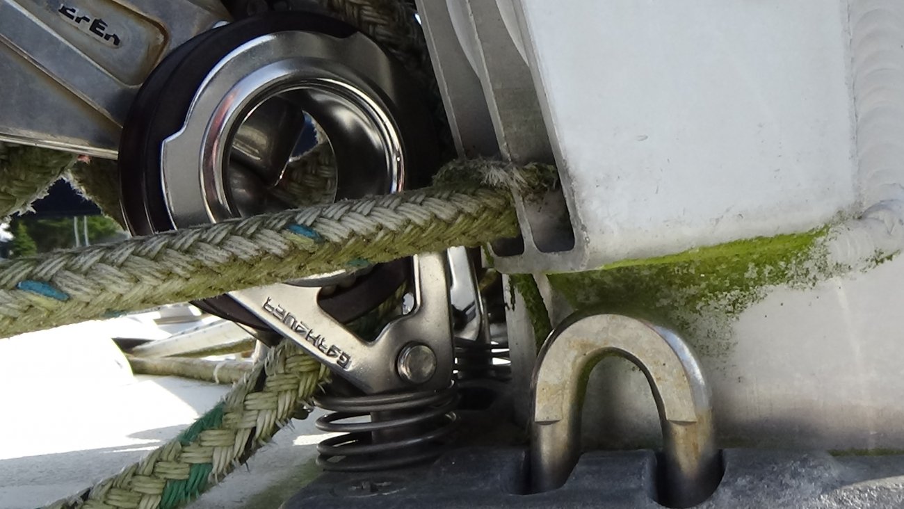

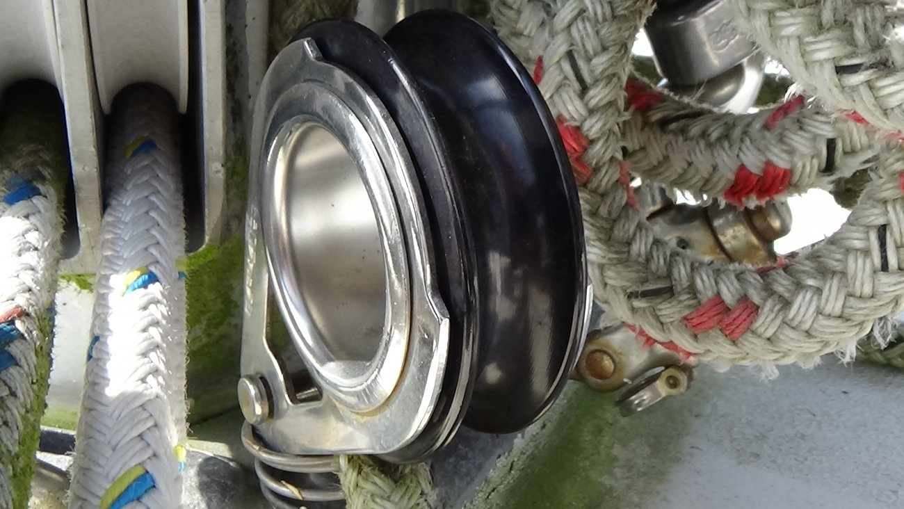

Old Garhauer blocks here. No pics of the new ones, both open end. Reused the pins (axles) and springs from the original. Going to the boat this weekend and will take pics of the new blocks. As I recall I purchased them through Defender after Garhauer confirmed the model.
Pics of the new Garhauer reef blocks here. Very nice , ball bearing, high quality. Much better than the old ones.

Eye of the beholder, eh? As I recall they were $40 each. Bday gift from the fam. Open end style in order to reuse the old spring, axle and locking ring. No mods, no mess, no stress. :beer:
