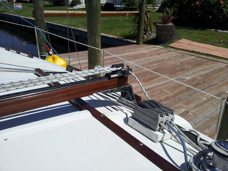

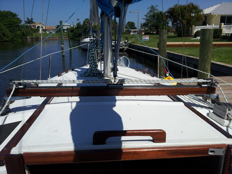

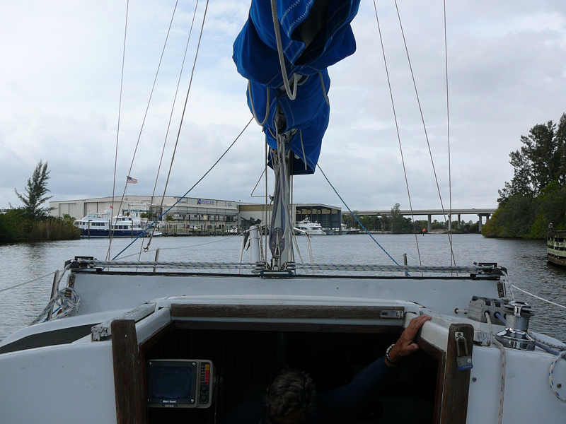

I just wanted to share some pics of the work I have done on my old Watkins 27 since I bought it in January. The list of work is extensive and ongoing, but I am at a point now where I am not afraid to take it out for fear that something will break because it is dry rotted or neglected. All the woodwork was done by hand from sapele, an African hardwood. Here are a few before and after pictures. Hopefully you can tell which are before and which are after.

Nice. Looking sharp! The traveller upgrade is impressive.
Bob S
Sep 27, 2007
1,815
Beneteau 393 New Bedford, MA
Looks great Norm, i like the pride of ownership! Did you fabricate the stainless on the traveler?

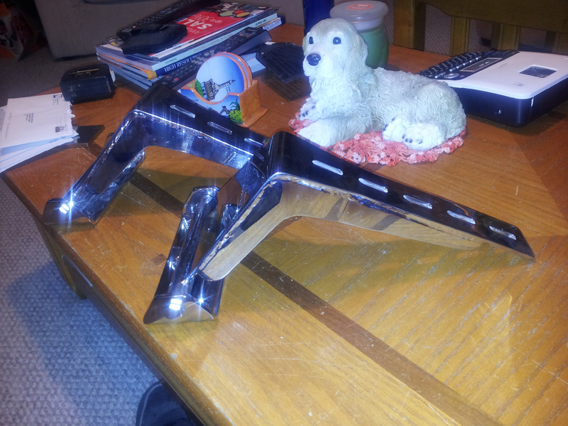

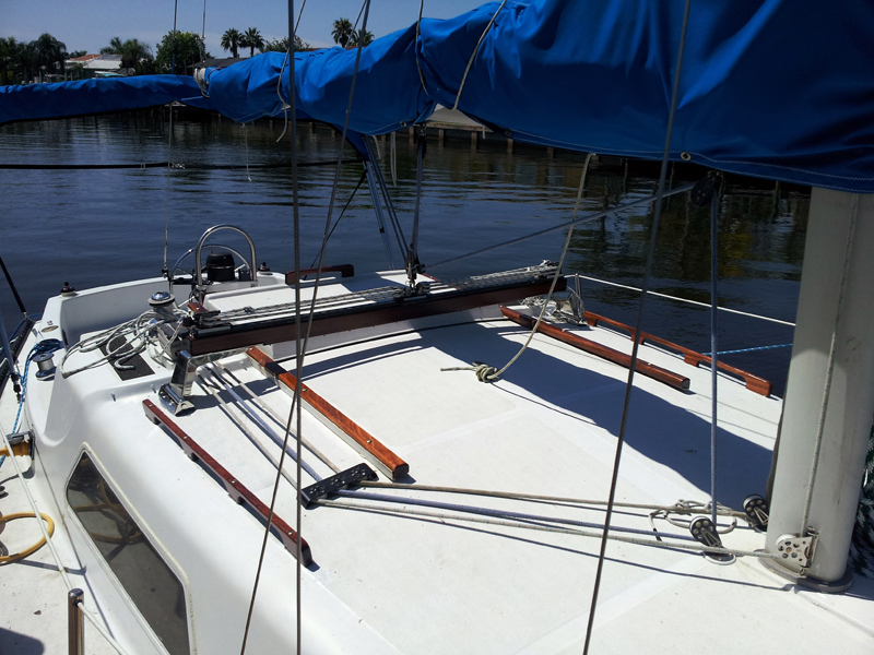

The risers on the traveler beam are from Garhauer Marine - an awesome deal at $160 plus shipping for the pair. They even included full sized stainless backing plates.

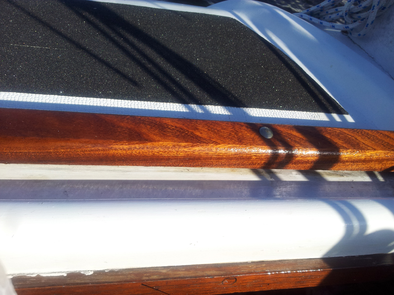

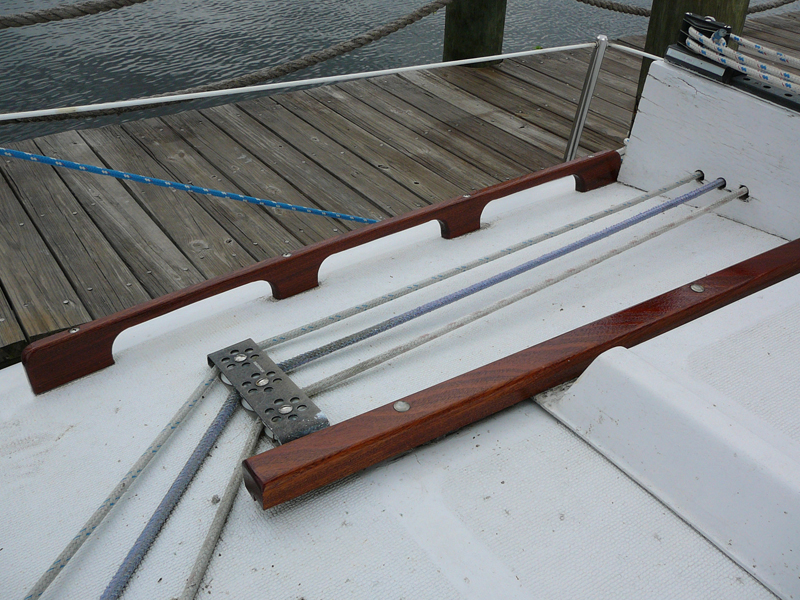

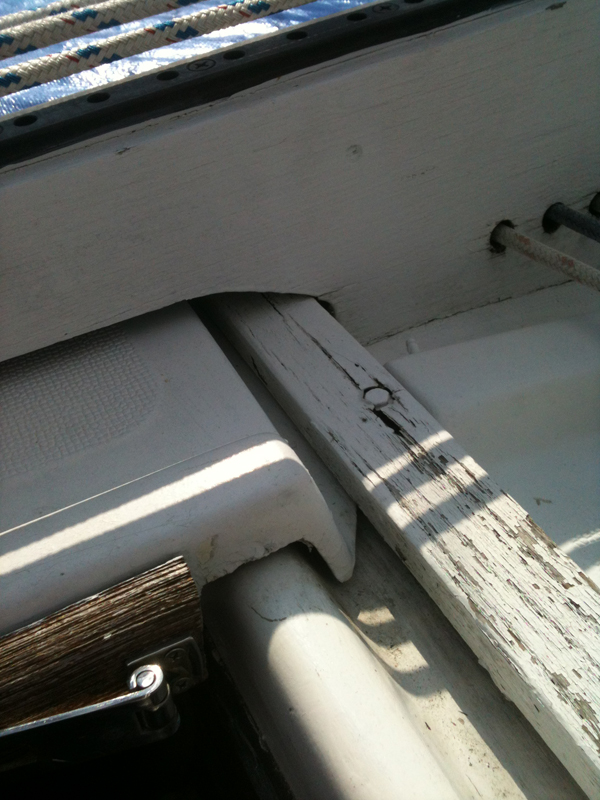

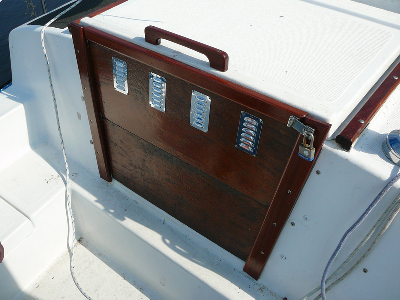

All of the wood is new. I bought sapele wood from my local hardwood supplier and made all the parts myself using a borrowed table saw and a cheap hand router. I've never done woodwork before so it was a bit of a challenge, but I just worked slowly and carefully and measured everything about 6 times. Except for the companionway boards themselves all the wood on the exterior of the boat is now new and all made from the same wood. The frame around the companionway, all the handholds, the main hatch rails and the traveler beam are all made from sapele. The finish is simply a few coats of spar varnish over the wood - no staining. These are some pictures from when the work was in progress over the last few months.

It's always good to get it done, and yours looks great. Was there anything special about putting varnish on the sapele?
All U Get
Oct 18, 2011
95
Watkins 27 Port Charlotte, FL
All U Get
No. In the Florida sun though it only takes about 3 weeks to tell you that you didn't put as many coats on as you should have. On a couple of the hand holds I only put two coats of varnish on and they started getting lighter in color in about 3 weeks. It was no big deal. I put a couple more coats on and it came right back to the right shade. Sapele is really nice to work with. It is very machinable and doesn't tend to split very easily. It cuts easily but is very strong. And the wood just lights up when you put varnish on it. It has a really rich look. I put about 4 coats on all the wood with 4 hours+ (or sometimes 3 weeks :redface:) between coats. I guess I'll find out if it stands up as well as teak...
Jul 24, 2006
628
Legnos, Starwind, Regal Mystic 30 cutter, 22 trailer sailor, bow rider NEW PORT RICHEY, FL
Florida sun, rain, humidity
Your work looks great! It has been my experience that any varnish will cloud and soon start to flake and peel. I am currently glassing over all the varnished wood on my dinghy because I don't want to continuously sand and varnish exterior wood. I only got 6mo of nice out of my varnish job. I used "Cabot Spar varnish-gloss".When I do my Morgan I will use pvc or some other plastic-sigh.
