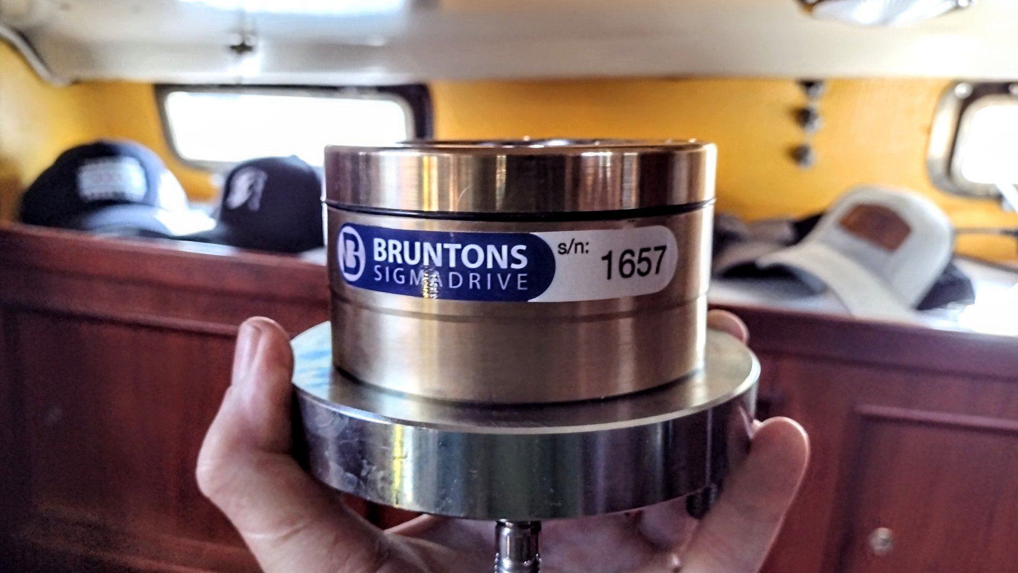

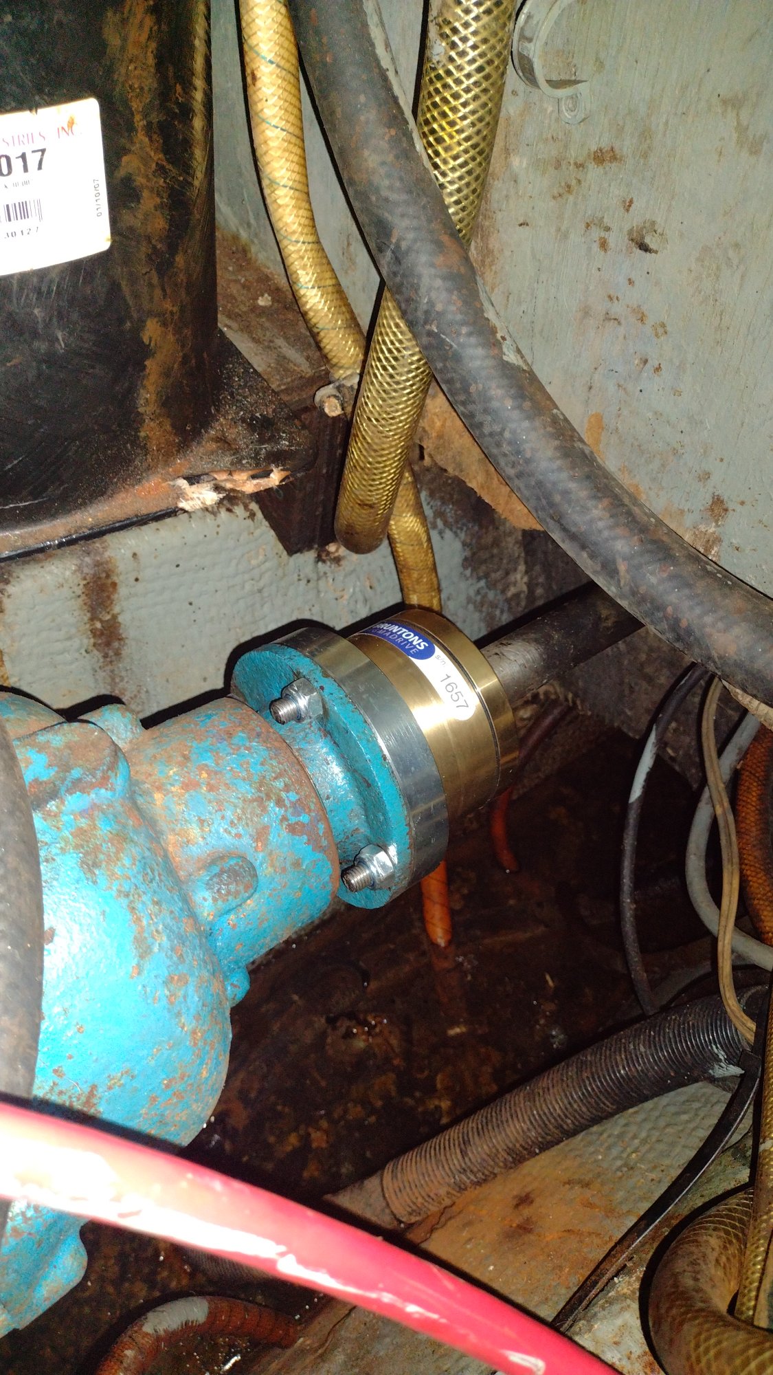

Thanks for all the tips. I've installed the sigmadrive and I'm happy to report that my engine is running smooth as butter! 10 out of 10 would recommend.
There were 1 or 2 of you who said to just check everything again. That's fine but when you have a rigid, straight shaft bolted to a engine mounted on rubber (basically) there's just no way that I can see, to maintain that .005" tolerance. It might work great for a few hours use but the rubber is going to break down, settle in, whatever and your going to start getting vibration. You might not notice it, but It's there.
