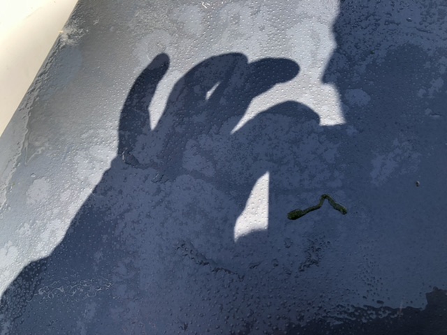

I pulled the rudder today and didn’t see anything that would cause it to shake. No plastic bags, seaweed, etc. I leaned it up against the cockpit and kneeled on it and there was no flexing, bending or cracking. I weighed it before I launched the boat in the spring and it weighs the same, 26.8#, and it still floats.
There was, however, what appeared to be tiny blisters, about 1 mm diameter on both sides. The pic doesn’t do justice. Is this a sign of water and intrusion and is that what is causing the shimmy? The rudder was painted with Interprotect 2000 followed by VC17 before launch in May.
I couldn’t duplicate the shaking since sailing conditions were much rougher than before. At speed, I could still feel a minute vibration but not the pronounced shaking previously experienced.

It does not seem like that would be the culprit but since you got nothing else to go with I guess I would pop those blisters and fill/fare and do a test run.
Seems like a mystery.
Is there a chance someone struck your rudder and bent a gudgeon? Maybe the rudder is not hanging plumb by a hair and at speed your keel and rudder are fighting each other.
