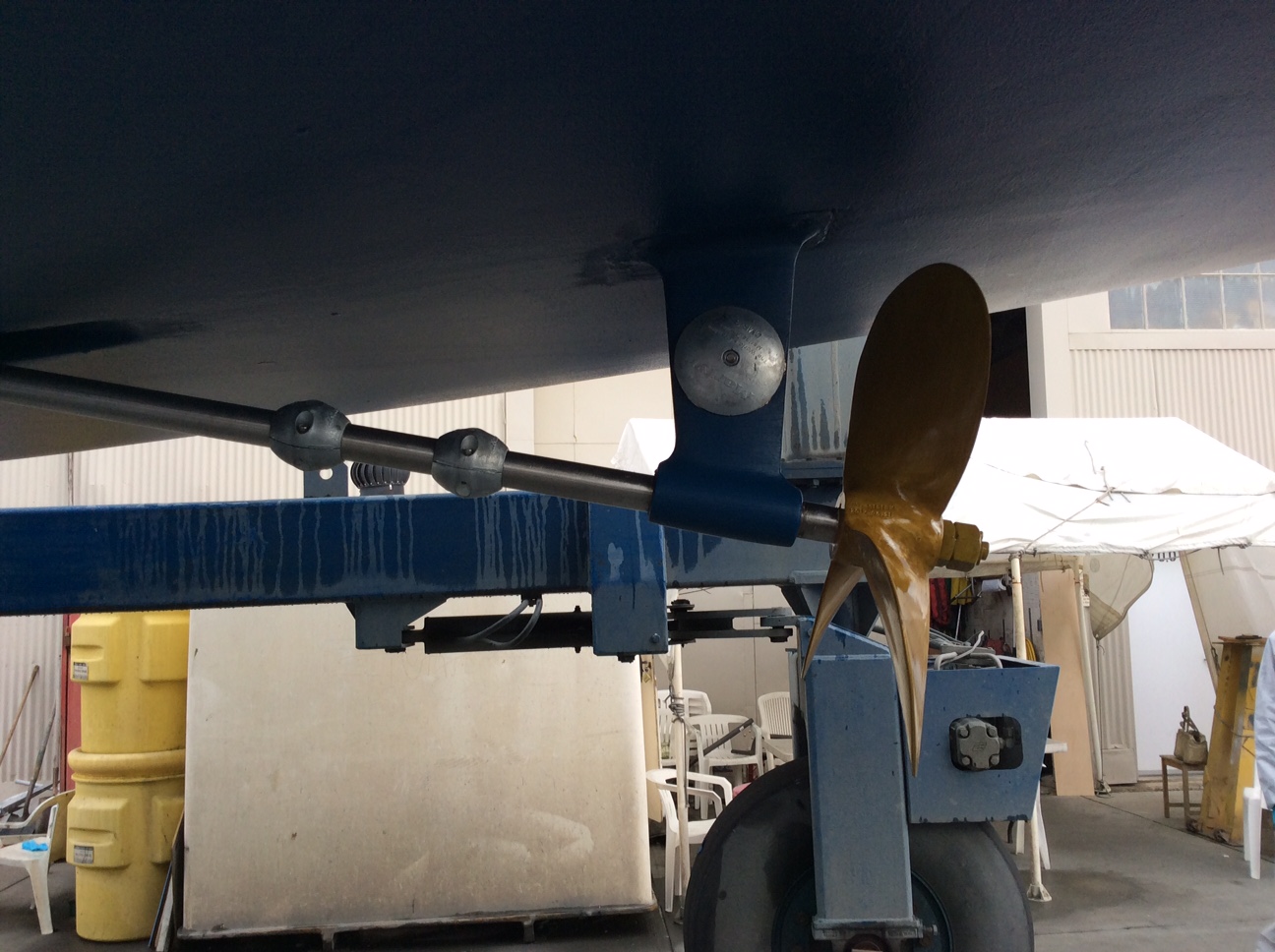

I install 2 zincs on the middle of the shaft, one about 8 inches forward of the strut and a second one about 6 inches forward of the first zince as shown in the attached photo. I understand this location on the middle of the shaft avoids reducing water flow into the cutlass bearing and does not interfer with the shaft log.
That is how I do it...

When the propeller is moving the vessel forward and backward it also moves the engine back and forth. The movement is more than 1/16", you can see this where the shaft comes out of the stuffing box. Since you have only 1/16" of space it is sure to rub against the cutlass when shifting forward and backward.

Point taken and appreciated. It's always a good idea to ask before implementing a "good idea". Thank you.

:plus:Very true. Now adding to the rubbing is the possibility that you could break the strut. If enough force is placed against it as you change gears. Think about the shaft moving through the cutlas bearing. The zinc (which you secured tightly agains the shaft) slamming into the strut as you shift gears.
Maybe it will not happen. I would not want to take a chance.
