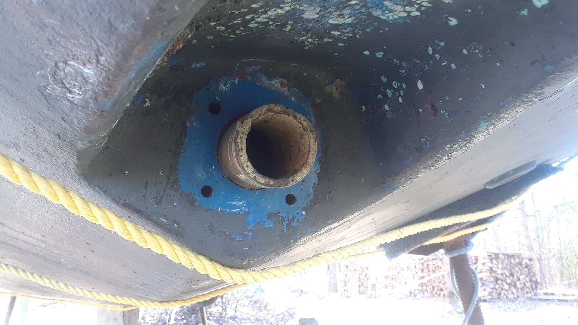

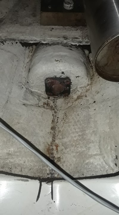

I installed a new shaft log in my 84 H27 a few years ago. The bronze had begun to crumble. Here are some pics of the old one:
The shaft log is installed on the outside of the hull and through bolted to the inside. Yours is probably done the same way but has 4 bolts instead of 2.
Here is a pic of the new Buck Algonquin log that I installed. Not sure if they make a 4-bolt version.

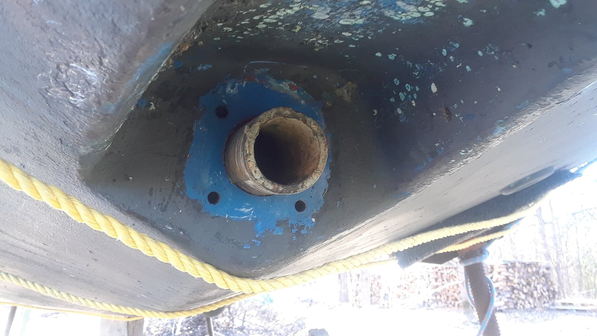

Yes, I saw those last year, but they are not a "plug and play" match.
Somewhere there is one sitting in a bin, just waiting to be found and rescued
from the scrap heap. I just don't know how to find it.

I see,,, you also have the 4-hole version. Hunter must have gone to the 2-holer in their later year cherubinis.

Thanks everyone! Thanks Heritage for your pictures. It made me realize my problem so I found what was missing in my setup. Actually, the "stern tube" was inverted. Someone put it the wrong way into the hole (from inside instead from outside). Problem solved, for now...
