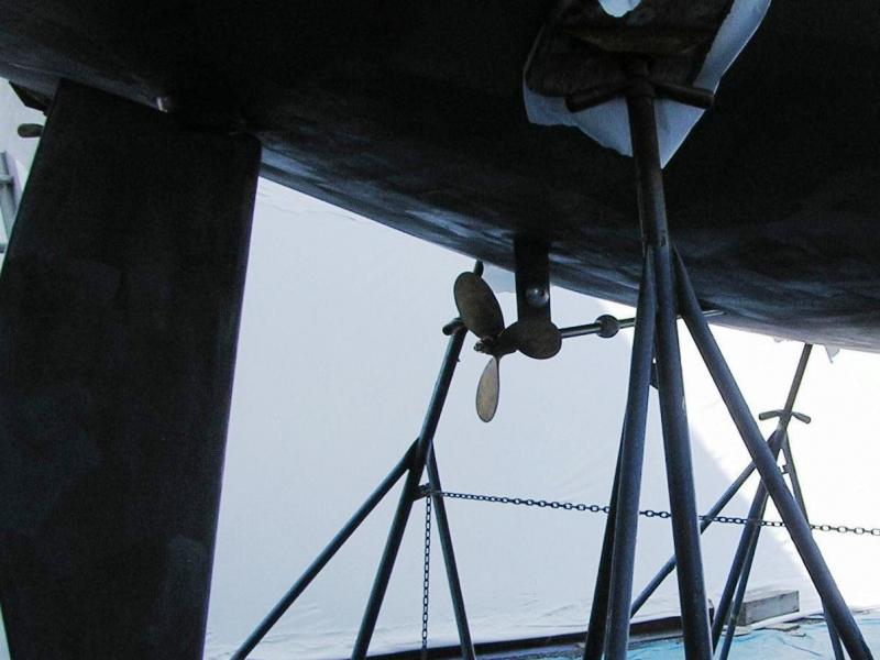

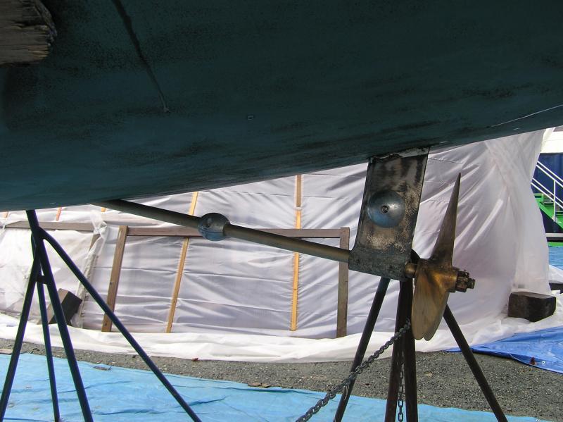

I had a similar experience with the strut bolts. I had owned the boat for about a year and had hauled her out at the marina where I worked, just to clean the bottom. The shop foreman wiggled the strut and said it was loose. We tightened up all the bolts (one was really loose) and sealed the nuts with 3M 5200. That was 5 years and 4,000 miles ago, and the strut is still tight and hasn't leaked. My boat at the time was 3 years old.
