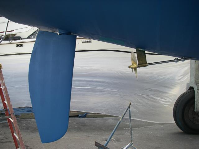

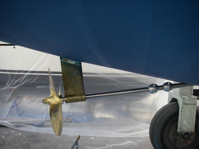

I think my new prop on my 2005 Catalina has been singing to me all along. At 2100 to 2900 rpm's. It only does it in forward or if you put it in nuetral while sailing. It does not make the shrill whine while tied to the dock in forward at 2100-2900. My question is can I just file the edges down a bit. My prop shop said they will do it for free. I was just trying to save myself the trouble of pulling and reinstalling in the water. Anyone done this one? Also my prop shaft only has room for a castle nut and no room for the addtional lock nut. What was Catalina thinking?

Catalina machines their shafts to ABYC standards and as such it should have more than enough room to fit the thin nut and the thick nut. If you can't fit both I would guess your prop may be installed incorrectly with a key binding or a prop that was not properly fitted to the shaft...

Main, This is what came with the boat when I purchased her. Do you think that the prop hub is too thick. As it sits I only have room for the castle nut. The prop is seated properly on the shaft. Also I was wondering if the whine I here could be from the Shaft sinks?
