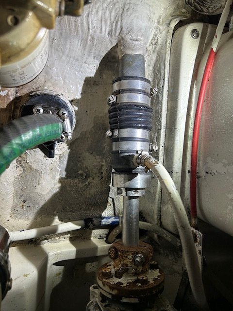

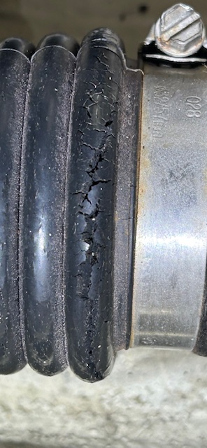

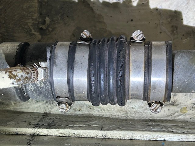

I was prepping our boat for a sail to Cape May next week and found this at the shaft seal. I don't know how long it has been like this but it was enough for me to re-think our trip. Luckily, it will be replaced on Tuesday so we should be GTG. BTW, doesn't it look like the bellows is way over-compressed? The original owner installed this and I don't know how long ago. Accordingly, it had been on my mind to replace it - but I should have done it no later than last winter. This is going to cost me a haul out. I might have taken the opportunity to replace the motor mounts at the same time if I had only done it in the winter, but I don't want an extended haul out now.

Separate job - Check your engine alignment after you go back in. Maybe it’s just the bellows but it looks in your photo like the two sides don’t quite line up.
Edit - It might not be overcompressed. You can safely check that while in the water.

I'm replacing the entire assembly. The price differential between replacement parts and new assembly is not significant enough to me. Besides, I really don't know how long it has been since replacement. I think alignment is fine and the bellows alignment is misleading. I do have plenty of room to slide the shaft back without removing anything under water. If I was experienced replacing these things, I could consider grounding the boat on the other side of the bay on sand at low tide. Our tidal range is just half foot and I'd bet it could rest comfortably on the wing keel while the work was done. But the travel lift is already scheduled and they will do the work while it is in the slings. I would like to clean up the coupler by grinding off the rust and re-painting. Perhaps I can get that done while the mechanics are installing the shaft seal.

When I installed a PSS and compressed the bellows as specified (3/4"), it looked pretty much like yours, the ribs were touching. If you're replacing everything, maybe consider switching to a Volvo shaft seal - people really like them and they don't have bellows that need to be replaced every 6 years. I didn't know about them at the time but would've gone that route.

PYI (lawyers) say you should change your bellows every 6 years. Mine was over 10 when I replaced it. I'd bet yours was pushing 20y.o. any idea how long it had been in service?
