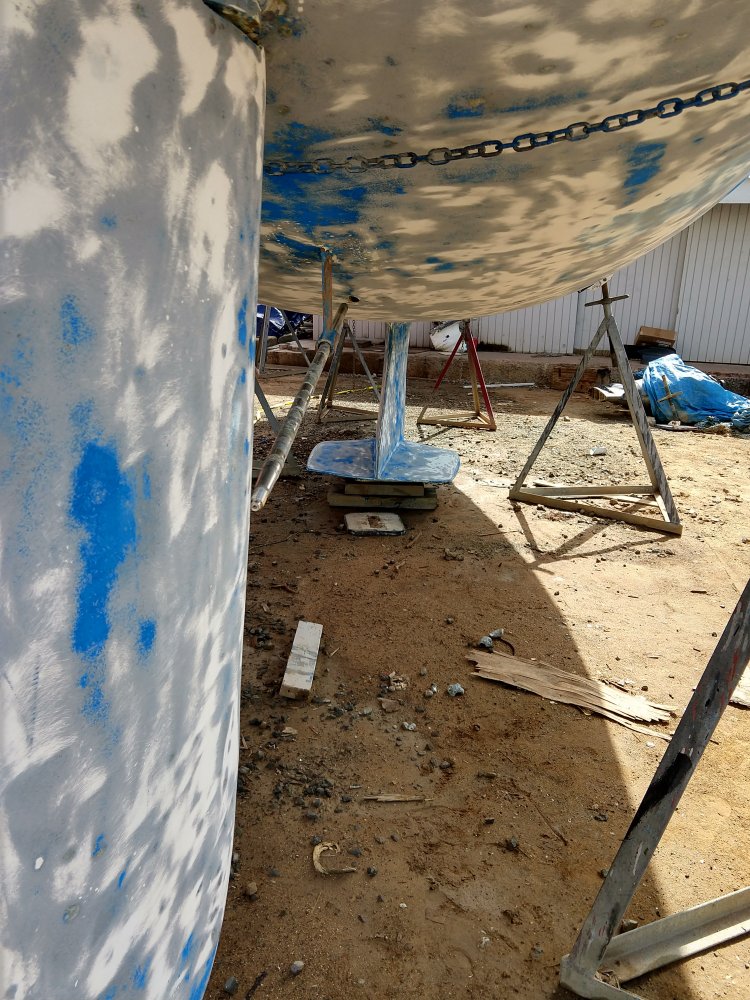

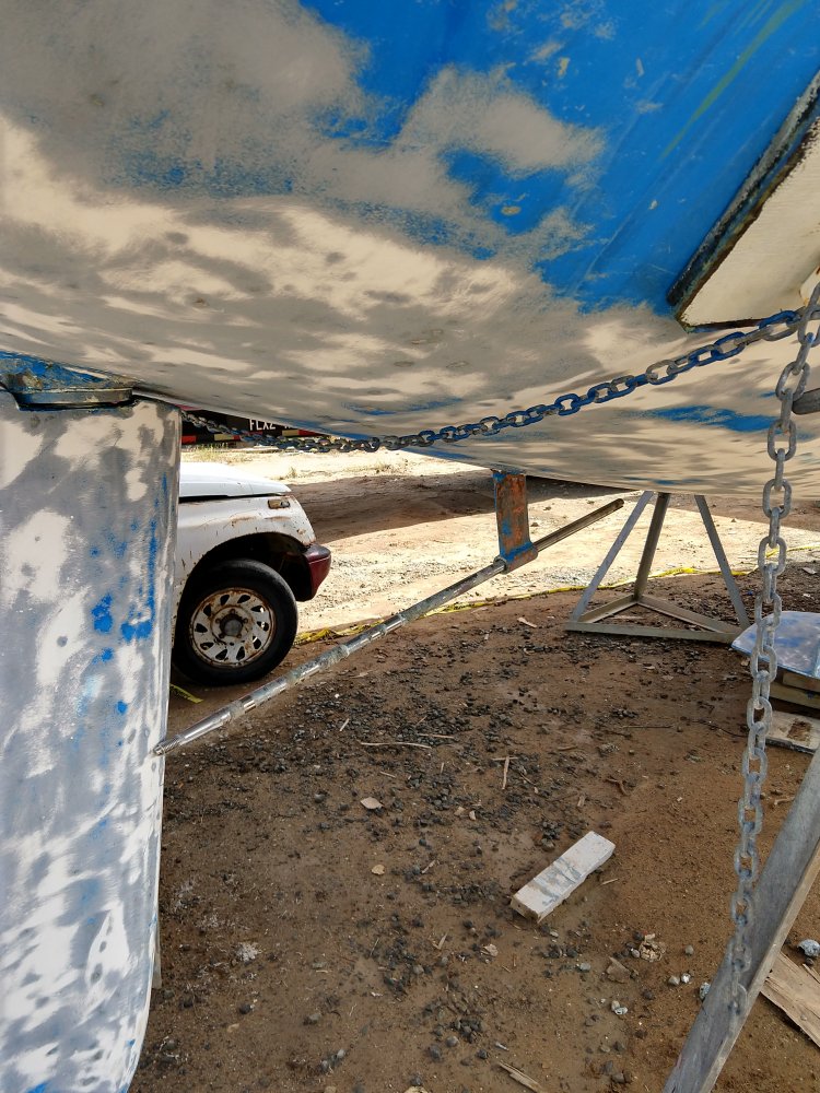

Anyone actually remove or install a shaft on a C310? I cut my factory and installed the new one with the engine off the blocks. So i put the shaft in through the engine bay. Now I am trying to replace my cutless bearing again and I can not figure out how to get the shaft out without damaging the rudder.

This is sort of a chicken or the egg issue....
On my O’Day 322, the shaft is pretty much in line with the rudder. When I replaced the shaft, I removed the stuffing box and hose plus pushed the strut bearing out ( I have a press to press it out). That gave me enough lateral play to get the shaft out past the rudder...
It was tight, and I took a little paint off the rudder, but I got the shaft out (and a new one in) that way.
But you want to take the shaft out to to get the strut bearing out...

Thanks. Ours did have movement and I noticed weird vibrations this season. Did a short haul to redo the bottom last week and asked the marina to tackle this issue. The yard is in the process of replacing the cutlass bearing. They tried to get it out with their tool to press it out of the strut but the bearing was breaking into little pieces and didn't work. Just got a call this morning that they will need to drop the rudder now and pull the shaft.....sounds like it just doubled my original quote for the work :-(

Well, shaft was found to be worn around the area of the strut and no longer straight. They cut the shaft to remove and had a new stainless steel shaft made. Without the bearing in the strut they were able to get new shaft past rudder without dropping it. re-launching tomorrow.
