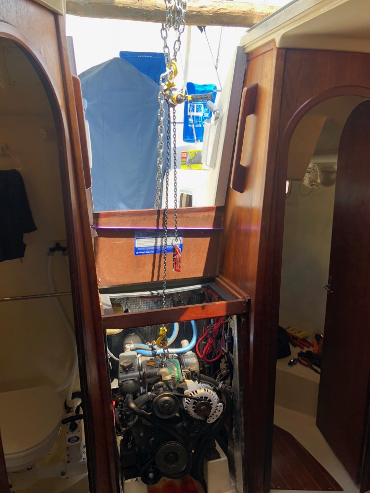

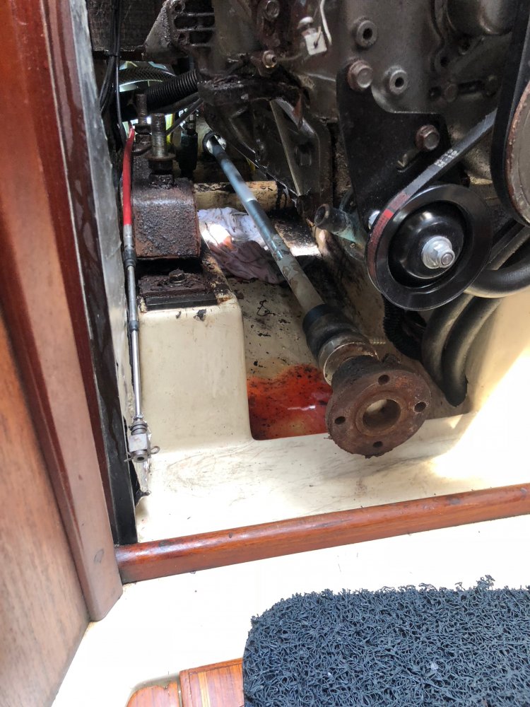

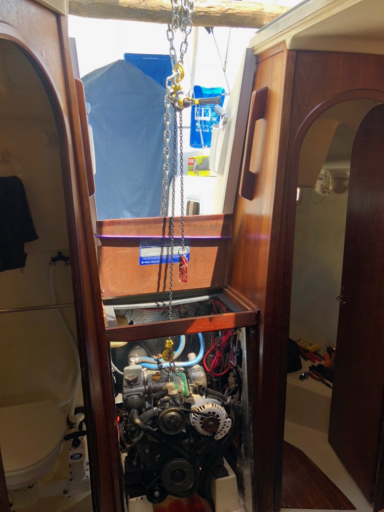

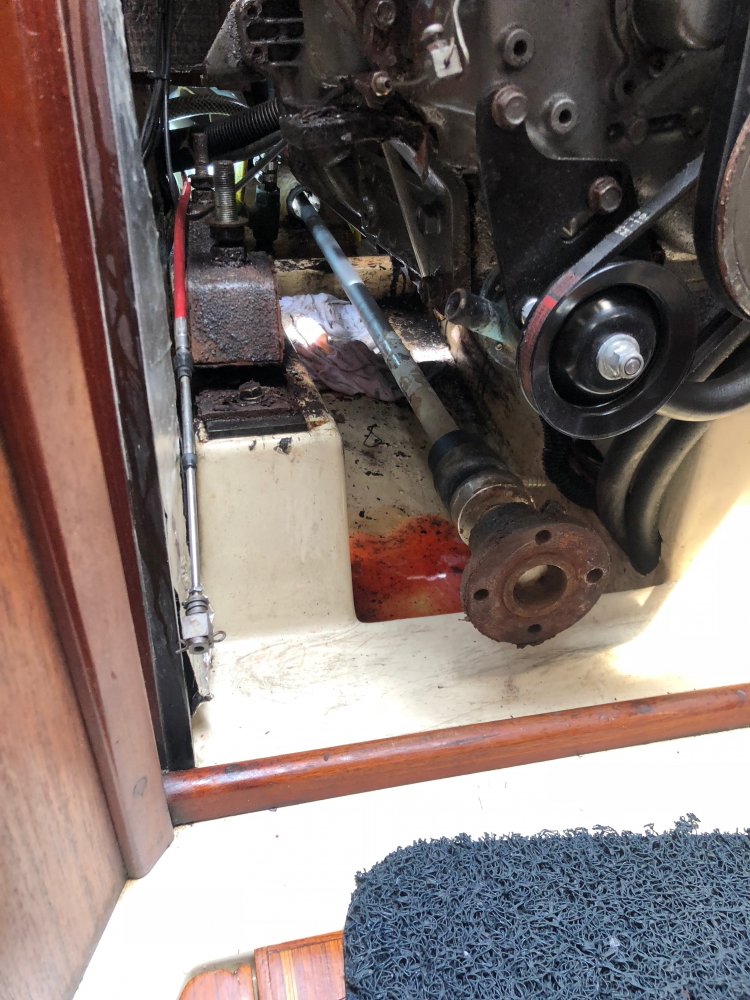

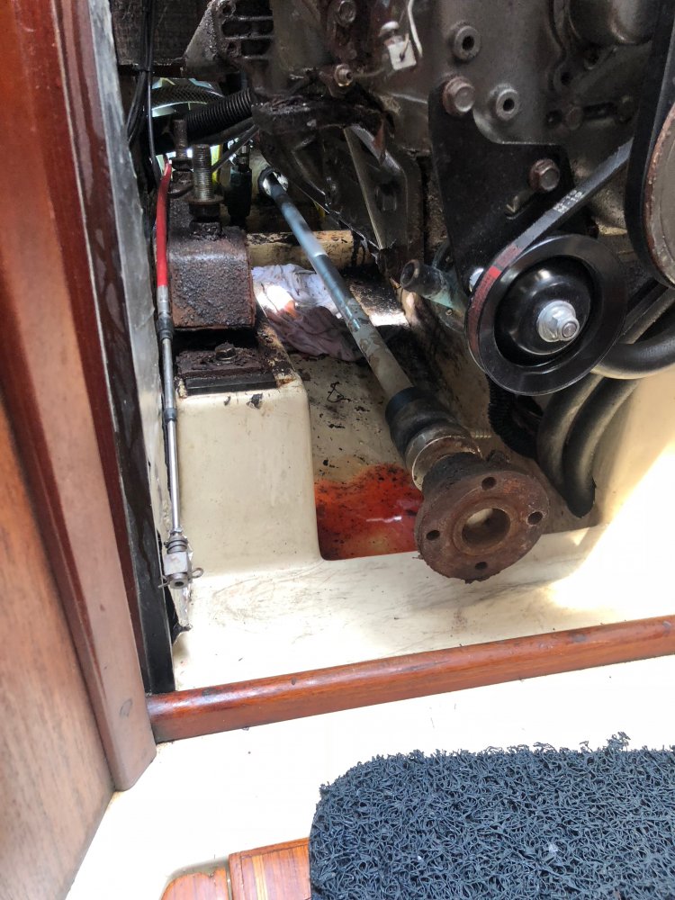

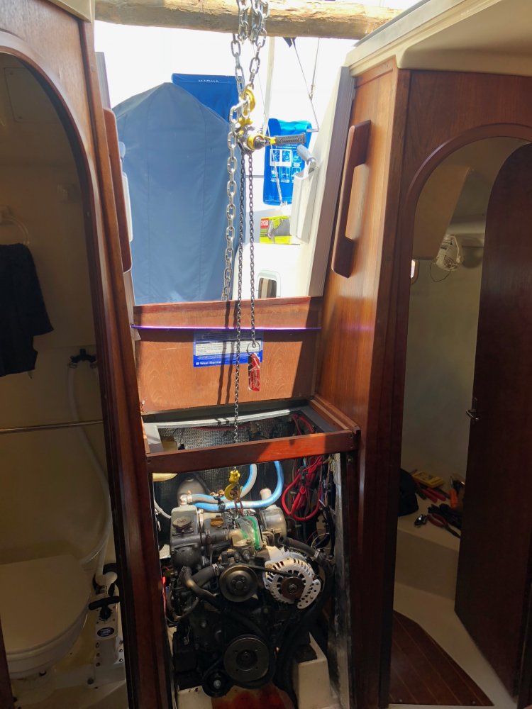

Do you have any pictures showing what your dealing with?
:worthless:
nfg2u
Feb 13, 2016
92
Hunter Legend 35.5 Fort Pierce
1/4 ton winch
Replacing motor mounts anyway so I decided to go up..
