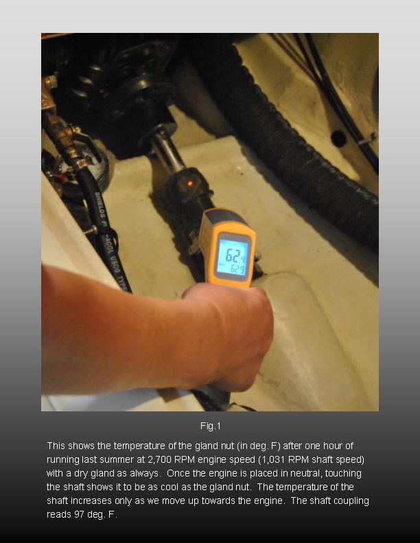

Using Teflon Impregnated Flax Packing ................
............... allows your stuffing box to run stone cold and bone dry.
Attached is a shot from a thread I submitted some time back.
I've never used the green goop but I don't see why it wouldn't work every bit as well on a sailboat prop shaft due to its low surface speed.

I still can't understand why boaters would want a stuffing box to leak (when it's not needed) and keep their bilges perpetually wet. We use our bilge for storing the toilet paper.
