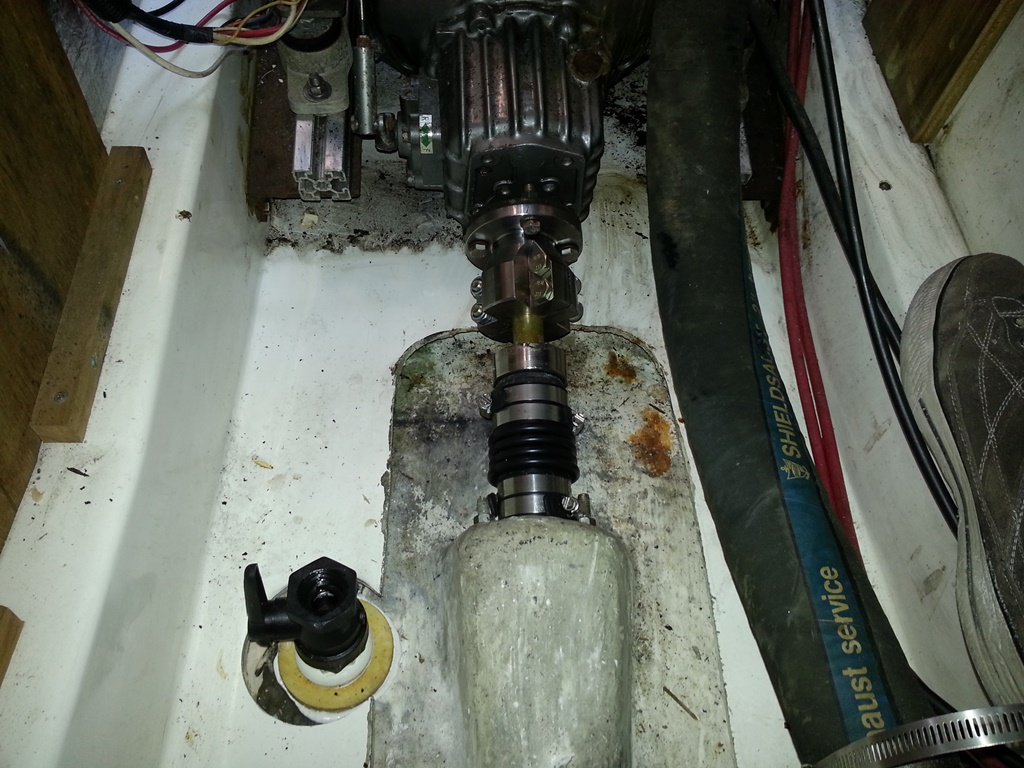

Yes it is. PYI carries them under the R&D name. PYI is the same supplier for the PSS seal. Here is a picture of the coupling.
For my Yanmar I required the 78 mm diameter flange with a 1" shaft bore. As you can see, the four bolts clamp down on the shaft very tightly. For our small engines the manufacturer even indicates it is not necessary to use the shaft key. I had so little room that I couldn't get it to fit back after I assembled the coupling to the shaft. You can see how easy it is going to be to remove again if for any reason you would need to.
