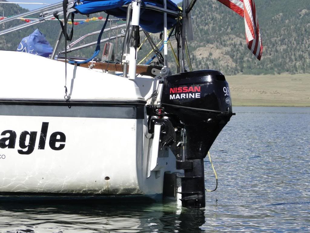

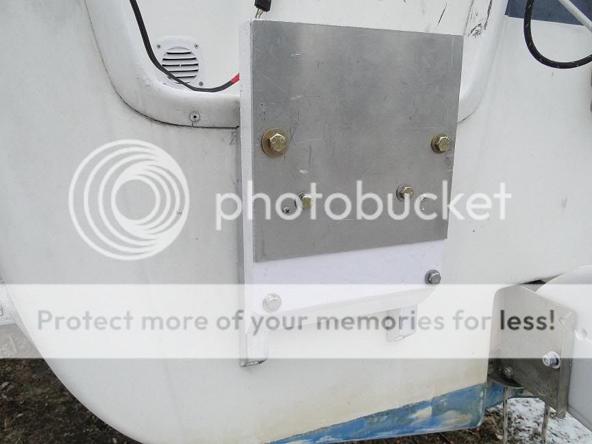

I put on a extra long shaft Nissan 9.8 on my 26S but moved it up 2.5 inches and back 2 inches so that it would fully rotate. The resulting 2.5 inches deeper than the standard long shaft makes a noticable difference in the prop not comming out of the water. This has worked great for three seasons now.

Correct. That motor (newer 9.8 Nissan or Tohatsuu 4stk) wont fully rotate on the 26 classic transom. This is important to some, not so important to others but I like it to rotate.
Long shaft is 20 inches, Extra long shaft is 25 inches which would be 5 inches deeper on the stock transom but I raised the transom by 2.5 inches to get the rotation. So with the Xlong shaft, Im still 2.5 inch deeper than the long shaft which solved the main problem I had of the prop caviting when I was motor sailing (happens on one tack only).
I had some initial issues with the idle jet being clogged up (probably some tiny object left over from manufacturing) so I replaced the jets and the motor has run great since then.
