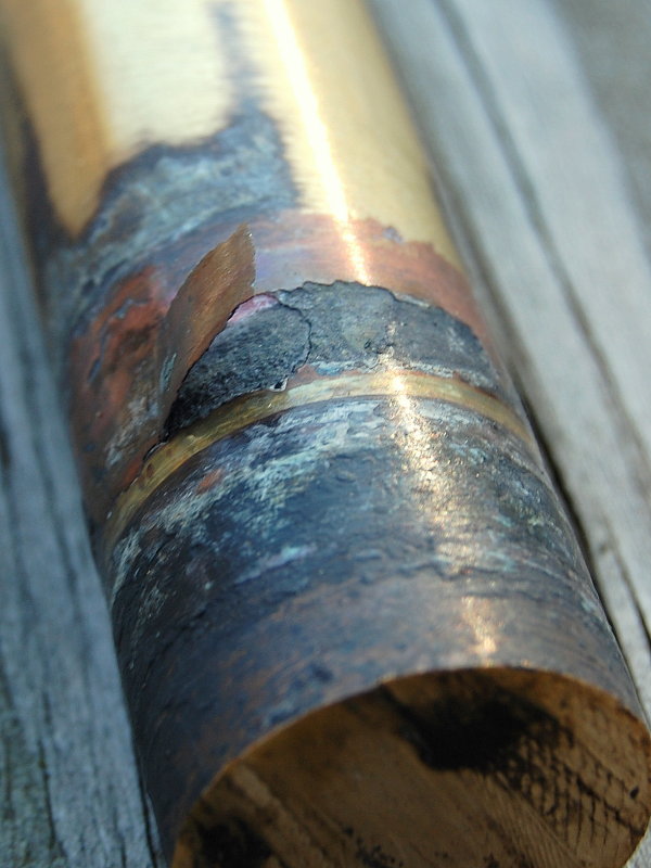

I am no materials guy but some shafting are true bronze alloys, some are more like a soup of metals, the proportions of elements vary.
Many materials use the term bronze in their name but they are not really bronze which has a very high copper content. Bronze parts go under historical names like Monel, Tobin bronze, Mangnese bronze, Naval bronze, Aluminum bronze, what some of call 85 5 5 5 bronze etc.
As to bronze shafting - garden variety shaft materials typically have a relatively high zinc content. That means they are more brass than bronze. If so this is not good in the presence of graphite and especially graphite impregnated (traditional compression) packing like Gore GFO, Western GTU, Duramax UltraX.
So the short answer is avoid bronzes and carbon (graphite) in contact and submerged in water because you have no idea what the shafting is made from. If you know what the shafting is made from - contact the shaft manufacturer and ask.
Here is a picture of traditional graphite packing damage that Maine Sail published. This damage was reported to have occurred over a pretty short time span. http://forums.sailboatowners.com/index.php?threads/stuffing-box-packing.159570/&highlight=bronze shaft damage
