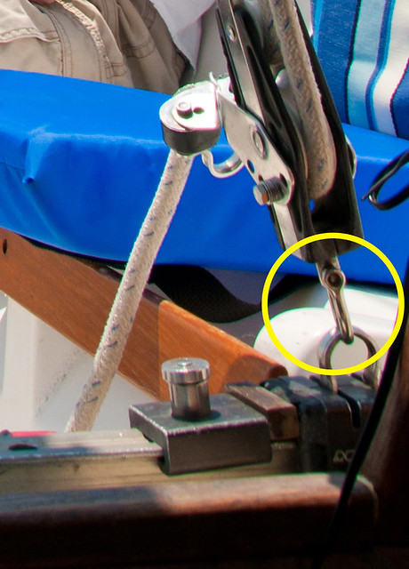

During the 2011 season I managed to destroy the Shackle on my main sheet traveler during a gybe. It bent into almost a straight line and the pin threads are all mangled. I've had a REALLY hard time trying to locate a proper replacement. Does anybody know exactly what shackle is supposed to be used on the traveler? I've tried two different ones so far without success. I finished the season by using a blow torch to bend the original one back into some semblence of a U shape, but it doesn't stay put as the pins threads are blown out.
The first replacement I picked up at West Marine bent the first time I was out (It was the only one I could find at West that would fit but the breaking load wasn't very high on it). The second one I bought online but the pin is SLIGHTLY too big to fit through the block hole. The specs on that one are: WICHARD Captive Pin Bow Shackle, 3/16" Pin Dia., 13/32" Inside Width, 29/32" Inside Length, 3310lb. Breaking Load.
So what do I need!?

That is a Schaeffer block. You could inquire with them for deminsions but better yet, here is what I do. Measure the hole which the schakle is inserted in, the distance of the hole and the distance from the hole to the bottom of the pin and then look for your shackle.

Thanks guys. The only problem with measuring it myself is that my boat is wrapped for the winter. :)
I'll either have to wait till April when I unwrap the boat or figure out the dimensions somewhere online, I'll investigate that block and see if I can find some info on it. I should have measured it carefully before the boat was wrapped. :(

Oh, also, besides the dimensions, anybody have a clue what breaking load I should be looking for? The first Shackle I got at West fit the hole, but it bent the first time I went out in 15 knots. It seems there are cheap shackles that have 900-1500 lb breaking loads and then expensive shackles that are 2000 lbs up to 10,000 lbs in the size range I need.

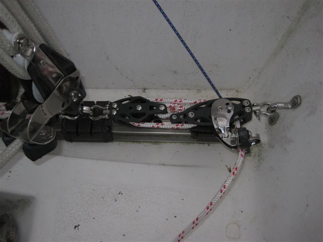

Post some pictures please! I need visual reference for this mod!
Here's a picture of my traveler setup.
The extra mechanical advantage is nice on windy days. A vast improvement over dumping the main.
(I left the old stops in place, they are under the right side block, simple!)
