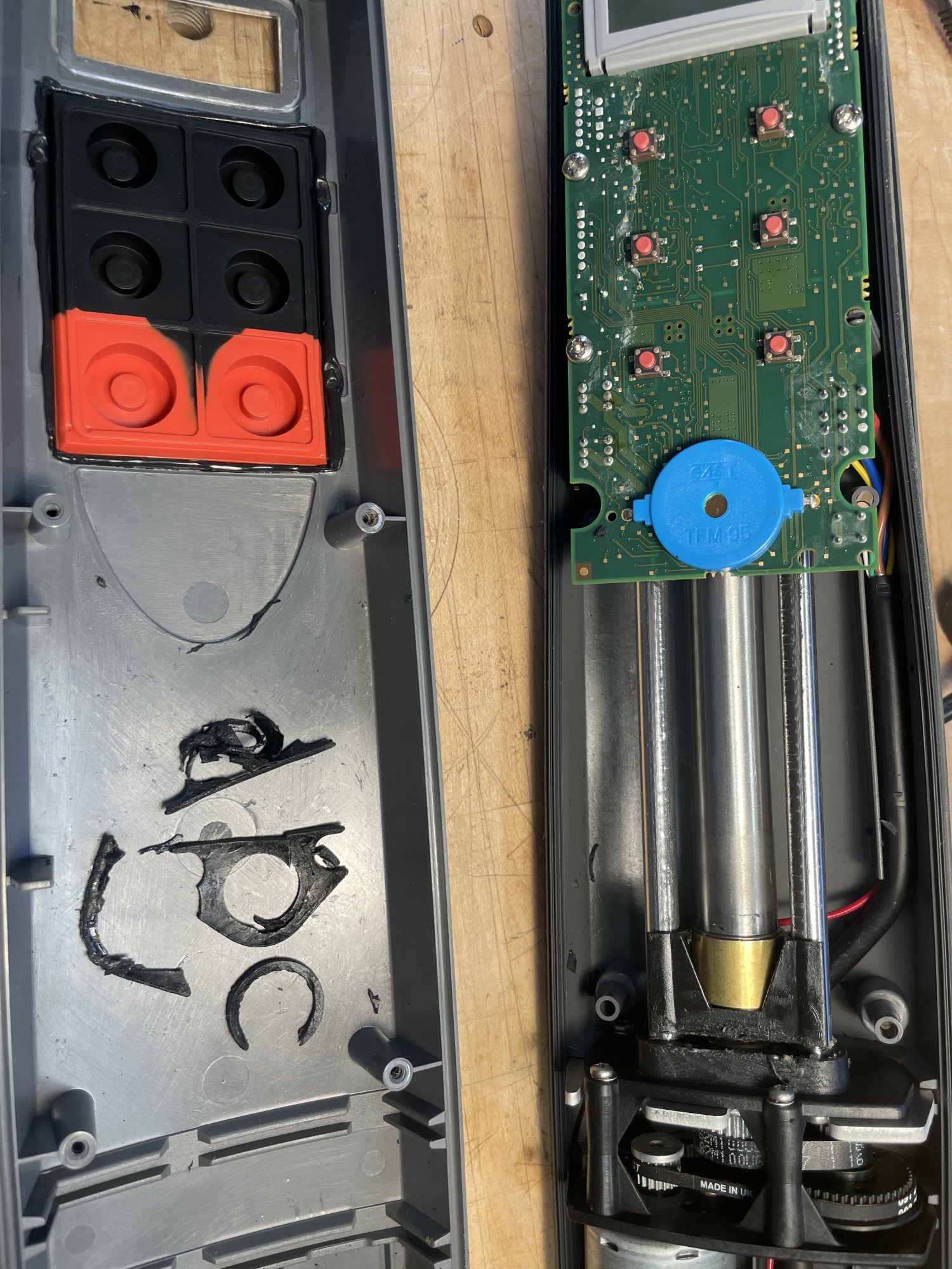

Lots of water under the keel since this thread ended. I finally opened the old st2000, and this is what I found:
No teeth missing on the belts, but all the pieces of plastic/rubber chewed up and spit out by the machine. I’ve written to RayMarine’s American support for advice. Any thoughts or advice?

"Linear Actuator"". Doesn't look too bad, nothing a couple hours in Tinkercad and an hour in a printer wouldn't fix.

Hi PSR.
In your first post you mentioned a distressing noise.
Would this be it?
My original repair was a piece of 5 mm (1/4 inch) wetsuit neoprene to replace the flimsy piece of chewed up plastic washer.
It solved the cushioning problem but the noise (and rattle) remained.
I found that the plastic bearing housing that prevents the bearing from moving forward with the drive rod had a small ( i mean really under-engineered small) lip that had disintegrated.
That was amongst the pieces floating around inside the case.
Luckily there is a 1mm groove in the drive rod and ifyou make up a simple aluminum washer that slips into the groove you can lock the bearing in place.
I made one from scratch. Draw a circle on a piece of ali. Drilled a hole. Cut out the ali with a hacksaw. Cut the slot. File round and file thickness.
It is about a 1 hour job.
materials.
a small piece of 2mm aluminum. a little larger than a dime.
A 6 mm drill
a hacksaw
a small file.
This is not a good video as I was trying a head mounted camera for the first (and last time)
But it will give you a basic guide.
