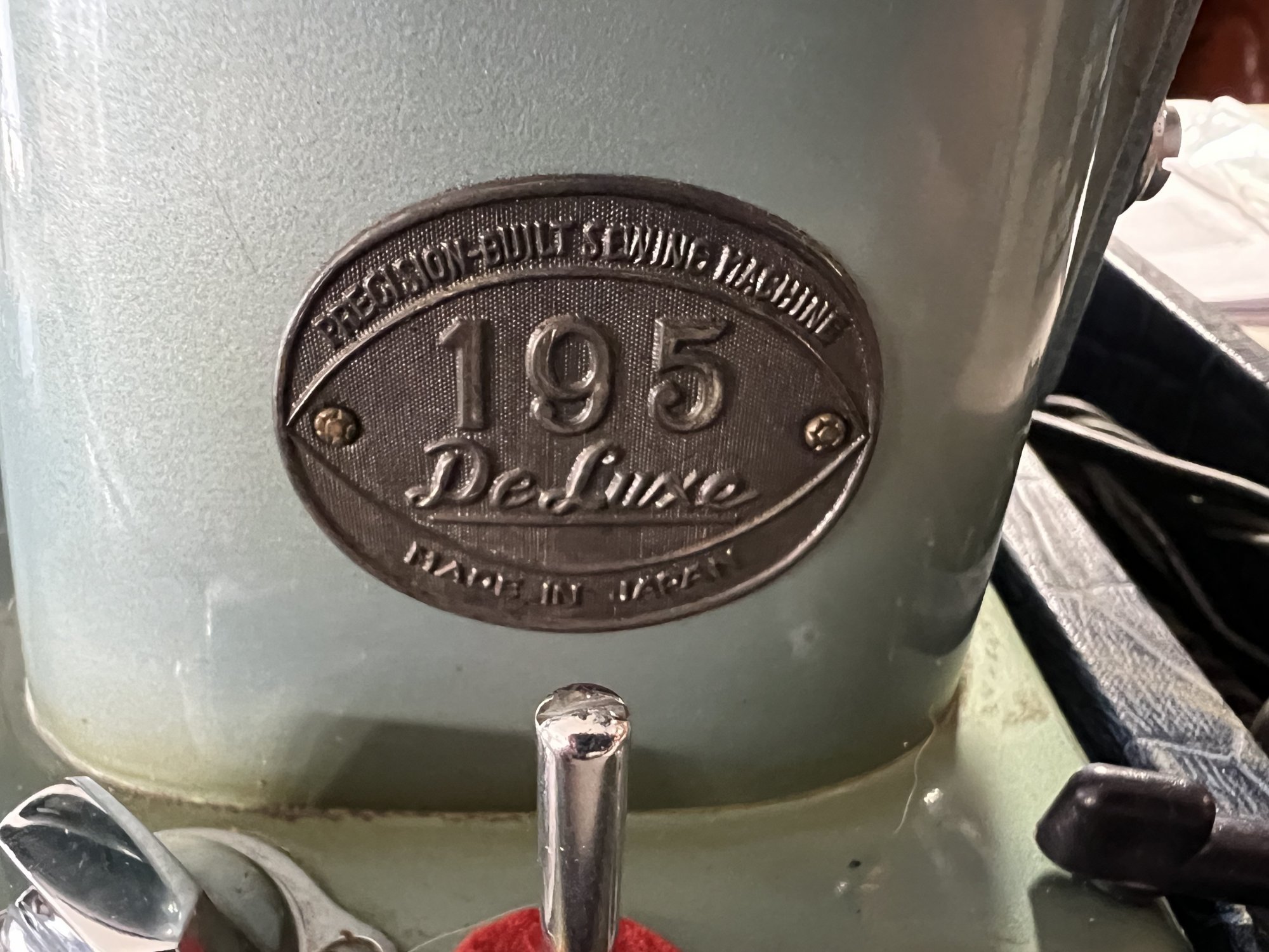

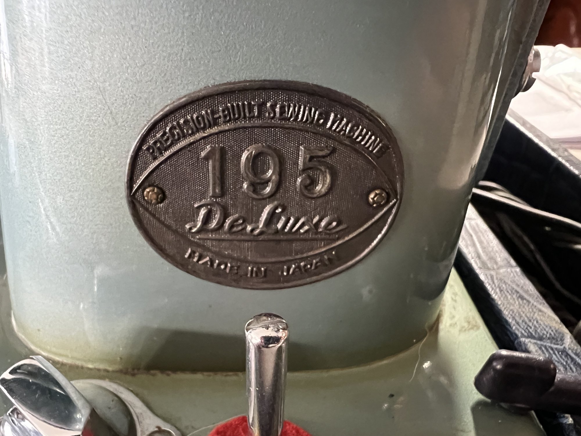

I have one that looks just like that but in blue paint and different branding. Mine is a Japanese post war machine but based on that Singer.
I haven't tried canvas with it but I don't doubt it. My problem was speed control but then that could have been just my lack of sewing skill.

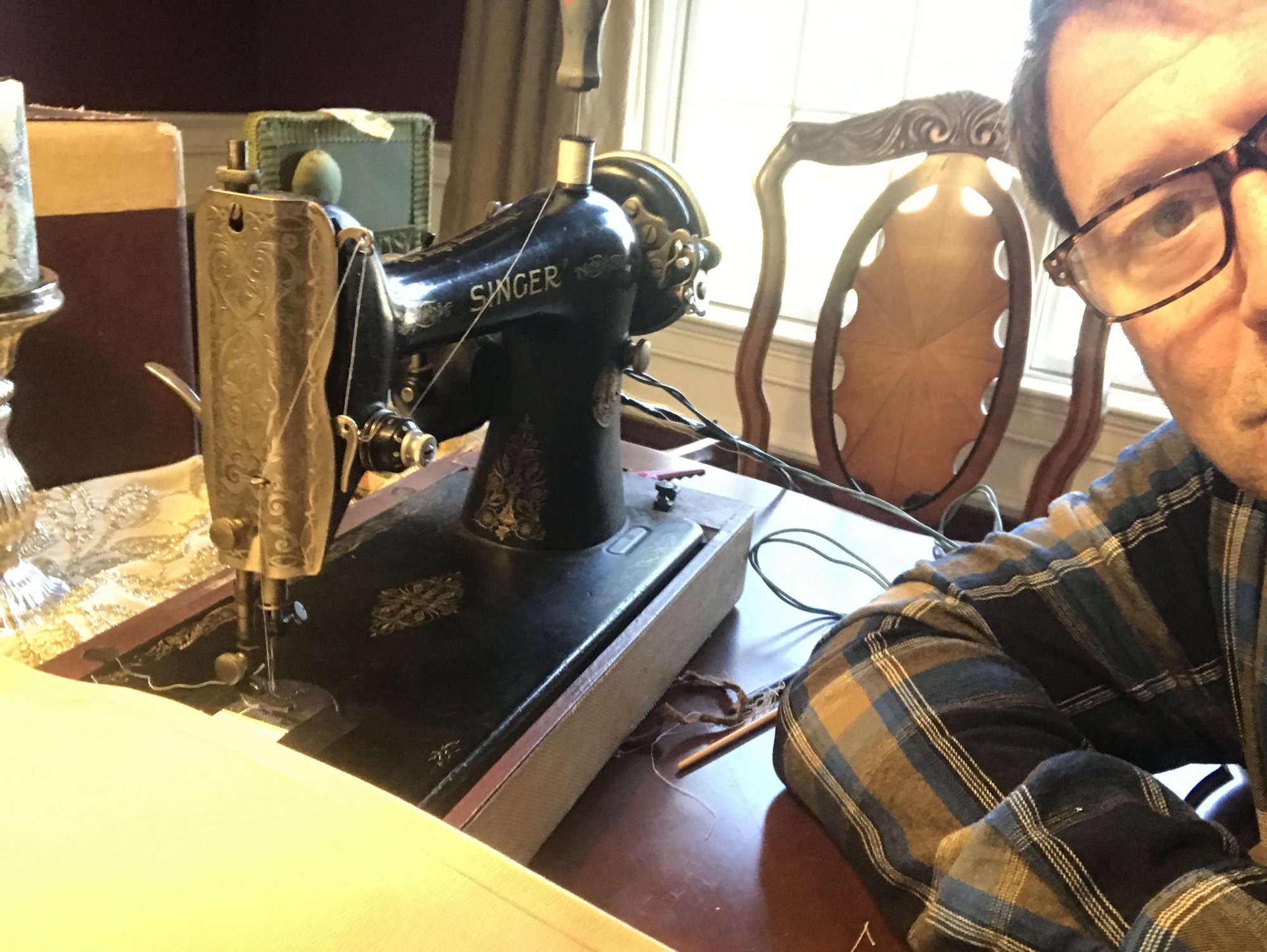

Old Singers are great machines! My mom's 1951 model is very strong. I currently have the walking foot machine in that cabinet, fits perfectly!
