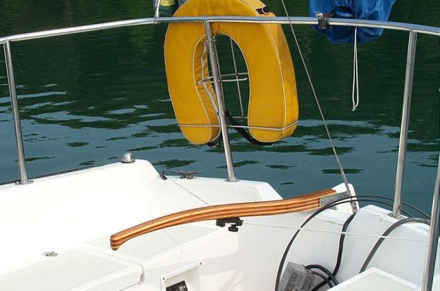

I bought one off Rudy years ago with a mild curve, and it has two stainless plates that fit over the rudder head on my boat. The reason I bought the mild curve is so I could mount the pin for my Autohelm ST 1000+ auto pilot on top of the till. Otherwise, I would have needed to buy a special bracket for the pin that mounts under the tiller. Because of the fact that this tiller is wider than the stock tiller that came with my boat, I needed to make more room for it on the rudder head by lowering my pintles on the the rudder head to the bottom holes and drilling new bottom holes on the head. It all worked out great on my boat. I use my autopilot about 98% of the time.

http://www.drmarine.com/ On my 1986 O'Day 222 tip up rudder, I needed to lower the pintles down to the bottom hole, and drill a new bottom hole for both pintles. This raised the rudder head high enough to make room for the tiller plates and to be able to use the same hole for the tiller bolt. I also installed two stops on the rudder head to keep the tiller from hitting the top of the transom. The stops are nothing but Aluminum storm door "L" shaped brackets that can be bought in any hardware store. I drilled a small hole in the top of each one and tapped it for threads for the screws to hold small pieces of Starboard for the tiller plates to rest on. Raising the rudder head provided the space needed to mount this heavy duty tiller and still provide the space under the tiller for the small diameter rudder hold down pendant line. I also installed a rudder blade hold up pendant line with a fair lead on the rudder head, and a self rescue clam cleat on top of the tiller. The leather is a chafe guard for when I tie my till off.
