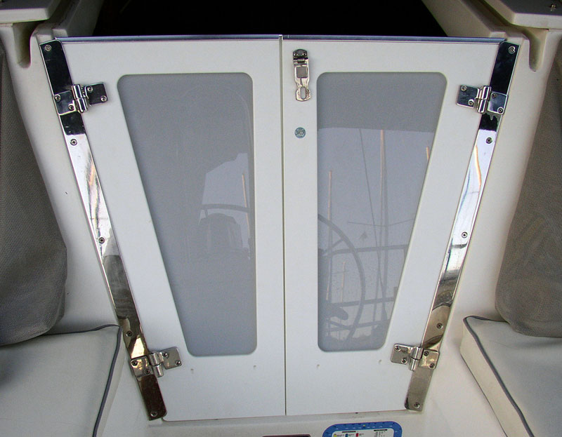

We 2nd Zarcor. I just installed them on our Beneteau 423. What a pleasure not messing with the hatch boards. We wish we did it 2 years ago when we bought the boat. They should have the template for your boat so the installation will be easy.
Likes: pumpkinpie
Apr 11, 2010
998
Hunter 38 Whitehall MI
Yup on Zarcor. Purchased them right after we bought the boat.
Absolutely love them. Installation was easy and the CD they sent helped.
Have had them 10 years now.
And yes they have the template for the Hunter 38. They already had it when I ordered mine.
We bought with the smoked glass and screens and love how you can easily change them

If you bought both smoked glass and screens, it’s helpful to write port and starboard at the top of each piece so you don’t wind up sliding them in and out trying to figure which piece goes where.

Doors arrived this past week and we will start to install over the next few days. I'll be sure to post some pictures up!
good luck
I found installation quite easy and the instructions very thorough. I did have to play with the locking mechanism a bit because it required a slightly longer piece and a little custom bending to get it to engage the keeper on the sliding hatch. Not difficult just some tweaking.

Except with my Zarcor doors I can still slide my hatch boards in for extra security. This may not be true for all installations but it is for me. And when my doors are open they interfere with nothing.

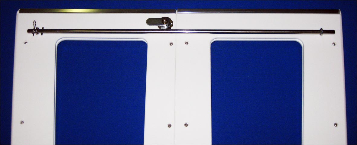

So I gathered the necessary items together to install the doors and just realized the doors cannot be locked from the inside. I have a wife and 4 year old, and she’s a bit freaked out that someone could sneak on the boat in the middle of the night anchored out somewhere with no warning. Has anyone else had an issue with this or know how to rectify the problem?
I installed a barrel bolt on the inside up top. You could also put another barrel bolt at the bottom.

What about something like this?
I have a couple of these that lock some sliding panels on my boat, just replaced one that was broken and the chrome and metal quality was pretty good to my eyes. Not a panic room protection but should slow anyone down enough.
same here. Hatch boards slide behind the doors. And the doors have two piece hinges so doors can be lifted off and stowed when not needed.
there are numerous ways to install a locking mechanism inside. The one Zarcor sells is one option.
