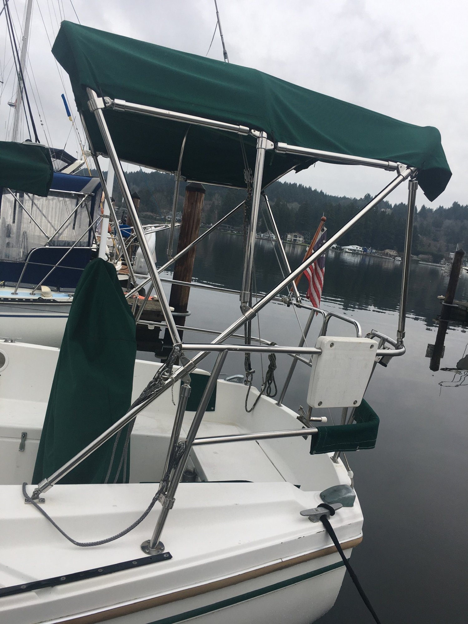

Obstructions/limitations at aft end: here’s a photo of the pushpit, with its built-in drop-down stern ladder.

You have got to be kidding ?
You're going to mount an 8-10 ft. rigid, heavy, dinghy in that jungle Jim of steel tubing ? And without a sugar scoop transom to stand on ?
Stick with towing the dinghy and then wash and store when it's not being used. Waaaaaaaaaaaay easier.

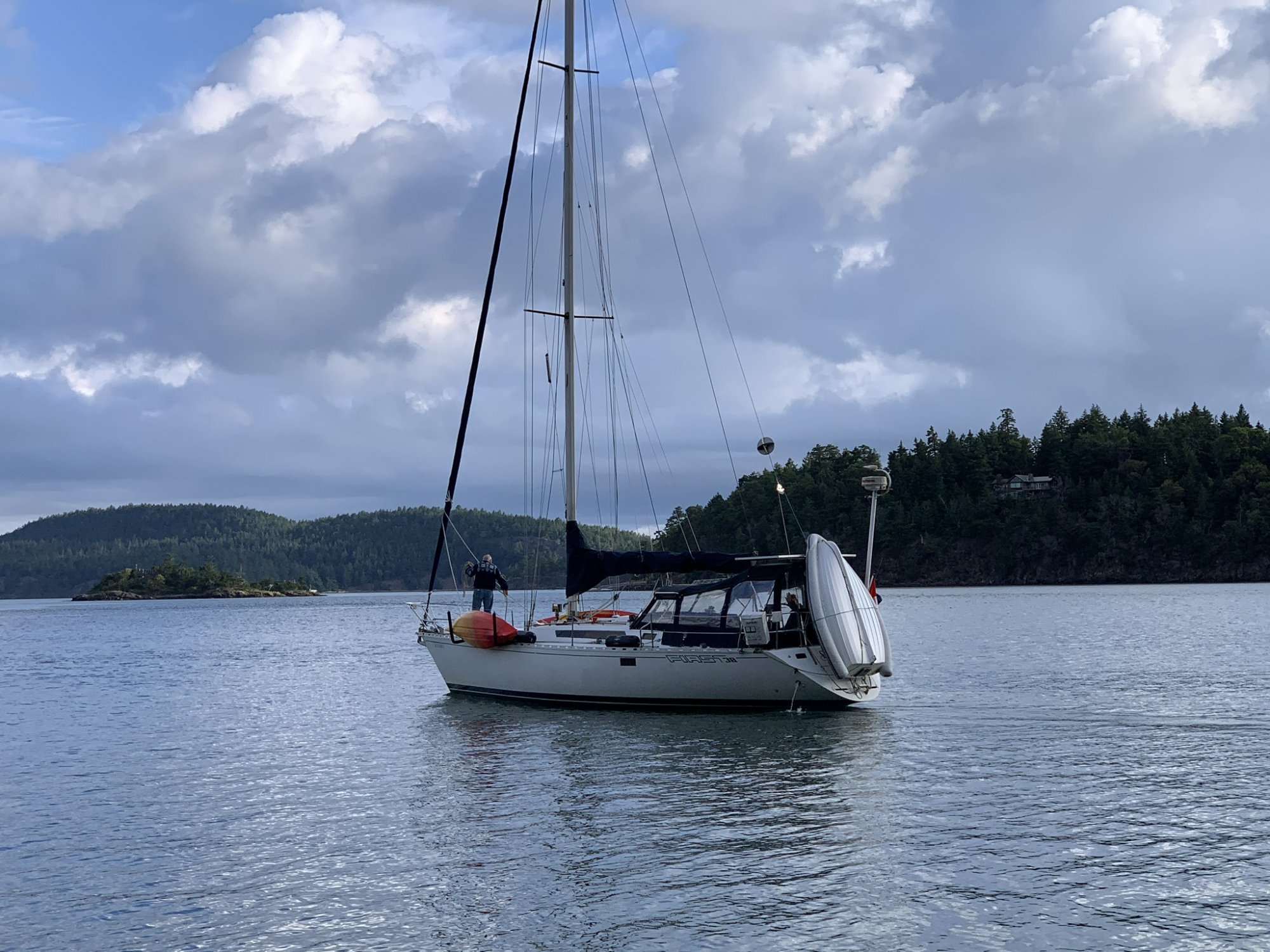

Jan 5, 2017
2,465
39816F89-1747-4802-B4E9-E973E3C48AEE.jpeg Started carrying mine like this last year. We’ve done about a thousand miles so far and it seems to work well. It’s out of the way and easy to deploy and no drag.
