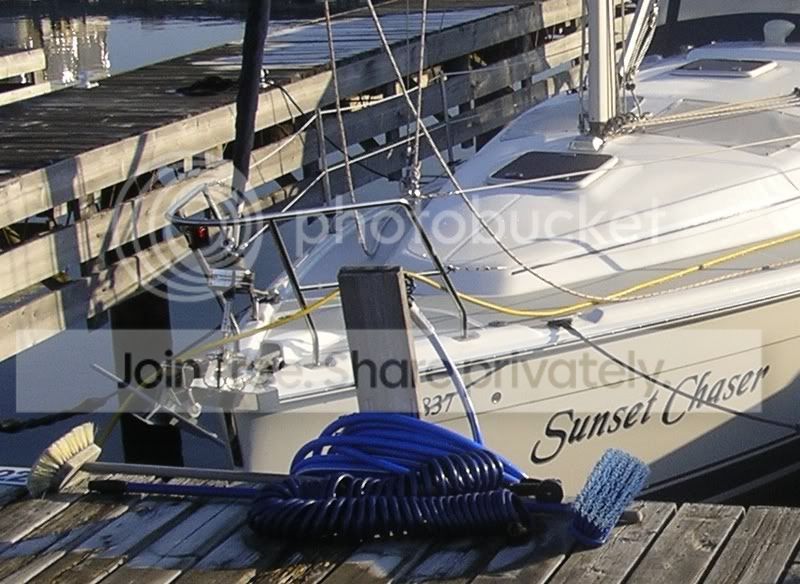

If the wind kicks up, there's no reason you can't simply reach over and grab the anchor rode outside the pulpit and lead it back to the cleat (which seems to be a bit further aft than usual, and may contribute to "sailing" around the anchor, but that's another story). You could even rig a bridle from both bow cleats and run it to the anchor rode again outside the pulpit. Ya just have to stop thinking about the bitter end of the anchor rode, currently in the locker, from being the operative point. The anchor rode still goes thru the roller, but you've "captured" it further up closer to the anchor so what's coming thru the roller is "limp." You do have bits and pieces of spare lengths of line on the boat, right? I have so many I'm thinking of starting an inventory.:doh:

Stu, gots lots of bits on hand. I think I've got it. If I ran it to one bow cleat I'd be at a fair angle to the wind, but a bridle would work.

Maybe I'm misunderstanding Maine Sail. He has said not to run the rode through the anchor roller. I was trying to picture how to get the rode off the roller.
I have a cleat in the anchor locker that I use, which is just behind the "hump" in the lid to the locker.

Yes a roller should not be used in anything but benign conditions. Do I use mine? Yes but only when I know it will be calm or below 25 knots. They are for transportation launching and some retrieval. The design loads are not ones that will handle storms or waves well. That pictured roller is a Windline BRM-3 off a very pricey Nordic Tug. It is a robustly built roller but the boat went beam to in heavy seas and when she snapped straight on her rode it simply collapsed the roller in one single motion..
To re-route your rode simply reach in front of the roller and pull the rode back to the cleat. I'll dig through my photos and see if I can find one. I couldn't see any cleats in your photo. Sorry for being so shocked but it looked as if you had no bow cleats...:confused:;)
I had to crop and do a little MS paint but the rode passe through the hooped roller, if that is what you have, then to the bow cleat but with a but of a sag or slack in it..
Stu's roller, unless he changed it, is not one that sticks out beyond the bow chock and is integral to the stem head. Even on my C-36 I still never used this roller in rough conditions for fear of tweaking the stem head fitting. The ones that stick out like added appendages should not be used to lay to in windy conditions but ones like Stu's are more robust....

Makes sense now. I couldn't picture grabbing the rode from the front of the bow and running it back to the cleat.
Mine's not a single roller like the damaged one in your pic, but all part of a larger fitting. There's an open loop on the port side of the roller, not sure if this would be used to take the rode off the roller. The bow cleats are a fair ways back so unless rigged to a bridle would pull the boat askew. This was taken before I replaced the ugly Danforth.
