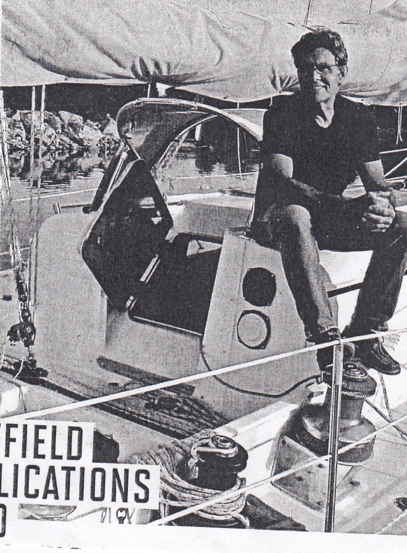

Here is a hatch conversion which can take a rollover without leaking a drop.If it went all the way from a bottom to the top of the original opening, it would be just as big an opening as the original "sliding hatch and drop board" foolishness, which round the world racers have abandoned long ago.
A cupola on top would make it bigger and easier to use than the sliding hatch, by a wide margin.
Somewhere, I have a picture of around the world racers with waist deep , solid water in the cockpit, burying the main hatch. No way would a drop board or doors survive that, or keep water out .
I have read of a 34 footer in the N Atlantic having a wave smash in the drop board, and sinking the boat quickly.
If the lock is inside reached thru the vent ,it would also be extremely resistant to burglers.
