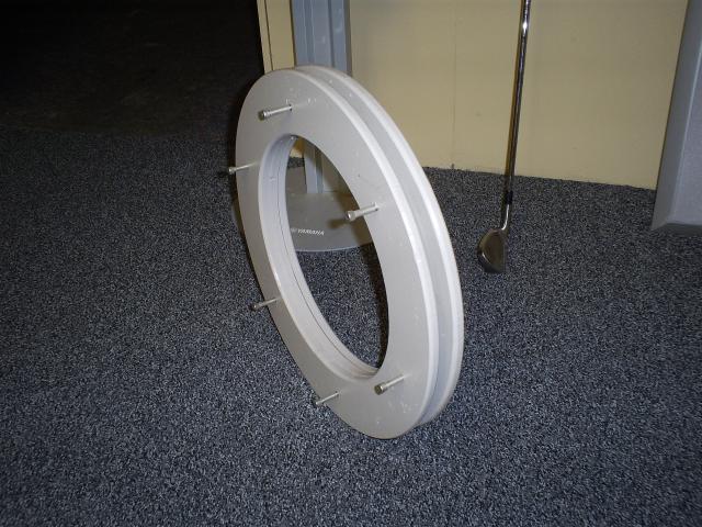

I am going to try the jib sheet to wheel self steering, and a spool for the wheel is required for that. So I built this one. I have to install the profurl c320 I just bought first. I have no furler or any way to raise a headsail yet.
I was wondering what it would take to build a windvane. There is no doubt I could build one, there is much doubt whether it would work correctly though.
A much more economical and practical solution at this stage, but are you saying you have no jib halyards? That should be your first priority. You can't sail without it.

I saw that design on youtube, while trying to figure out how windvanes work. I will subscribe and check that out to see how he did it.
I was wondering how many turns my wheel takes. On the spool I made, I get 1.25 turns in either direction. The effective diameter of the spool is 14.25". Most self steering systems must generate ALOT of force because their wheel spools are like 6" OD. Also they appear to get 2 or 3 turns in either direction. I wouldn't think a self steering system would need that many turns. While they are working they seems to only need 5 or 10 degrees.

I tried to pull the wheel off to bring it back to the shop to mount the spool perfectly concentric, but the wheel requires a puller t pop it off of the taper.
