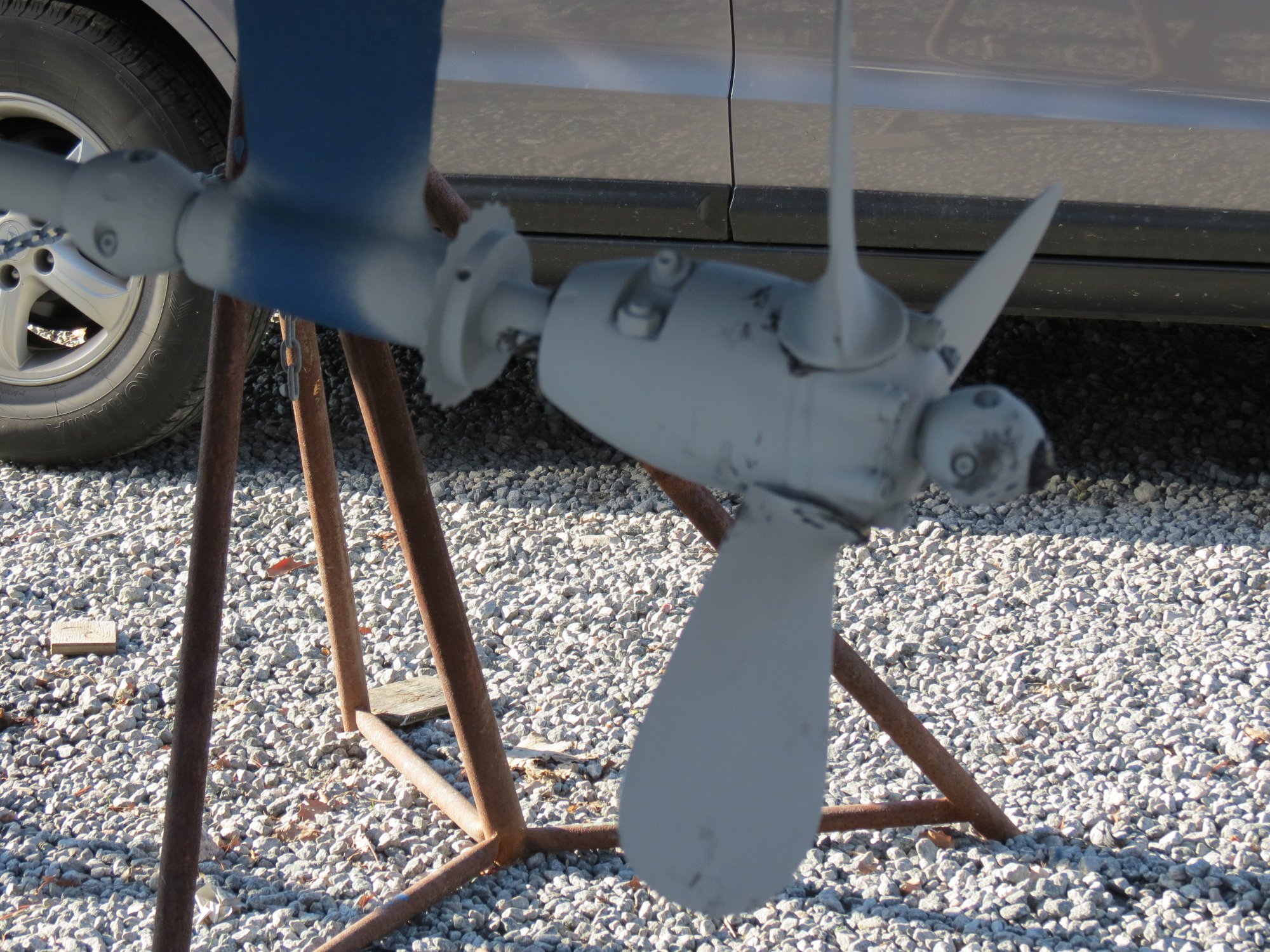

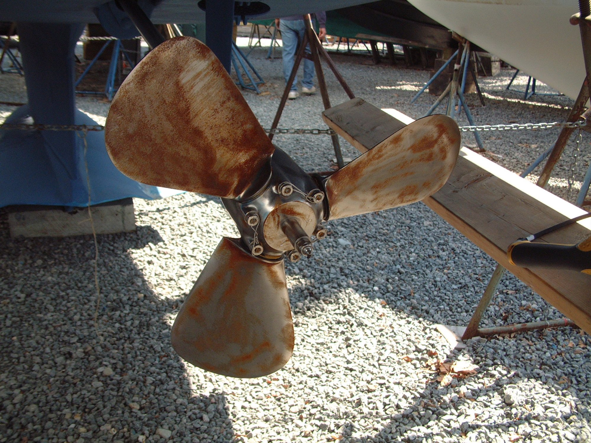

I purchased one of the S1 3-blade feathering props in 1999, and I grease it yearly and change the zinc as required. I did change the O-rings once about 10-15 years ago. My blades turn smoothly and quietly. Servicing it has never been on my radar. The prop has been used for about 3000 hours.
I did design a stainless hub that bolts to the tip of the blade that allows me to use an $8 standard 3/4" shaft zinc instead of the special design $35 unit sold by Martec.

Yes. I machined a stainless rod and drilled to fit like the OEM zinc. A standard 3/4" zinc fits onto this sleeve. Easily made if you have stainless stock and a lathe. You can see it in my pictures in post #3 above.
