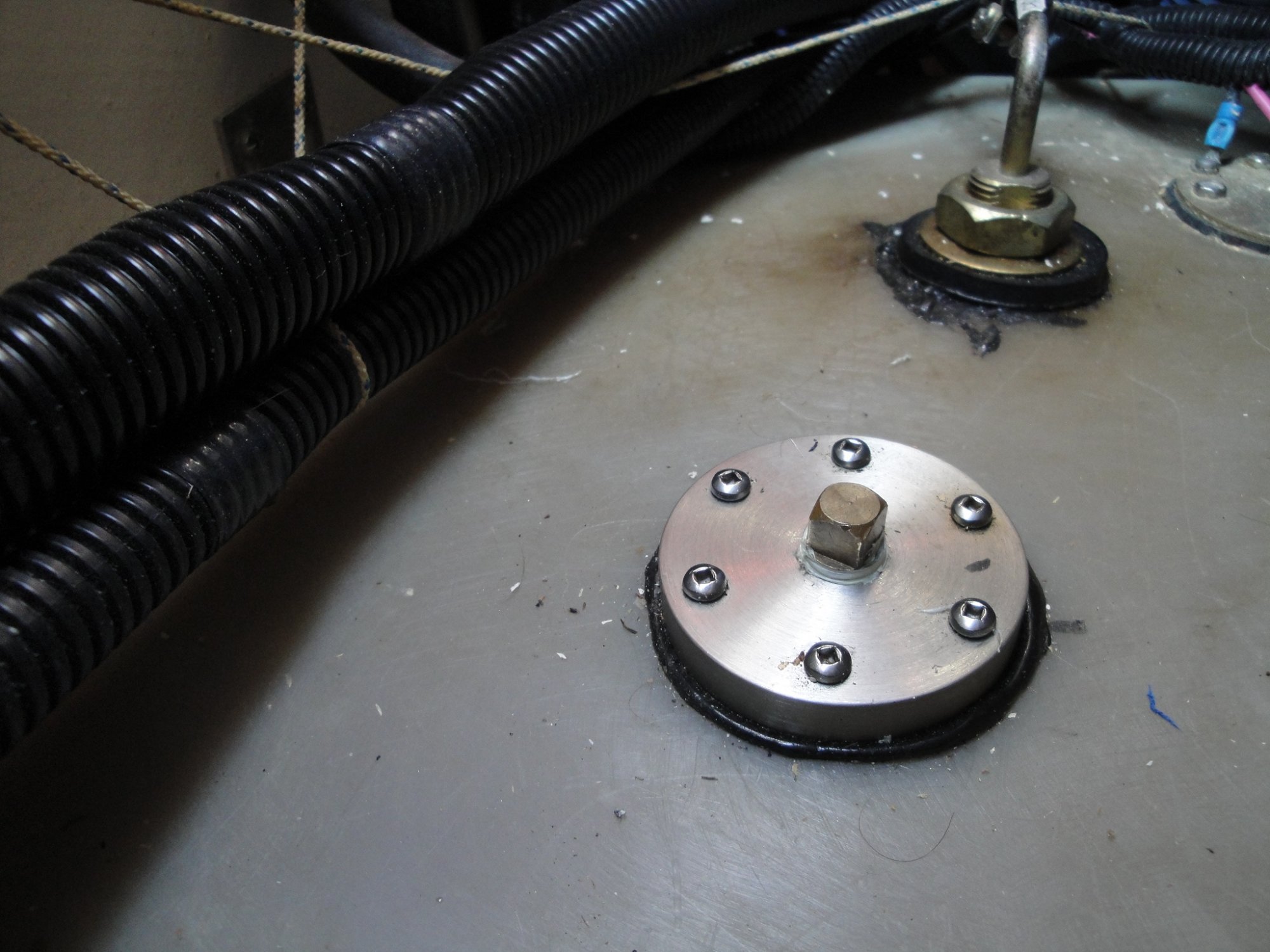

1) I've ordered a replacement gasket from Catalina Direct but it will take a few days to get here.
Do yourself a huge favor and DO NOT use a gasket under the flange. The last one developed a leak and you can be sure this one will soon have a leak as well. Nothing leaks like petroleum fuels.
Instead use Permatex #2 as a sealant WITHOUT a gasket. Ensure both faces (either plastic or metal) are as clean as possible before proceeding. Guaranteed for life.
