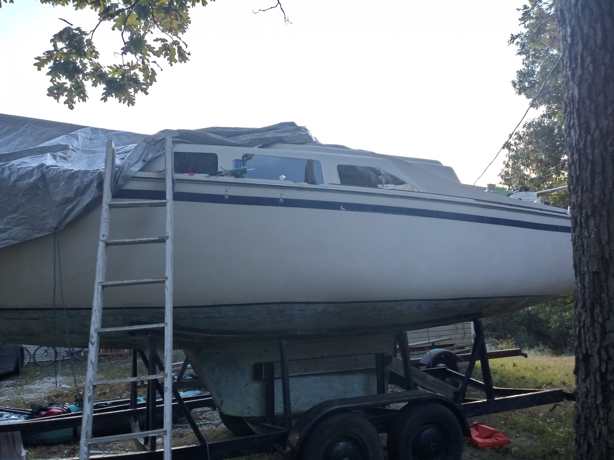

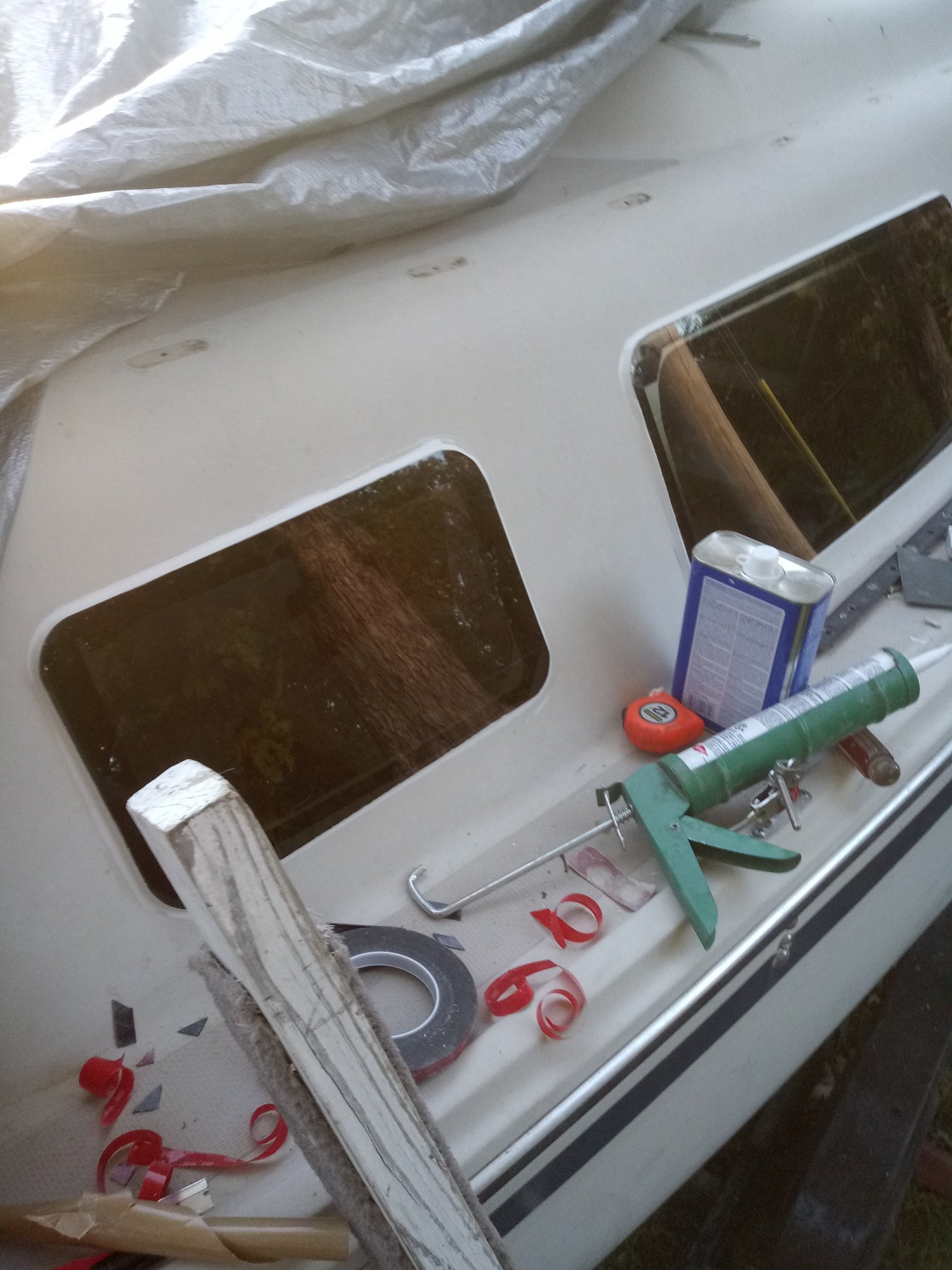

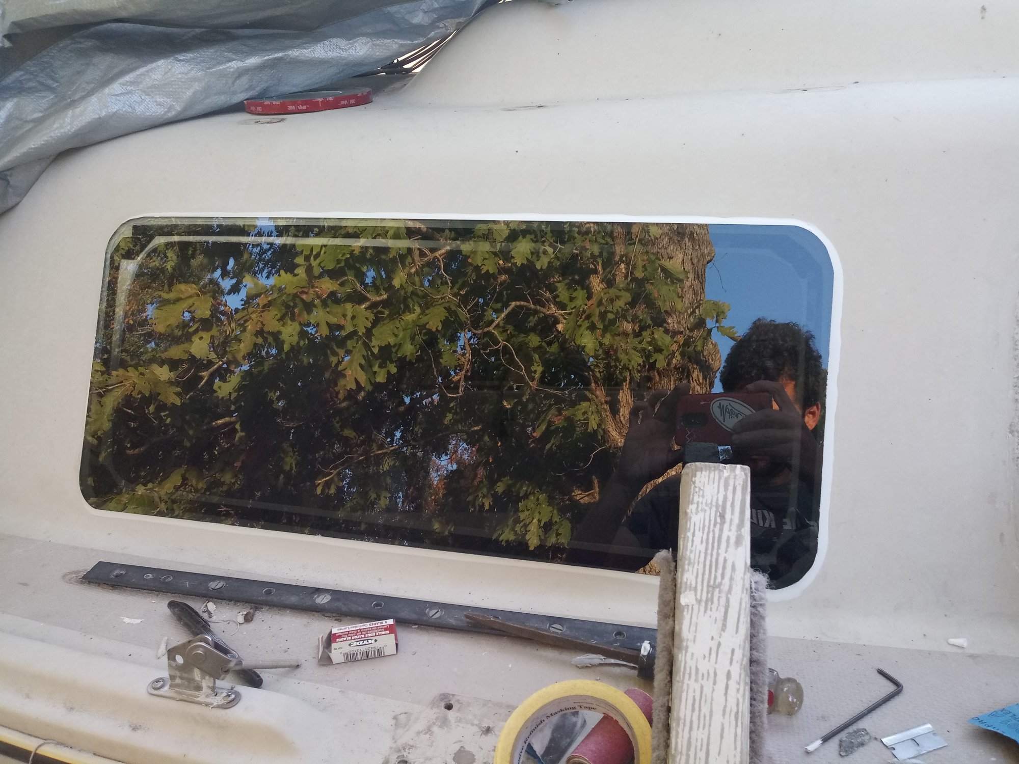

Finally had some free time and daylight to fiddle with my Laguna. 2 fixed windows installed. 3m vhb tape, dow 795. Windows are cast acrylic, not polycarbonate. I may paint the outer inch or so black so you can't see the vhb tape.
I felt it came out well for my first try.
