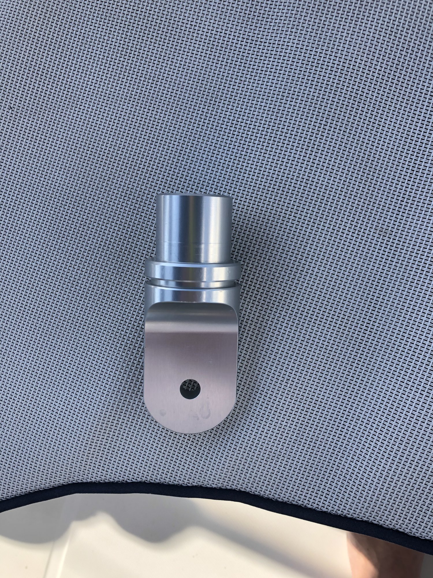

Ok so probably a very elementary question, however no real experience and would love some opinions. One of the parts in this springs project can attach either by a bolt all the way through with a nut on the other side or just a single self tapping bolt/ screw. This will be going into solid aluminum so relatively soft. Aesthetically I feel it would be better with just a self tapping bolt, however have never really worked with them. Is it as simple as predrilling and then screwing it in??

Never tapped before so was looking for simplest route. The part will be expoxied also...... load is just weight down. Leg will have this inserted......

I have no idea what that picture is or how it is used on the boat.
Will Gilmore properly suggest that if the thing you want to attach will move it will work the screw out. If it needs to be secure always follow Will’s recommendation.

That’s a good point. It is for the feet of an arch and it will also serve to hold my dinghy. Even though it will also be epoxied in place, maybe the through bolt is the way......
