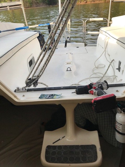

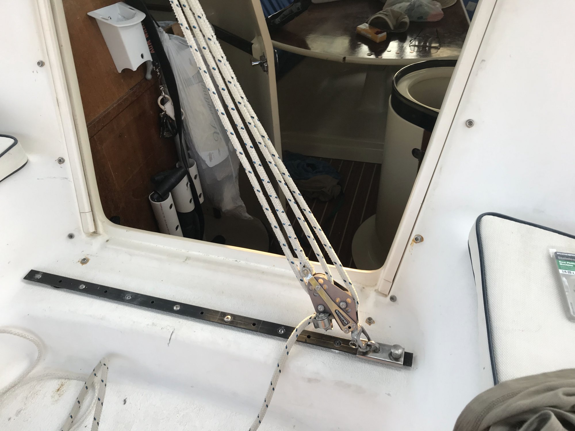

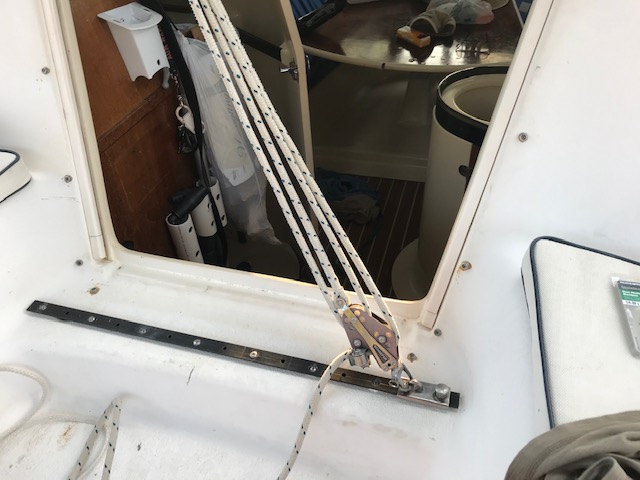

That looks nice and neat…did you move purchase point on boom forwards ?
I can post more pics of the install once I’m back on my computer.
I did not change the boom attachment. There was an aluminum plate in the bridge deck so I was able to tap and thread the bolts. The track is a piece of used Genoa track I got off of eBay.
I still have the second piece if you want it.

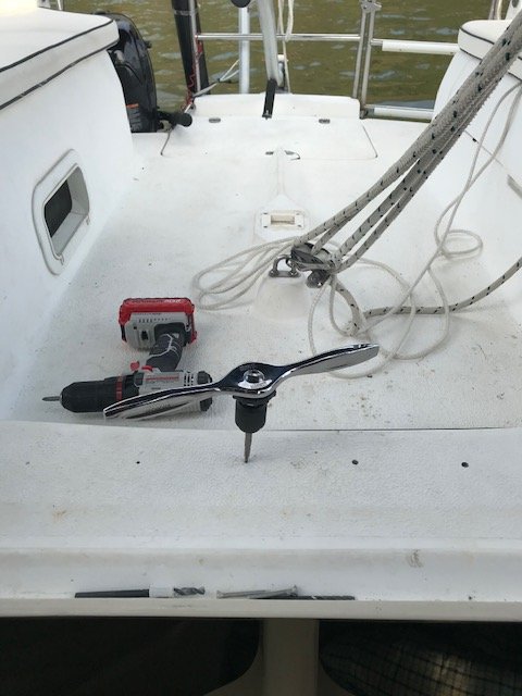

Yes I can
I’m on the road right now a d I need my computer to get to the pics. Give me a day
12,704
In this pic you can see five holes through bridge deck. The middle three are into the aluminum plate embedded in the deck. The outside two are not and are through bolted. When through bolting you need to do a small hole cut through the liner so that the nut and washer sit flush against the actual deck and not the headliner.
Dec 23, 2021
22
Hunter 260 Thornbury
View attachment 201297View attachment 201298View attachment 201299
Thank you ! So did you do any special backing plate on through bolted ?
12,704
Just an ss-washer. Years ago I purchased a box of 50 from McMaster-Carr and I still have a lot left over…so they get used for a lot of things:beer:
