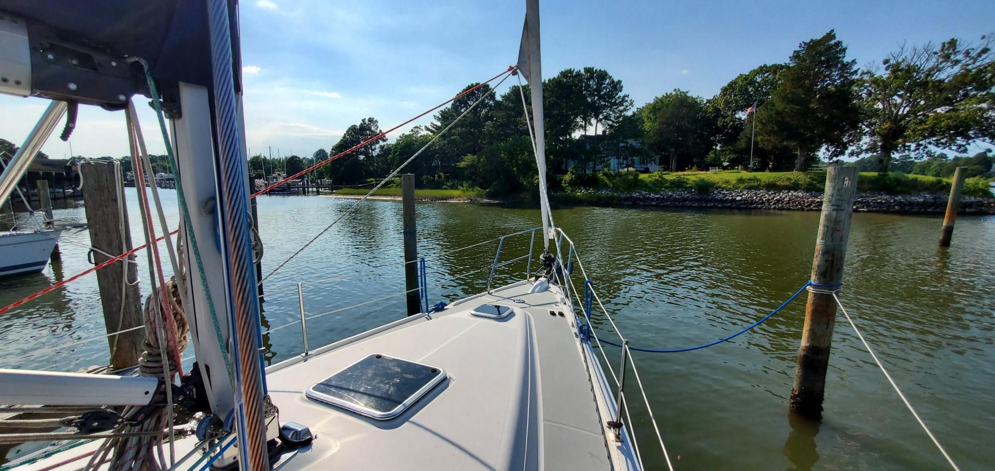

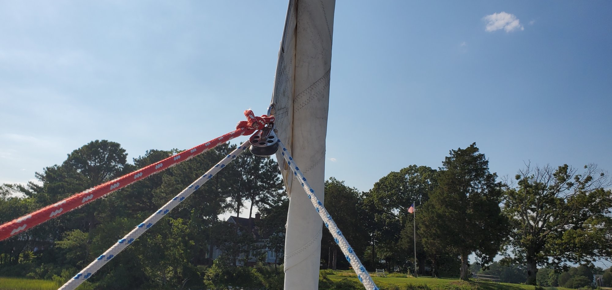

Here are some pics of how it is set up. The white with blue fleck sheet is an old halyard. The red sheet is a lazy sheet so I can heave to if I need to.

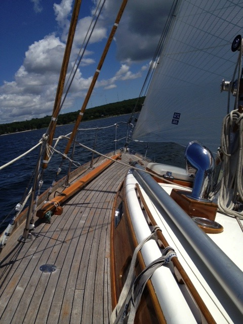

my self tacking jib, blowing 30 ish. photo from 2 miles away.
jib boom stowed on deck when not in use.
you can see the sheet track behind the forward hatch
hank on system
it's a great sail to have. have used many times over the years.
